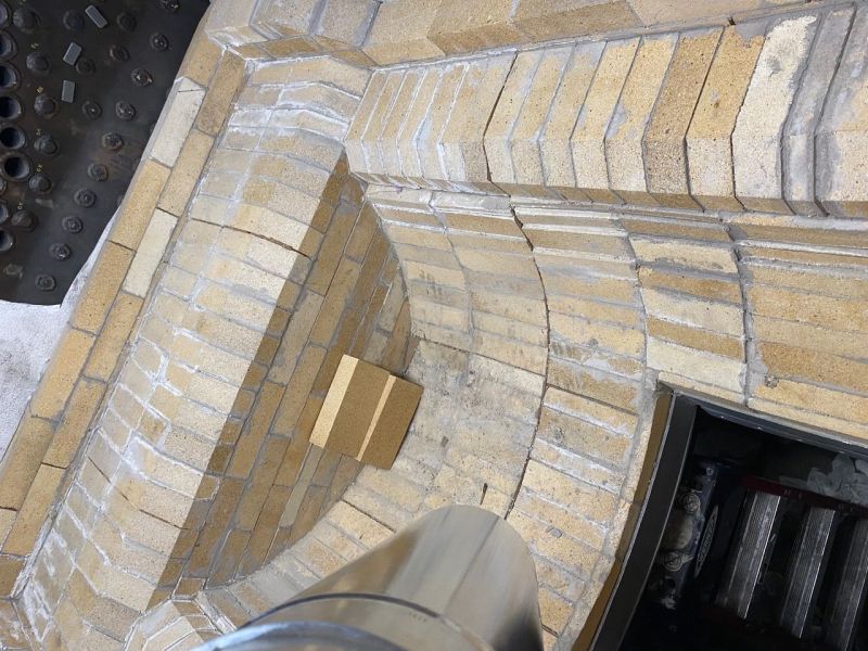

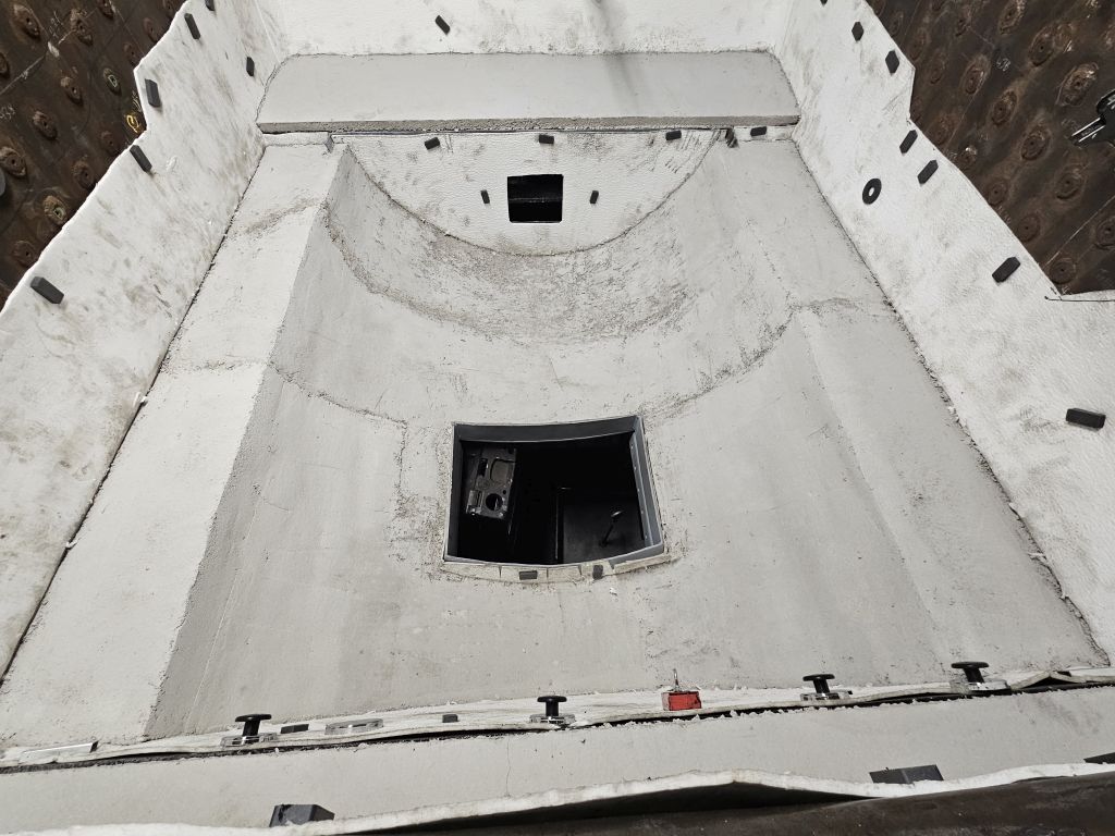

The firebrick lining for the firebox was finished a couple of weeks ago. The refractory lining comes next.

This is the photo I meant to attach. The other one is 3-4 weeks old.
This should have been covered by a castable refractory during today's work call.
Still having difficulty posting without getting logged out.

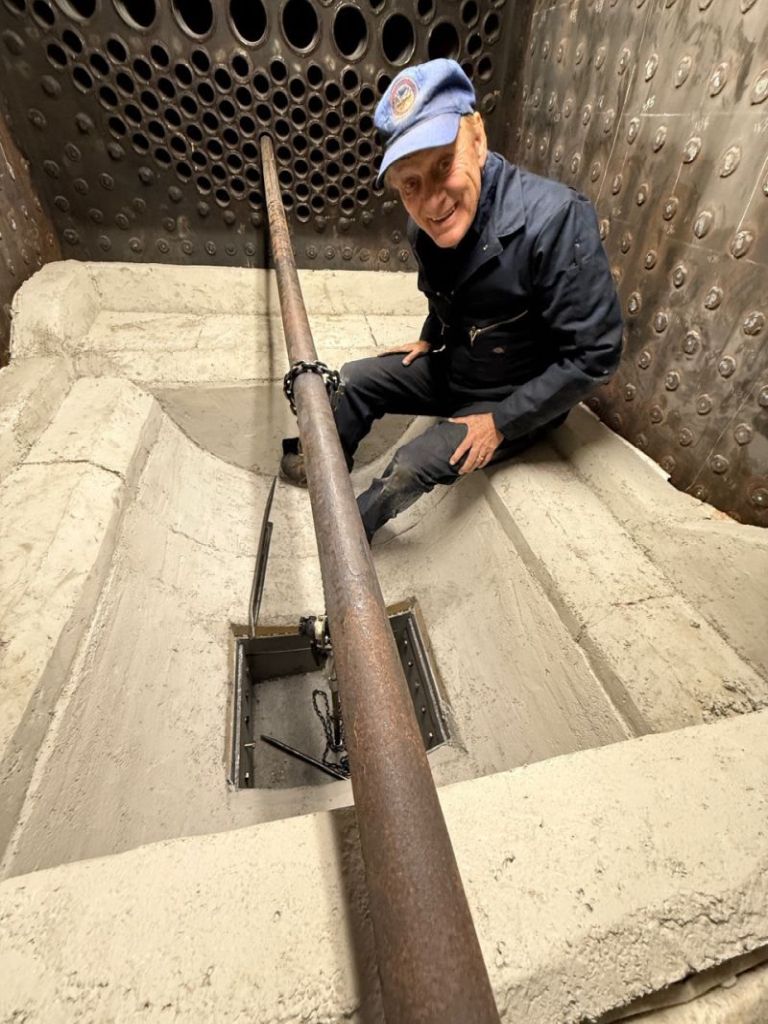

With the fire pan draft box installed, the firebox is now ready for a fire and the only exit is through the fire door.
When is the first firing? The best answer we have is *soon*.

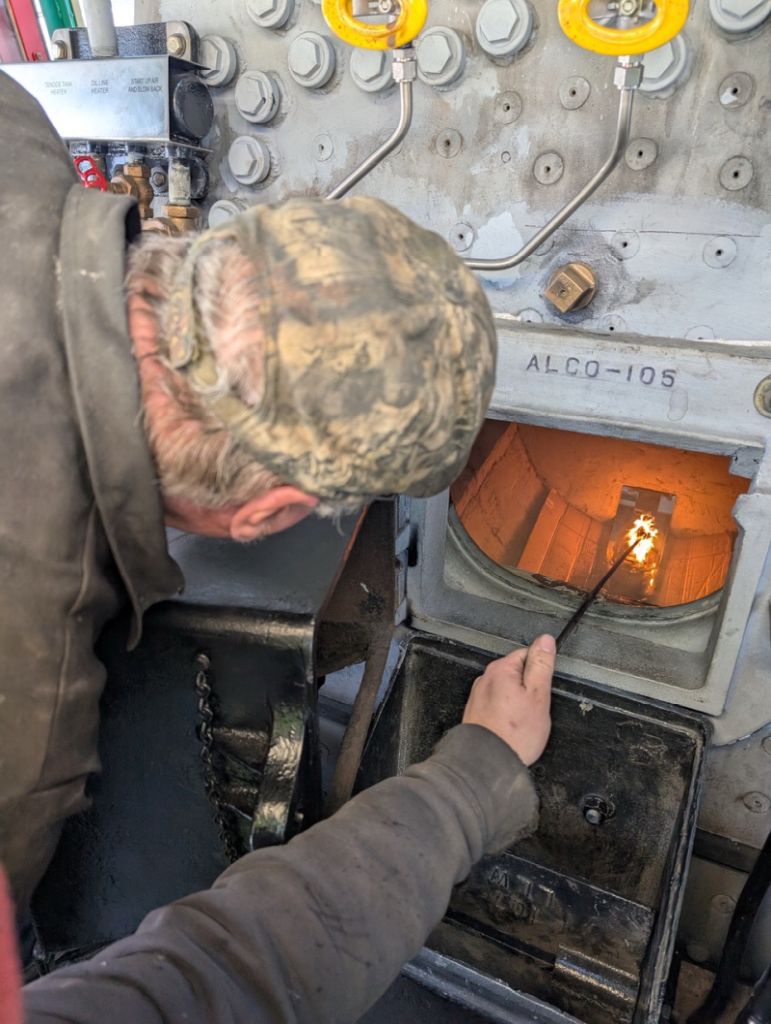

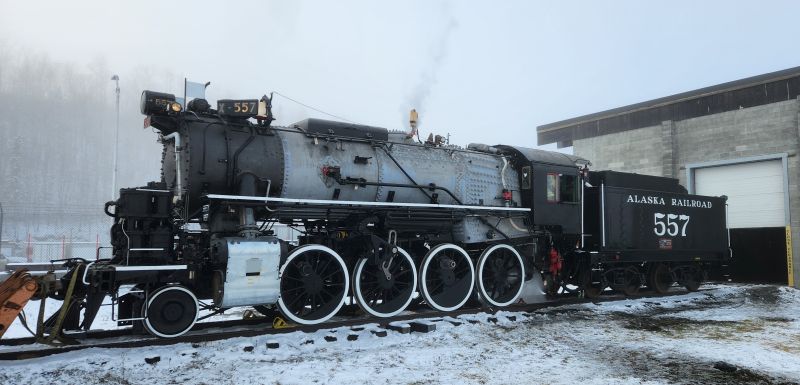

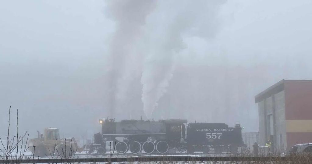

On November 8, 2025, a fire was lit in the boiler of Alaska Railroad #557 for the first time in over 50 years following an extensive 13 year overhaul of the locomotive. The old girl exceeded all of our expectations in this test to prepare for the official steam test of the locomotive. It was a clear, balmy 28 degree morning, followed by a foggy afternoon.
To see her in the fog and listen to the overhauled Nathan 5-chime, a gift for Larry Altoff of Pennsylvania, check our Facebook page, “557 Restoration Company.”

Jeff DeBroeck lights the fire in the rebuilt boiler for the first time in over 50 years.

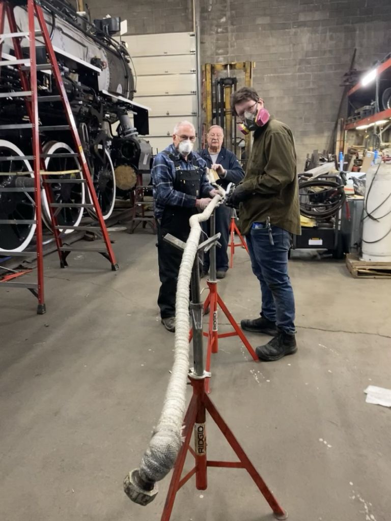

Steam fitting. The art of making straight pipe crooked. This steam pipe from the manifold to the generator will be buried in the lagging under the jacket and it took a lot of heating and adjusting to make it miss all of the obstructions. Essentially all of the original piping was well-worn schedule 40. It's all being replaced with schedule 80.

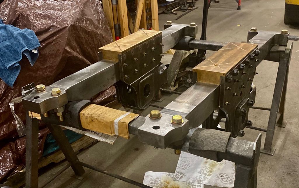

A photo of the crossheads being trial fitted to the lower guides. The lower two rows of temporary bolts and nuts have yet to be replaced with copper rivets.
Links to the February and March reports which I neglected to post, as well as the previous 14 years of status reports can be found at https://www.alaskarails.org/pix/former- ... index.html

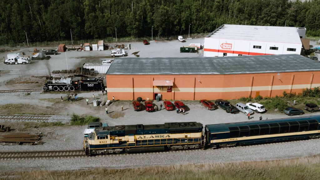

The big news is that we successfully completed our second steam test today, Saturday, July 11. We completed all planned tasks with no surprises or issues. More to come at Facebook "557 Restoration Company" and the next status report. We will also be posting a video on the "557 Restoration Company" Youtube page.
Drone shot courtesy of Donnie Rosie.
