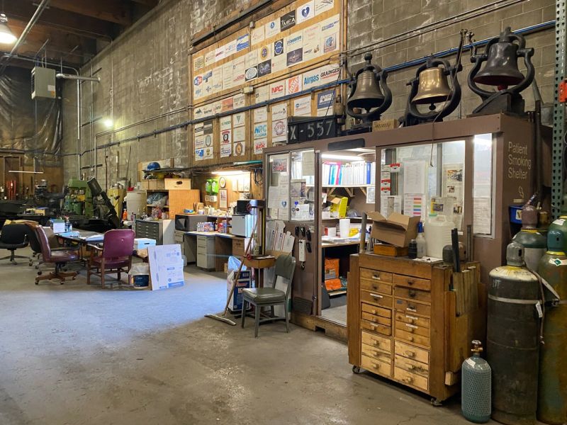

In addition to news, the report includes a virtual tour of the 557 Engine House, including a view of the palatial Engine 557 Restoration Company international administrative offices.

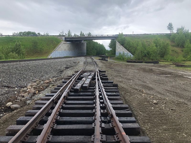

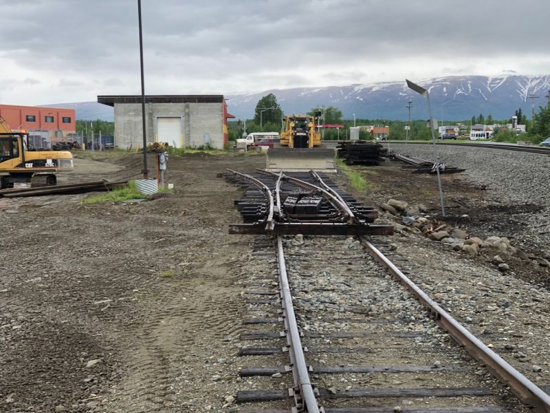

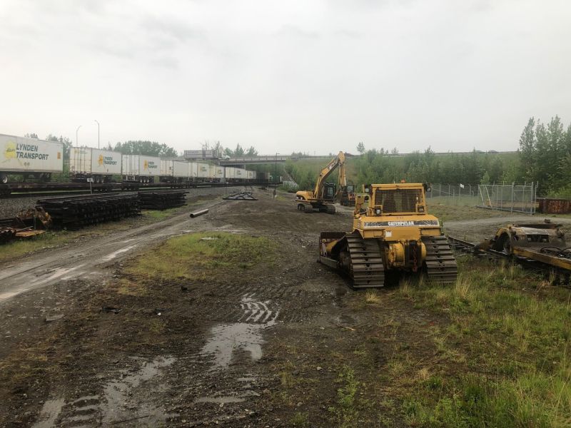

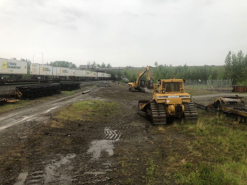

This week, as the Engine 557 volunteers worked feverishly inside of the Engine House to ready the locomotive for its first steaming later this year, a crew from the Alaska Railroad was on site to upgrade the Wasilla section house spur with a second switch and track panels to tie the isolated stub where 557 sits onto the spur and ARR main. Several feet of fill is being added to raise a low section between the Engine House and main. The dream gets more real every day.

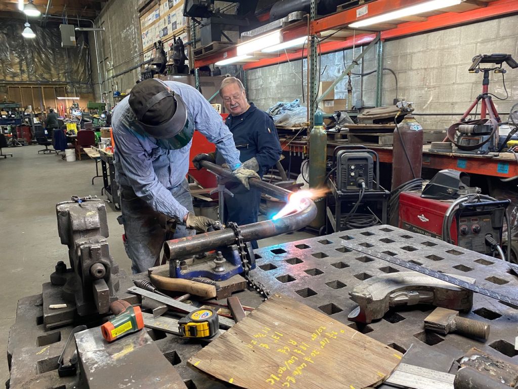

By the time we are done, most, if not all of the piping will have been replaced. Here, Paul Dalleska bends a replacement for one of the injector starter valve delivery pipes.

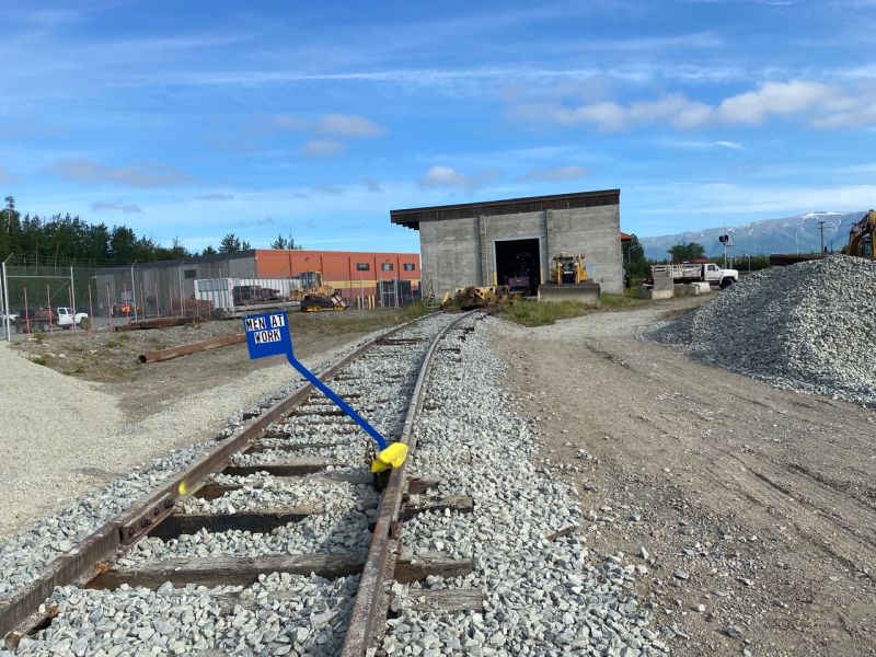

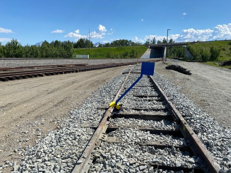

Another step towards operation. With connection to the ARR main in late June we are now subject to blue flag protection rules.

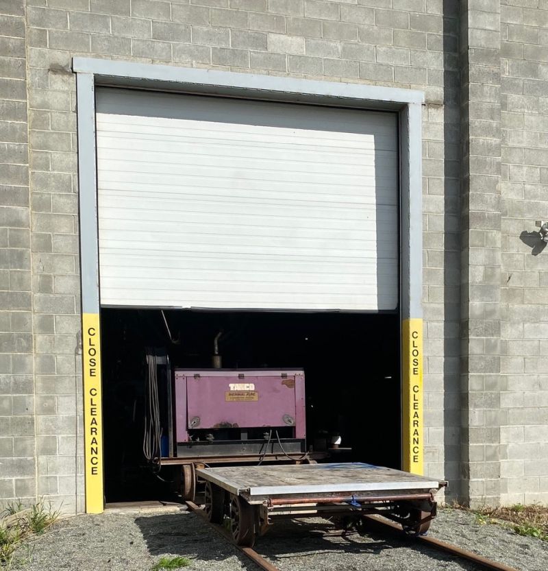

The close clearance signs next to the door of the 557 Engine House are another clue that we are getting close to completing the overhaul mode and preparing for the operating mode.

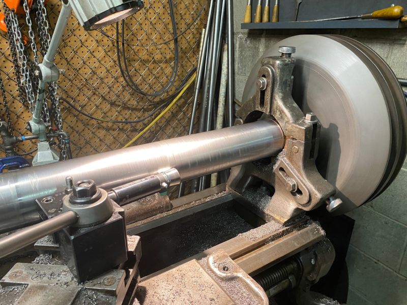

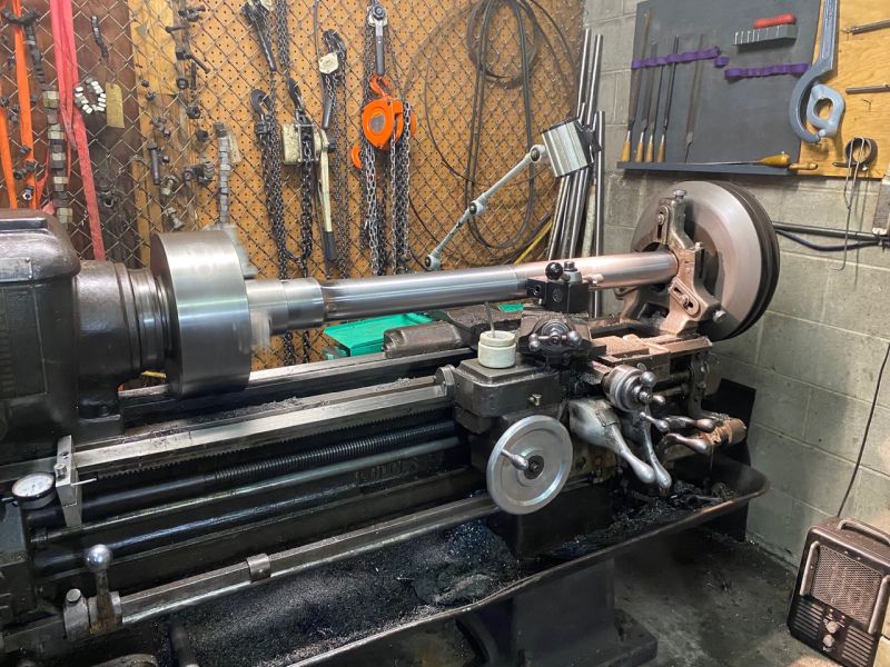

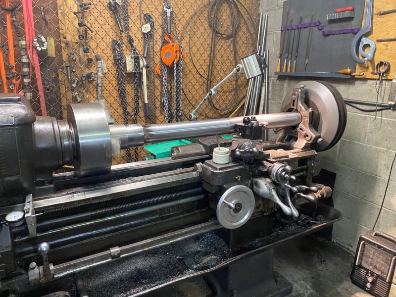

Our initial plan for refurbishing the piston rods was to have them ground. However, after checking with three of Alaska's largest machine shops, none had equipment big enough to grind the rods with the 19" diameter piston still mounted.
After some thought, we got creative and put our 12" swing, pre-WWII, Lodge and Shipley lathe to work. It was a perfect fit! In lieu of grinding, we turned and then roller burnished the surface. After several months of needing the lathe and machinists for other jobs, the photo shows the second piston rod being overhauled. One more challenge overcome.

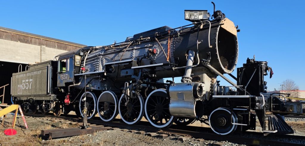

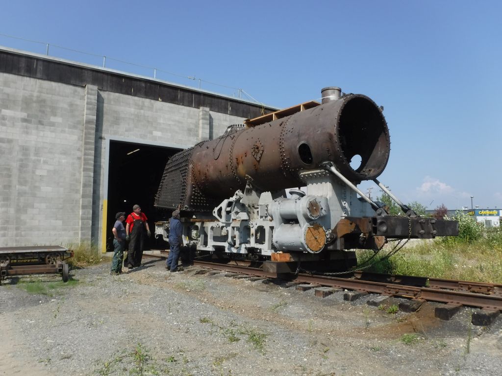

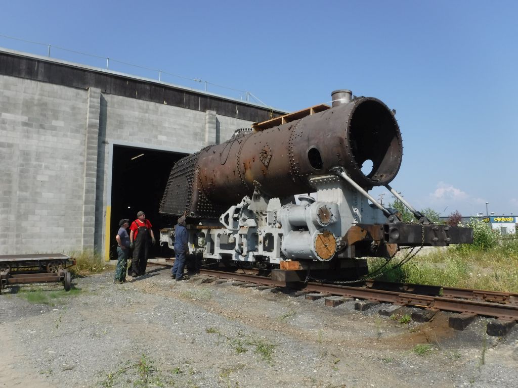

As a reminder of how far we have come, here are photos of 557 in 2013 after being dismantled by the restoration crew and the photo from last week when she was rolled outside for a few hours for an initial boiler wash after the boiler rebuilding and hydro was completed.

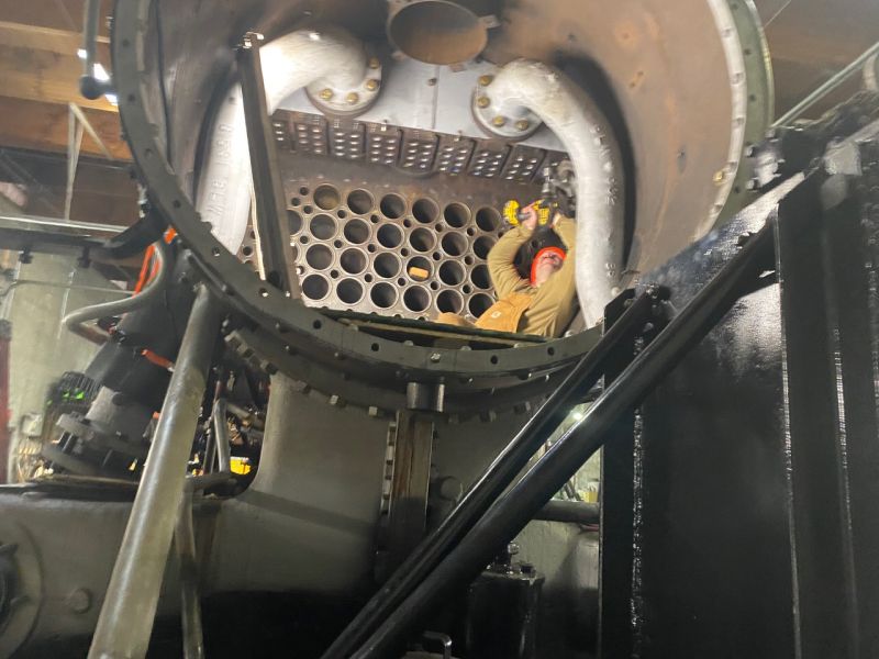

One of our newest volunteers, Frankie, is polishing the sockets in the superheater header, one of the tasks to be finished before our next major milestone, firing the boiler for the first time early next year.

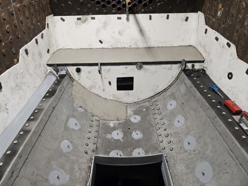

We are making steady progress towards the first fire up. 1/4" thick fabric liner is being held in place by magnets until the first coat of castable mortar can be applied. The firepan was totally re-designed from what the Alaska Railroad installed when they converted the locomotive to oil in the mid-1950s. Their design required that a driver be dropped to remove the pan, ours doesn't.
