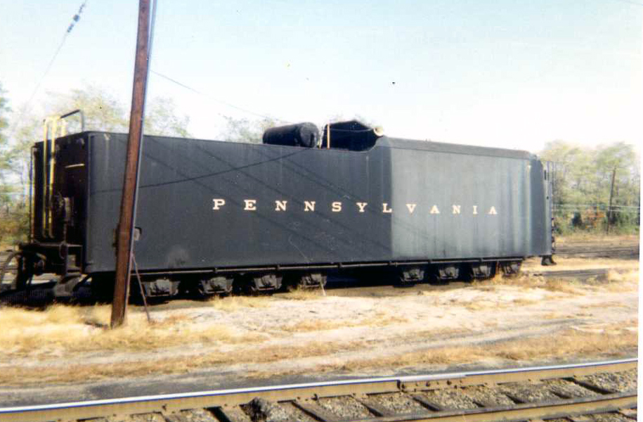

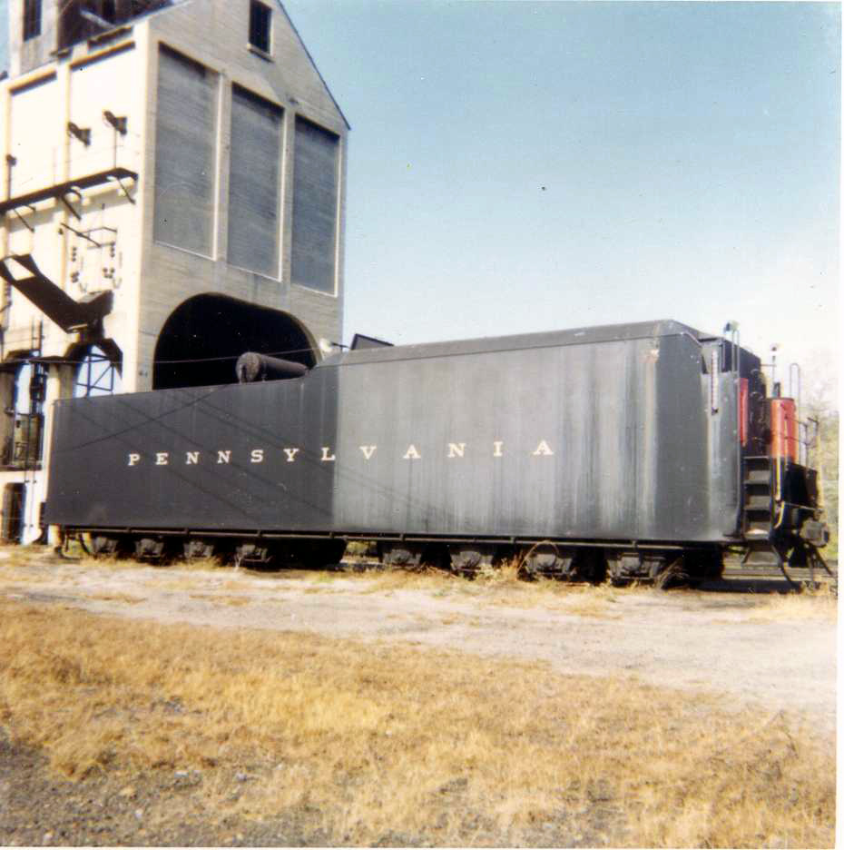

Two images I shot while chasing George Hart's 1286 & 1238. These were the "Brownie Camera years".
Perhaps they have value in this discussion.
File comment: October, 1966 R. Glueck

Here is more information from Bob Holzweiss.
Penn Central retired PRR 999401 (no PC number assigned) under AFE 7-2-99-777 during 1972. Per the retirement information, it was converted to MoW service during 4/59. To double-check, I reviewed the PC 12/31/75 MoW roster and did not find it listed under a PRR or PC#. I also checked the CR 1986 MoW roster to be sure, and it is not listed there either (as expected).
That said, I can add some mystery to the search because I happen to have a 3/4 rear view photo of PRR 999401 on 6/13/65 in reasonably fresh MoW yellow in service as a water tender. I am not sure of the location, but because of the catenary in the background, I can rule out Hagerstown. [emphasis added] Here is a shot of the tender at Hagertown https://conrailphotos.thecrhs.org/photo ... -7-24-1978 in 1978. I am also attaching a wider Harv Khan shot of the Hagertown tender from the same angle with the coaling dock prominent in the background. Although both tenders appear to be set up for the same use (note location of overflow pipe) and I am not an expert on PRR tenders, I am 99% sure the 999401 is not the tender at Hagerstown for the following reasons.
It was painted MoW yellow and lettered by PRR. Why would a successor railroad repaint it back to PRR and reletter it?
Note the equipment (?) door front/right on the 999401, but not present on the Hagerstown tender
Note the doghouse on the 999401, but not present on the Hagerstown tender
Note the right rear corner step is deformed on the 999401, but normally shaped here http://www.trainweb.org/wnyrhs/tenderFrame1Source1.htm
Note the brake wheel in the photo of the 6659 here http://www.trainweb.org/wnyrhs/tenderFrame1Source1.htm It is not present on the 999401
I suppose PRR or PC (or a private group?) could have changed the appearance of the tender (replacing step, adding brake wheel, removing doghouse, eliminating equipment door) after conversion to MoW and then repainted and relettered it back to PRR, but that would require a lot of money for a lowly MoW tender that remained stationary at a remote terminal. Considering the financial situation of PRR and later PC, I can't imagine that happening. The 999401 was also retired by PC after the bankruptcy when every dollar counted, so it is very likely it went to scrap to recover investment dollars.
That is a long way of saying, I think the starting point of the 999401 is incorrect for the tender at Hagerstown.
