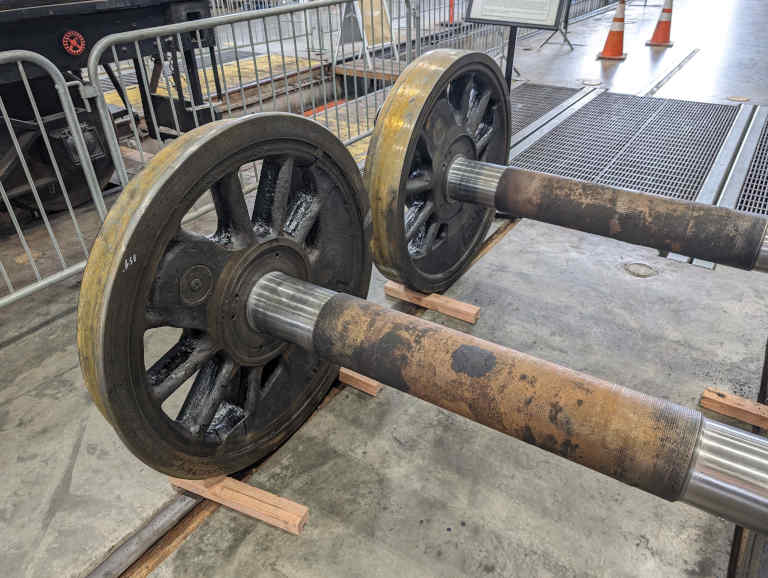

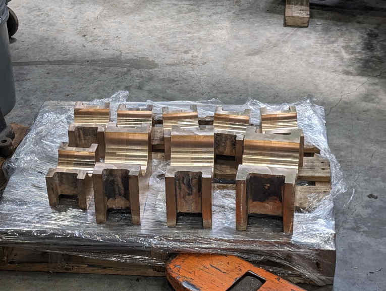

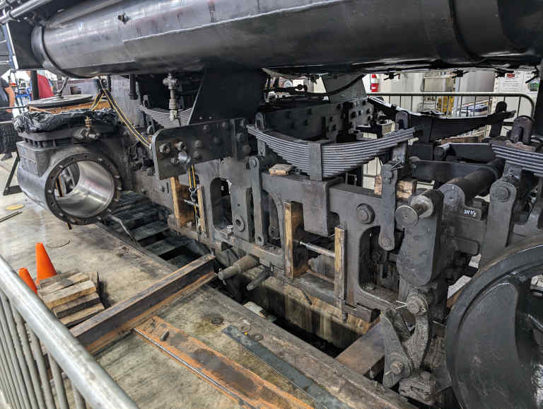

Regarding the Poulson #2, now in Portland, OR. at the Oregon Rail Heritage Center.
There is lots of work being done on the running gear ... the previous posts are mostly correct; the boiler work (1472) was completed last fall.
Long version of the story -- the owner is not a person for half measures. When issues became apparent during last year's Christmas trains, and after investigation, he decided to proceed with a pretty complete rebuild of the cylinders, bearings, driving wheels and the like. The work is proceeding nicely as far as I can tell. (I am a passenger car guy, not so much locomotives.)
I took a couple of pictures in between running trains at the Center today ...
1: the fireman's side over the pit. There is a lot of gear removed for servicing.
2: Two of the driving axles are getting some love. Note that what I'm going to call the side bearings, which are recessed into the cast wheel, have been removed (they were badly scored) and new ones are being fabricated in the machine shop.
3: Over in the shop, on a pallet, are newly cast brasses. Our people built the patterns and they were cast in a couple of different foundries within driving distance.

File comment: New brass castings
File comment: Two driving wheels
File comment: Parts removed for service

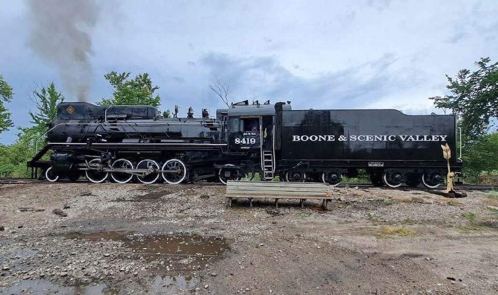

With a new look, BSVY's Chinese JS #8419 is shown at Boone on June 15 prior to coupling onto its first train of the 2024 season.
