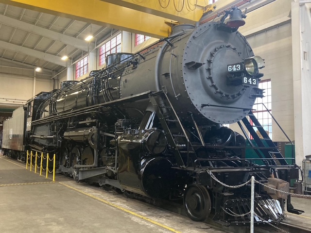

bbunge wrote:
Photo of a stunningly finished, or nearly finished, 643 in the backshop posted on Facebook.
https://www.facebook.com/groups/136509316364426
Private FB group, members only.
File comment: photo posted to Facebook by Sam Livingston
 Post subject: Re: B&LE 643 loaded onto flatcars for Ohio move
PostPosted: Sat Nov 23, 2024 12:57 am
Posts: 2892
Wow is all I can say.
PostPosted: Sat Nov 23, 2024 8:36 am
Posts: 404
Location: Scranton, PA
That result in less than a year is nothing short of amazing.
