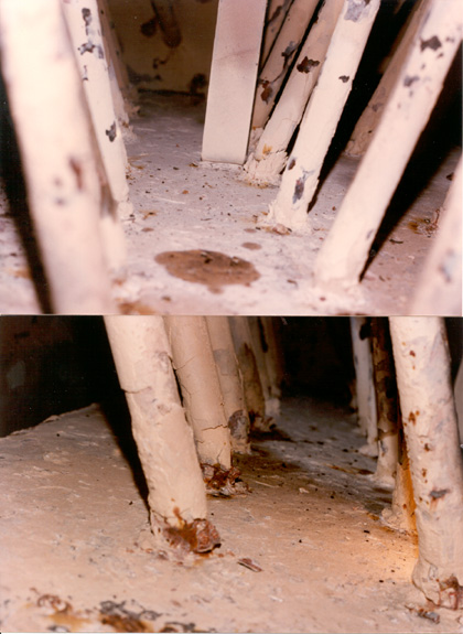

A good, thorough, hands-on visual still has great value.
This boiler was signed off by an insurance inspector 6 weeks before I crawled in. It helps if you know what your looking at...
Oh? How much, or what percentage of wastage (necking) is allowed by existing codes?
If you have to ask yourself "is it ok?" then the answer is "NO".

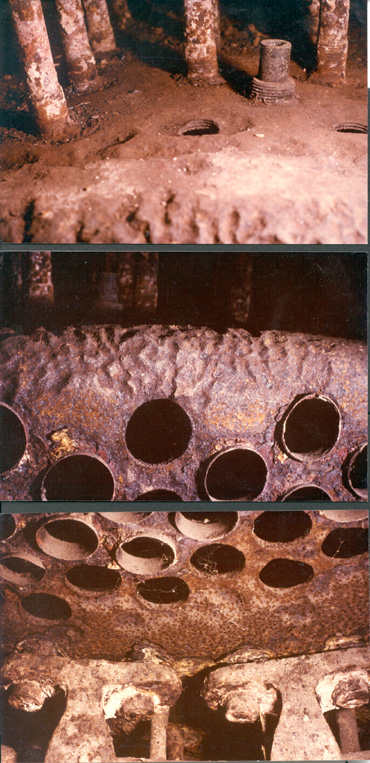

Although a hydro test, or even a hammer test, can tell you plenty about a boiler at the moment that you inspect it, they only tell a fraction of the story.
A hydro only tells you if it leaks. It does not tell you IF IT IS SAFE!!!
This boiler passed a hydro test and had a valid California certificate. Then I crawled in...
 Post subject: Re: OK Staybolts
PostPosted: Sat Dec 17, 2022 9:07 pm
The boiler at Mentor would likely have 'passed a hydro test' -- despite part of the plate being wasted to a measure 1/16".
My opinion of hydros is that they're useful in finding existing leaks -- NOT for proving boiler structure is solid.
