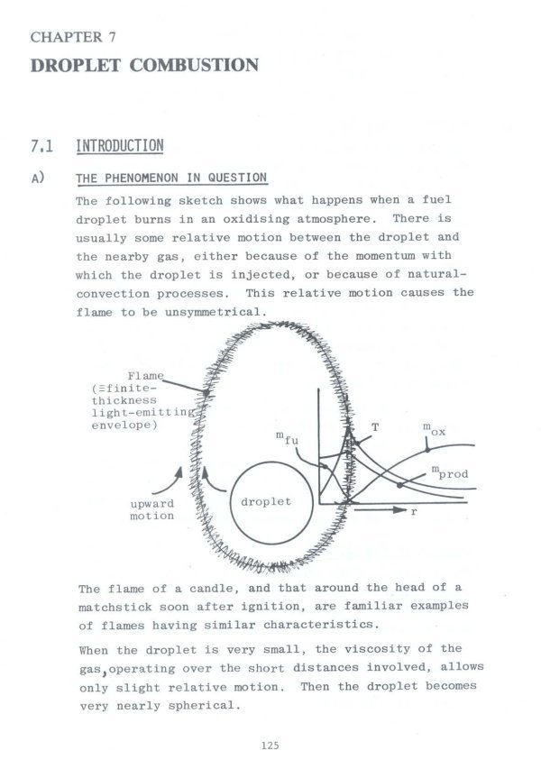

Whatever the fuel in a standard locomotive style drooling burner, it needs to be the viscosity of kerosene AT the burner. The oil drops need to be of a size to be consumed in the time of the flight path from the burner to the flash wall. This is calculable.

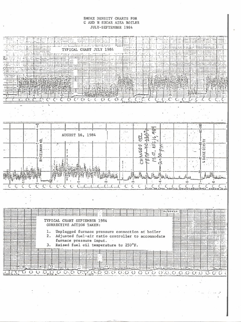

Secondly, a real world example of too cold fuel oil. When I was Superintendent at the local sugar refinery, the boiler always had a smoke haze. Several issues were involved but the major one was too cold oil. We were burning No. 6 in a boxcar size boiler. The manual specified 180F oil at the burner tip. So the electric oil heaters were set at 180F in the basement about 200 ft away when the boiler was installed 15 years earlier. What was happening was the too large oil droplets were being shot through the flame front with incomplete(smoke) and also, "no" burning. There were goocicles of condensed oil hanging from the economizer. I goosed the oil temp up to 230F with noticeable change as the system heated up. It took a 250F setting to get 180F at the burner, it was determined. For a week, the manager made the office call to see if the mill was running when he walked in the door. For the last 15 years, if he did not see smoke from the stack when he drove over Red Hill in the morning, the mill was down.

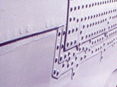

The boiler was installed by the factory. All industries on the planet function at a barely successful level of design effectiveness. How many Space Shuttles did we watch explode?
Eighty-five years after the Brockton(link) and Lynn(link) boiler explosions due to lap joints, the aviation industry's official answer to pop-topping the roof off a 737 at 24,000 ft due to lap joint cracking
was triple decker scab patches and bondo. (The fuselage thickness of the first 2,565 737s was 0.036".)
