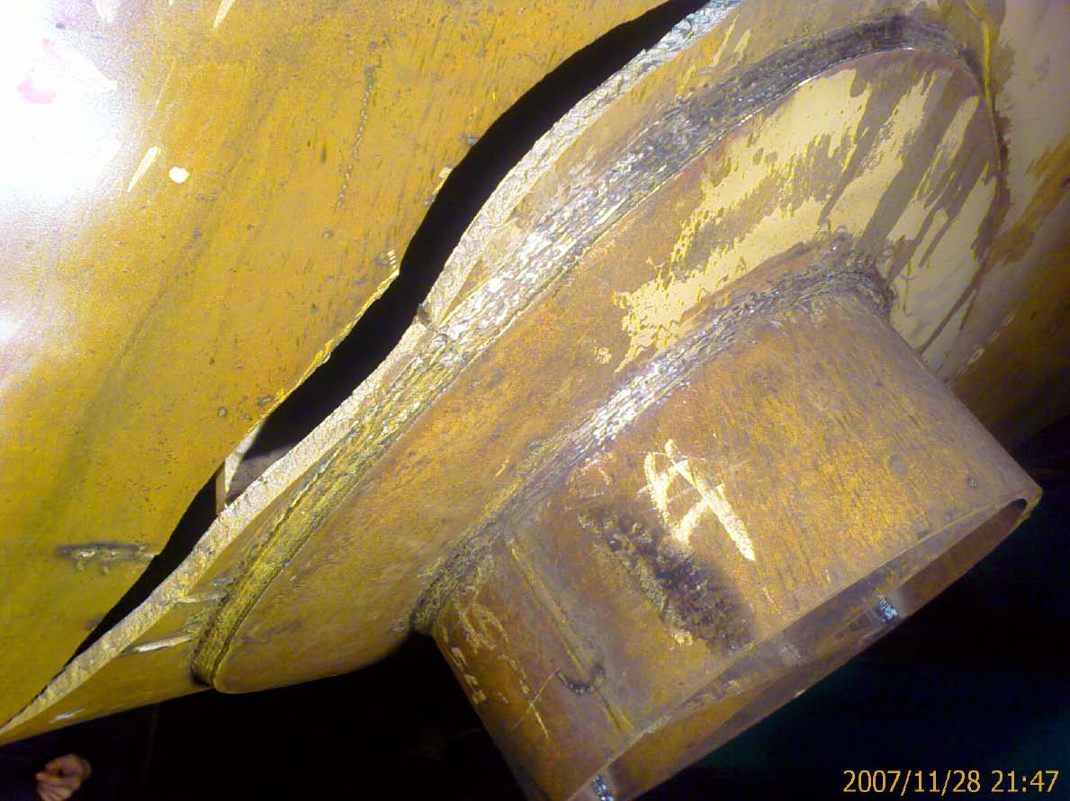

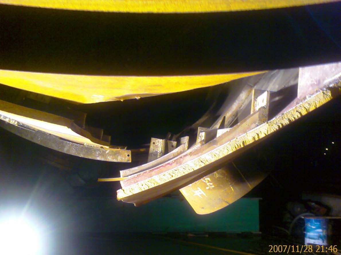

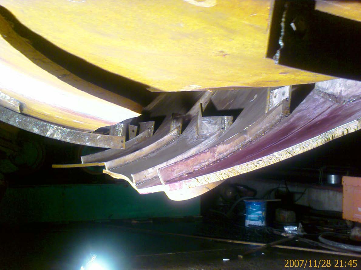

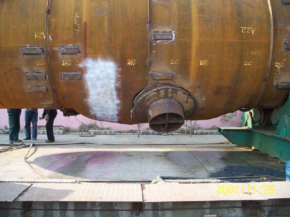

Overmod wrote:
The moral of the story is that a properly conducted hydro test cannot cause any sort of explosion -- that is a principal point of doing a pressure test that way.
Not necessarily....
Textbook NDT failure....
"Pressure Vessel Failure during Hydro Test
Nanjing Yuchuang Co, China
28th November 2007
Please find attached a couple of photos of a pressure vessel that recently failed whilst under hydrotest during post fabrication testing. This vessel was manufactured by Nanjing Yuchuang Co. in China and the plate was of Chinese mill origin. Unfortunately this is another example of serious equipment/material failures with equipment being sourced out of the rapidly developing economies such as China, Eastern Bloc and others. These examples are becoming almost a weekly occurrence now and are exhibiting failure modes not seen in the mature manufacturing economies since the 1930's. Again we need to ensure vigilance in the acceptance of manufacturers and once more I stress the need to know where the base materials are sourced from.
Apparently this pressure vessel had reached fifty percent of the required test pressure when the shell ruptured. A metallurgical failure report is not available however from the photographs a number of observations could be made regarding the quality of the material and the welding. If you check out the welding (undercut/poor visual/arc strikes) it is unlikely that this vessel would have be conforming to any Pressure Vessel code, let alone be ready for a hydro.
As others have said in relation to this particular failure example I bet there would be more than the one contributing factor ("The Material") associated with this failure."
Pressure Vessel Failure during Hydro Test[_img_1.jpg [ 85.18 KiB | Viewed 18009 times ]
Pressure Vessel Failure during Hydro Test[_img_2.jpg [ 77.01 KiB | Viewed 18009 times ]
Pressure Vessel Failure during Hydro Test[_img_5.jpg [ 119.3 KiB | Viewed 18009 times ]
Pressure Vessel Failure during Hydro Test[_img_10.jpg [ 43.97 KiB | Viewed 17999 times ]

There is no evidence in the photos that you posted that the system being hydro-tested "exploded". A rupture or weld failure during a hydro test is just a rupture. IF it had been a failure under high pressure steam, then that could have resulted in what many would call an "explosion".

"There is no evidence in the photos that you posted that the system being hydro-tested "exploded". A rupture or weld failure during a hydro test is just a rupture. IF it had been a failure under high pressure steam, then that could have resulted in what many would call an "explosion"."
What Matt reported might, in fact, have qualified under the sense in which I used the word "explosion", a dangerous rapid structural energy release as a consequence of testing. Moreover, I easily see propagation as occurring at, perhaps faster than, the speed of sound in steel, which might make this tantamount to detonation kinetics...
When boiler explosions proper were less well understood, and boiler materials, pressures, and fabrication were different, it was noted that there were two broad results of explosive 'steam explosions' -- those in which rocket effect and expansion of supercritical water produced the damaging effect, and those in which the boiler material was observed to shatter, often without respect for plate boundaries or connection, precisely as if shockwaves were directed into a brittle material. This represents a potential third class related to the second: an "explosion" (or more appropriately perhaps a 'rapid unanticipated deconstruction', due to unrelieved strain in the metallurgical structure, or developed during the stress of the testing, that abruptly and probably very loudly progresses to much of the structure beyond an initial hydraulically-induced point of initial failure.
My initial brief understanding of the failure in Mr. Austin's example was that high stress abruptly relieved in the initial 'hydro-induced' failure created stress raisers in the surrounding metal that then propagated prompt cracking through much more of the material, perhaps at high speed, perhaps like cracks in tempered glass or similar material. Considerable noise and energy could be expected to accompany this, although not likely even a spray of high-pressure water through much of the evolving crack, and not of course the cumulative damage from expansion of a large mass of supercritical content.
I had not considered the possibility of this kind of event in assessing hydro testing 'risks' and I'm grateful to Mr. Austin for bringing it up with a valuable example.

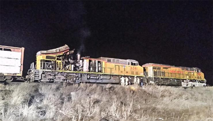

Here's an explosion, or at least that is what Trains Magazine is calling it, in Utah yesterday (01/09/2021), North Country Fire Department (UT) photo: https://trn.trains.com/news/news-wire/2 ... locomotive Not sure what would do that back there, but I believe the compressor is located in that area.

M Austin wrote:
Not necessarily....
28th November 2007
yes, it's correct that check welding and all part of the vessel before hydrogenation otherwise it may harmful and use safety gears during testing.
