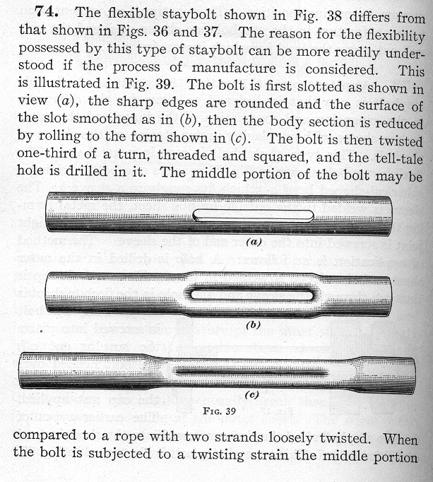

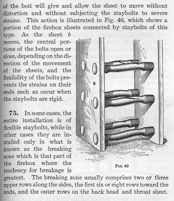

Here are a couple of interesting pages from the International Library of Technology series, Steam Locomotives and Boilers book, by Charles A. Norton from CNR, 1923.
Those flexible stays are interesting -- did they see much use?
Also, using a nut and copper washer on the fire side of the crown stays is of interest.

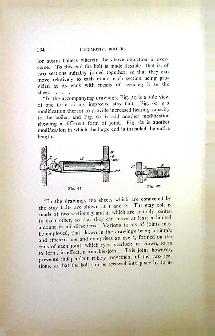

From a book soon to visit the binders Locomotive Boilers By Calvin F. Swingle. Mr Shaffer's Improved Stay Bolt is pictured.
Robby Peartree

I love the goofy stuff people came up with to address problems like stay bolts. But it has been said that there is little satisfaction with gimmickries, and I believe that.

For those interested in the contemporary account of the Shaffer staybolts -- an early account is in the Brotherhood of Locomotive Firemen and Enginemen's Magazine, volume 38 (1905). D.L.Shaffer was a brother of Lodge 318, Pittsburg (which is how the city in Pennsylvania was spelled at that time).
The same four cuts, labeled the same #59 to #62, appear in Swingle's Modern American Railway Practice (vol.1) on p,163. This is also downloadable from Google Books if one wants a reference copy.
I have discovered how to obtain a PDF copy of Swingle's Standard American Locomotive Engineering (1244pp, 1912, ed.1914) which he wrote to supplant Forney's Catechism of the Locomotive as a training tool for future Locomotive Firemen and Enginemen. This was scanned at the Library of Congress, but its digital identifier (https://hdlk.loc.gov/loc.gdc/gdcscd.00337757947) returns only 'digitization in progress' and all three physical copies show as 'on internal loan - overdue'.
Fortunately, pandemic or not, you can get a downloaded copy, albeit as a very large file -- call up the 'gallery' view of the pages, and at the bottom you will see a link to download the 'entire PDF'. You have to click the actual link, and then click the little 'go' button beside it. (It is just under 957MB on disk as downloaded!)
What these references appear to show is that brother Swingle was mentioning the Shaffer staybolt as the production of a fellow member of a BLF&E lodge, rather than due to its phenomenal service -- note that it follows discussion of the Tate flexible staybolt in 1908, but has disappeared from the larger volume's discussion four years later. I suspect this is no particular accident.
Aside from ignoring some of the more obvious questions about the true action of the Shaffer 'universal joint', the inventor appears to have labored under the idea that the hollow, larger portion of the bolt went into the fireside sheet, so that it would be 'open at its inner end to the furnace...' and thereby supposedly increase the amount of exposure of the hot gas in the firebox to the water in the stayed space. You, I, and the fellow behind the tree know it would do no such thing for any particular length of time. He also has a version where the entire length of the hollow portion is threaded, putting heaven knows how many stress raisers and corrosion-crack initiation points into the bolt in the waterspace. This frankly doesn't bode well that the universal joint that has just been used to drive the (I thought it was the inner, but apparently it isn't) smaller end of the bolt to where it can be 'riveted' is going to provide the proper combination of spacing and bending action to give flexibility in a wet environment with typical scaling contaminants present. How he proposes to clean the joint in service is even less clear; perhaps he assumes differential expansion will keep it cracked free. Personally I see tremendous issues with wear at the mating surfaces of what will be a stressed universal connection as set. Did he think it would unwind as the end was riveted over? -- perhaps it would.
I'd be interested to see the long-term serviceability and failure modes of those twisted-slot staybolts, perhaps especially the types forged with two 'legs' that were then twisted to shape. All this was in the age before practical NDT; how would you know the iron had been shaped correctly without defect, or opening up surface cracks for corrosion or stress raising? Or make sure all the little twisted voids didn't fill with scale? Somebody also has to explain to me how telltale holes work with bolts made this way... I don't see how.
Now, I presume the idea is that a universal-joint design that is 'fillet-welded' with good full penetration (e.g. with properly blanketed laser keyhole welding with adjusted preheat) from both 'outsides' of the waterspace could be aligned to produce hinging in the 'correct' plane of calculated differential expansion. (To get this you would matchmark the outside of each 'half' along its axis of action, and fix first one end, then rotate the other and fix it, via tack welding before proceeding with the circumferential automagical weld). The problem is that I think you'd have the same trouble with water-treatment action in the hinged joint, and much the same difficulty with cleaning or inspection. You might get around some of this with selective plating or hard coating of the joint, or using manganese or other sacrificial anodes distributed in the boiler structure. I'm sure Mr. Peartree has some reasonable answers for how this might be made metallurgically practical. I see in the '47 Cyc that molybdenum steel was touted as a material for staybolts and also ideal for welding fabrication (p.241)
