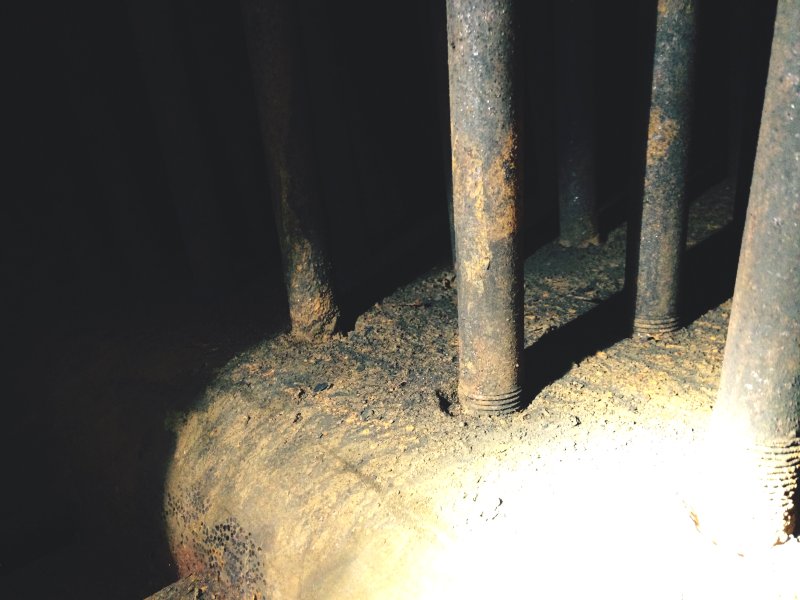

The same rules are invoked on in North America. Wasatch holds a National Board "R" Certification and ASME "S" Certification. These were not invoked in the contract, however, FRA standards were, as the boiler was to run under FRA jurisdiction.
Assuredly there is NO boiler repair standard that allows a Chinese threaded staybolt to be installed in a sloppily torch cut hole in a locomotive crown sheet by welding, either fillet or full penetration.
This photo and attached files were obtained by FOIA request from the FRA.
JFC. Well, there's the evidence. The question is then: why?

M Austin thank you for posting those photos. I am shaking my head at these photos. This is down right criminal! Especially concerning was the enlarged, torch cut, stay bolt holes. As anyone who has worked with pressure vessels, the smallest area compromised could lead to the failure of the entire vessel. In this case the large amount of metal removed around the stay bolt would reduce the metal thickness in that area to at least half of the minimum.
I would also never leave a rough torch cut hole like that as every valley is where a crack could likely start. I have worked with holes like that and I doesn't take much time to simply build up the metal with a little welding and then drill a new hole. Wasatch have you guys ever heard of a carbon arc? Have you ever used one? It's hard to believe someone was up there burning out the entire stay bolt into what must have been a huge pile of molten steel with a cutting torch. No wonder the stay bolt holes are so reamed out. Guess you just keep cutting until the bolt drops out? Good grief.
The offset crown sheet photo??? Wasatch what were you thinking? Damn man I have seen some shady work over the years but did you think nobody was going to notice that? It's pretty much completely over the metal it should be butting up against. That weld build up can't be no more than 1/2" thick. Boiler is totally compromised.
You didn't even V grove the crown sheet to the knuckle before welding? This one is truly hard to believe. Those welds must have 100% penetration. No way you would even get 20% through that thick metal the way it was. No way a surface weld would hold with that thick metal. It would have cracked the first time it got hot.
This boiler was nothing but a time bomb waiting to explode. That FRA inspector was a God send. I am sure these photos will be used over the years for the hall of fame of bad repairs.

I think the attachments from M Austin put this one to bed. Materials aside, the quality of the workmanship is frightening. Seems reasonable to say that the railroad didn’t get what they paid for. Case closed.
