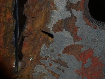

Is this a piece of wire sticking through, as in this seam was wire welded i.e. MIG? I was under the impression that MIG was not approved for pressure vessel welding. Am I mistaken? If not, then there are bigger problems than poor fit-up. And, yes, I am aware that sub-arc is approved however it isn't the same as MIG.
When I worked in the shipyards in Seattle, we used dual shield welding for just about everything. Our machines were running some serious amperage (up to 450 amps) with 1/16th inch wire running through the gun. You could weld 1" plate on a single pass and go through a spool of wire in a hour. Your traditional MIG runs .035, .040, .045 wire with most welders topping out at 120 AMPS. That is good for 1/4"-1/2". Many shops use this along with many contractors.
I have never heard of any restrictions on Mig welding including boilers. We did not use stick welding except on rare occasions. On one shift I did need to do a lot of fill and dusted off some rods. Using 1/4 inch rods, at 400 amps, lit up the shop like the flash from a atomic bomb. Radiation and light was so bad I had to wear dark cutting googles under my welding hood. So stick welding is hardly ideal for anything over 1" and will take a long time.
There is no question in my mind that Mig should be used when ever possible. Mig certainly has issues and the far majority of welders are going to fall into the 120 amp and below category running usually .035 or .040 wire. This wire and amperage is problematic when running uphill welds and most welders can not do it. So must welders run downhill instead which gives a good looking weld but very poor penetration. No way I would do downhill welds on anything important. But you can run very good welds going uphill with stick welding.
So in a nutshell if you are going to Mig something thick like a boiler you better be bringing out the big guns and demonstrate that you can weld uphill and overhead before the project starts. I find stick welding a bit more predictable when doing harder work such as overhead welding but it takes much longer.
