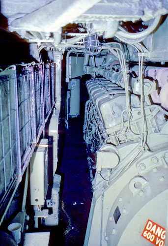

The thing is, they are restoring it as a Santa Fe unit, and the entire time it was a Santa Fe unit it had a 16-244, up until it was stricken from the roster and traded into GE in the late 1960s. And because almost everything back there was pulled out and sold for scrap when the unit was sitting on the ground in Mexico, all of that will likely need to be fabricated new anyway, including the traction motor blowers. Accuracy is its own justification.

Here is how they looked originally.
PC
