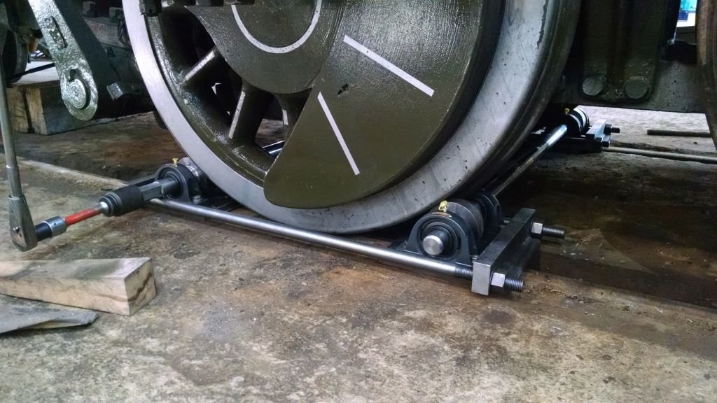

J3a-614 wrote:
What you are describing is called "quartering." Some links below may help out.
I understand quartering. Perhaps to be more clear, how will they rotate the rear driver so the cranks line up in order to install the rods?
Bob
Well, I have to guess, but I would think the shops have some way of lifting a wheelset and rotating it to line up for rod mounting.
I couldn't find anything on that, but I did find this. Enjoy!!

We intend to build a tool like this one that Bruce Mowbray of Steamtown built and posted to another forum. He says he can spin the wheelset using a 3 foot ratchet and can make micro adjustments for timing purposes. Those are 56 inch drivers but it can go up to 80 inches if necessary.

Posts: 1803
And that's the difference between Steamtown and Strasburg shops right there.... :)

Kelly Anderson wrote:
Dick_Morris wrote:
We intend to build a tool like this one that Bruce Mowbray of Steamtown built.
Us too! Just the ticket for setting valves, but overkill for lining up crankpins for assembly. It's a lot of work to set up the heavy parts and lift the wheel set clear of the rail to spin it.
The shop at Chama on the C&TS had put together this kind of set up a couple or three years ago for setting valves.
See: Some nuts and bolts of valve setting
