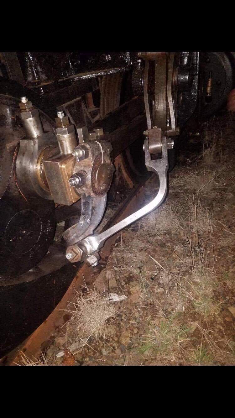

All are good. I'm unclear as if the locomotive was in motion when the incident happened which could make some difference, so I'm just running a set of mental exercises in the absence of information from people who were there at the time. Most of my work has been on older smaller locomotives with a lot of slide valves, so it's puzzling to me. They're pretty robust, straightforward and forgiving.
Again, just one picture a friend forwarded me which shows some bent and twisted metal valve gear parts but nothing I wouldn't try to heat and straighten in it if it were my situation. No doubt the one picture didn't tell the whole story, the guys on site will make the best decisions about what techniques work best for them in their circumstances. It's simply just easier with today's technology and options to make custom parts than when things were more limited.
Learning, please - we are all stronger when we share experiences and allow each other to steal our good ideas freely, which makes it not stealing at all but - I dare to suggest - collaborate?
I have in the back of my mind an experience I had when a little tank engine with Richardson balanced slide valves but Stephenson gear locked hydraulically due to grunge coming down the drypipe with wet steam at a test run plugging everything up. It didn't cause any damage in my case but we only had about 50 PSI on her at the time...... a warm fog. Unlikely, but.....

Thanks, Dave. From the photo you saw, could you tell if the damage shown was on a high pressure engine or a low pressure engine? As noted earlier in the thread, on startup a lot of condensed steam forms in the high pressure system which is then pushed to the low pressure engine when running in compound mode. If the engine was not started in simple mode such that HP steam from the boiler was being directed to the low pressure side until all the engines were warm and condensation ceased, and the cylinder cocks on a low pressure side became obstructed (or were not large enough to allow all the water to escape in a timely manner) such that the low pressure side filled with water, could this have caused the damage you saw in the photo?
With a compound locomotive, on rebuild should the high pressure engines be first blown out with steam before the low pressure engines are reconnected to make sure any welding residue, dust, and grinding dirt that may have been produced during the rebuild is blown out fully and does not get deposited in the low pressure side - and then connect the low pressure side and steam clean the whole thing?

We do know that either the valve was being forced and the wheels weren't cooperating which seems unlikely in a slide valve, or more likely the wheels were moving until they were stopped by the elements of the valve gear reaching their elastic limit and then some, probably accompanied by expanding verbal expressions....... due to something preventing the valve from being moved. The at least thirdhand report I got was she wasn't moving and this happened when the throttle was opened - but I can't figure out how it could have happened without at least a partial rotation of the wheel.
Outside admission piston valves can act like pistons, however.... but that's another story.

This is the photo of skookum. Note, I’m not using it as an attempt to “slander” them. I’m merely calling out that this is NOT a “normal” issue or a simple teething issue.
This photo has been posted on multiple platforms and has made its rounds.
Not trying to get everyone worked up, this way those who aren’t entirely sure can see and make their own conclusions. In my opinion it should be out there and an explanation of what happened to further assist those of us in the steam industry so such does not happen to any other engine.......

Thank you for posting, and doing so without "malice" to the Skookum people.
Yes, it does look like something jammed, and I'm going to guess it was with the valve gear in "compression," possibly when the motion was in about the position it is in now. I'm not an expert, but the damage we can see looks limited to valve gear parts; crankpins and the hanger for the reversing link look OK (though the Skookum crew will have to check those to be certain). There may be other damage further forward we can't see, and of course there's the question of how the jamming occurred in the first place.
It's embarrassing and certainly saddening, but as others have noted, after all that this engine went through, and what the restoration crew has been through, it looks like the repair may be relatively minimal. I can't help but think that stuff like this happened every so often in regular service days; it's certainly less than some other things, like having main and side rods come off at speed, taking the valve gear and running board and anything else in the vicinity off in the process (and tearing up the cab, with the engineer, on a Camelback). There was even a case, in just the past year or so, where a main rod came off Southern Railway (of England) 4-6-2 Tangmere; it hit the third rail, shorting out the power system, throwing circuit breakers and killing operations of other trains for miles around.

Bad things can happen to slide valves if lubrication is lost or not of enough volume. unlike a piston valve all of the pressure in the steam chest is pressing down on the valve; a force the valve gear must over come.

Kelly, thanks for the photo.
What material do the balance strips wear against on the top? like a brass shim on the bottom of the cover?
