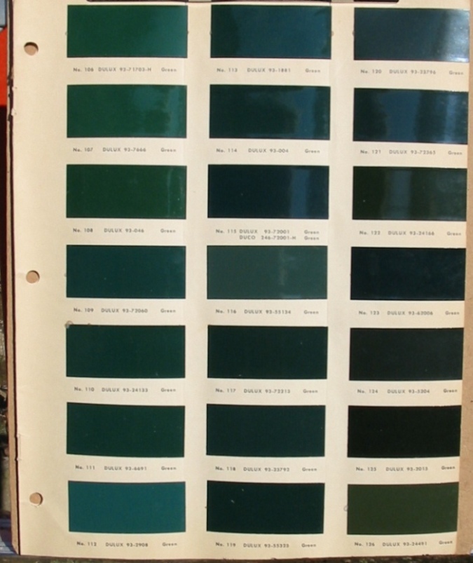

Hi guys!!! Most of my personal preservation work involves older Dodge trucks so I'm fairly familiar with the Ditzler/PPG system. When it comes to DuPont, the "93" prefix Dulux automotive/truck/fleet enamel codes seem to be the most common and easiest to match. In my search for those elusive Reading codes, I picked up a copy of the 1954 Dulux Bulletin Number 11. Plenty of railroad colors there. For instance, here's a page which shows about half of the greens. 93-1881, CNW Traditional Green, a.k.a. Studebaker Clover Green, is located top center. I believe three of the five Reading greens are presented here as well. 93-72001, Chevrolet Juniper green, was also used by Allegheny Airlines before they became USAir...

NVPete - Welcome to the Interchange. You are correct that a fair amount of railroad related colors crossed over into the automotive finishes, your DuPont 1881 is an example.
Just to expand a bit, a good source for color chips that do cross over into the car/truck realm are the chip sample pages from the old color catalogs like the page posted. The names will be different but the color number would be the same. I’ve also used this automotive database to cross reference with some success: http://paintref.com/paintref/index.shtml. With DuPont colors, you’ll need a chip to match if you don’t have a cross to another manufacturer’s number. PPG can still use the old Ditzler numbers to get close but you’ll still need a sample for fine tuning of the match since the formulations are so different nowadays. I haven’t yet investigated if other manufacturers can still use their old numbers.

Another excellent source, while it lasts, is the Sherwin-Williams "Formula Express" site which allows one to both cross-reference paint codes among various manufacturers and identify users of those particular codes...
http://sw.formulaexpress.com/
These alternate sources of paint color examples were instrumental in allowing me to ascertain the postwar Reading codes. If you bear with me, they'll eventually appear right here before your very eyes but if you'd like, I'd be more than happy to carry this on in a separate thread.
This particular Reading green not included on the page above was one of the paint colors utilized by Fairbanks-Morse on their Model "Z" hit-miss engines. The matching DuPont code is on your list, used by another famous railroad-related organization as well...
