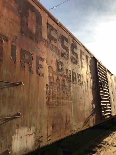

I happened to be out at OERM last week for a brief visit and saw the "other" car of this type at the museum. It seems to have a good deal more lettering remaining on it, including a car number which appears to date back to its Army days - 25828. This car was obviously lettered prominently for Desser Tire. Looking under the car, it did have CNW trucks and the brake diagram bolted to the car frame also had CNW cast into it (bottom left corner in the photo). The framing used Illinois steel; I'm not sure this is informative at all but might suggest the frame, at least, could have been built in the Midwest?

Thanks for the photos, and the info. The brake diagram has a 12-10 number on it. Might this be the original built date of the car before rebuilding? December 1910? I don't know enough about what's on those brake diagram castings to know for sure what that 12-10 might indicate.
Also, maybe someone can figure out how to "rotate" your one photo for easier viewing.
Thanks again for the info and photos.

Les Beckman wrote:
Frank -Thanks for the photos, and the info. The brake diagram has a 12-10 number on it. Might this be the original built date of the car before rebuilding? December 1910? I don't know enough about what's on those brake diagram castings to know for sure what that 12-10 might indicate. Les
I think it is a December 1912 date. Reason: The brake cylinder looks like a K-series!
Well, it's as good an idea as anything else--and the cars, all of them, certainly seem to have C&NW origins.
Now, who did the rebuilding?
I'm inclined to think the US Army.

J3a-614 wrote:
I donno, in the photo back on page two of this thread OERM 4 definitely has a AB reservoir. Anyway K equipment was legal for interchange into the fifties, and certainly still allowed for insular plant railroads even today.
Also, the way I read that 12 - 10 is the brake cylinder size, which is important to know, as that dictated the input force all those levers are sized to properly proportion.
