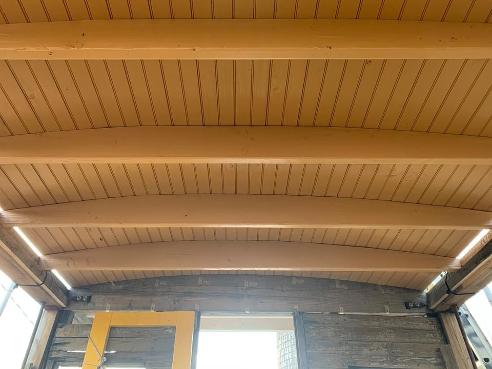

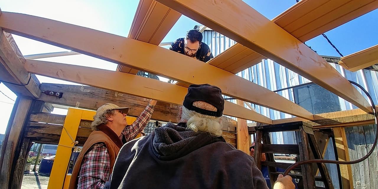

Two big milestones reached this weekend on the Hainesport N6b. With a lot of help, a crew of six actually this weekend, we were successful in getting the roof installed. No easy task, the planning and prep work of which has been in the works for months. Just getting the 80 or so planks primed ahead of time was a lot of work, again which would not have gone so quickly without help, while Ed and I sorted the rafters and their installation.
Now, I know some will question the square bottom of the rafters. We just wanted the extra strength. For what ever reason, the PRR stripped out the steel sister bars that go with each rafter and used only two (one either side of the cupola base) I would guess during its last PRR rebuild. Height is not bad, a 6’4” person can walk under them no problem.
Plywood will cover the cupola opening until it is built and installed.
The other big milestone was the retirement of our tent. It served us well over three years without failure. Granted we made improvements, using a tarp rather than the usual tent cover which allows water to drain better, added self-tapping screws at each pipe joint, and used tie down straps diagonally and straight down to the caboose frame to add stability in windy conditions.
Next step? Finish the roof edges and trim the ends. Then its time to work on the siding. Maybe have it fully enclosed by the 4th anniversary of its discovery via ebay in a NJ backyard?

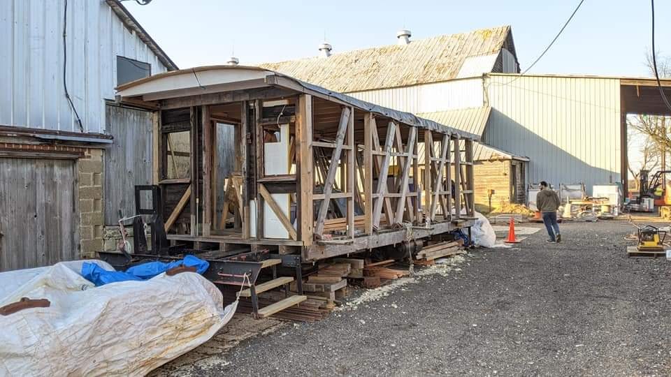

In the third photo it looks like you have a tarp on top of the new roof, and then something with a peak to direct water away from the tarp. What is the peaked thing made from?

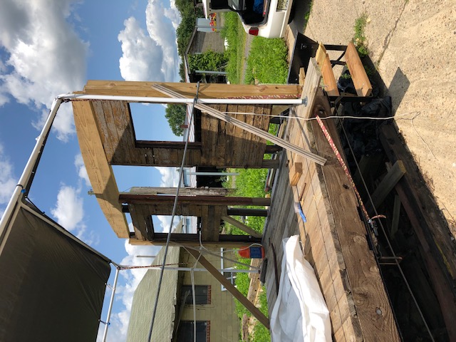

I think what you are seeing is the old tent and frame over the new roof rafters before the planks were put into place on the rafters. When we did the sub floor we left some floor boards long to mount our tent to so that the tent was really part of the car itself. You can see this in the last photo, but is missing in other photos. We used self tapping screws at all pipe joints then used Harbor Freight straps to tie it down to the floor boards and diagonal straps for wind stability when were were not working on the car. A slightly smaller tarp was bought for the steel tent frame which allowed rain to run off and not gather at the horizontal pipe work. Really worked quite well. Prior to the side walls going up, we ran heavy rope half way up the poles and the length of the car to help ensure we did not fall off the side of the car. All that was removed Saturday when the roof planks were put in place. A form fitting tarp is now over the new roof. We will cut the long subfloor boards off this coming weekend.
The attached gives you an idea of how we did the tent. 10x20 foot, all total maybe we had $175 into it. Served us well.
J.R./Ed
How will this change in rafters effect your closet construction?
Are the rafters sitting on top of the side beams or in notches?
Edit: I just saw the Facebook pic that shows them sitting in notches.

The square bottom rafters were not our idea. As originally built, the rafters under the ends of the cupola are not arched, they are square, flat bottom, cut so we just expanded on that idea. Cabinet doors under the cupola thus clear the square cut rafters and the cupola upper seat deck per PRR design so the clearance is built in. Cabinets beyond the cupola have doors of the same height as the cabinets under the cupola so they clear the square cut rafters that we used. Again, the idea to just go with square cut, or flat bottom, rafters was not really our idea, we just expanded on what the PRR had under the cupola.
As you noted, the rafters do sit in a notch in the top plate. Those timbers were expensive so getting all those notches in the right spot was rather high stress. 32’ long Douglas Fir is not something you run down to Home Depot to pick up if you screw one up.
The question will be asked, will you hit your head? The entry doors in the car are very short, so chances are a taller person will smack their head just entering the car. If one did not hit their head there, they would have hit their head walking under the cupola, so we just kept things a bit consistent once inside. Head room is actually about 6’3” under the flat bottom rafters, door clearance is under 6’.
So why go with flat bottom rafters? We used standard sized lumber for them which is slightly narrow versus full dimensional lumber as originally used. We also felt that today’s lumber is not of the same quality, strength wise, as the old growth Southern Yellow Pine that was used. We could have purchased some full dimension doug fir, and cut the arch, but it would have been very expensive and produced a terrible amount of waste.
Hope this was useful,
J.R.
