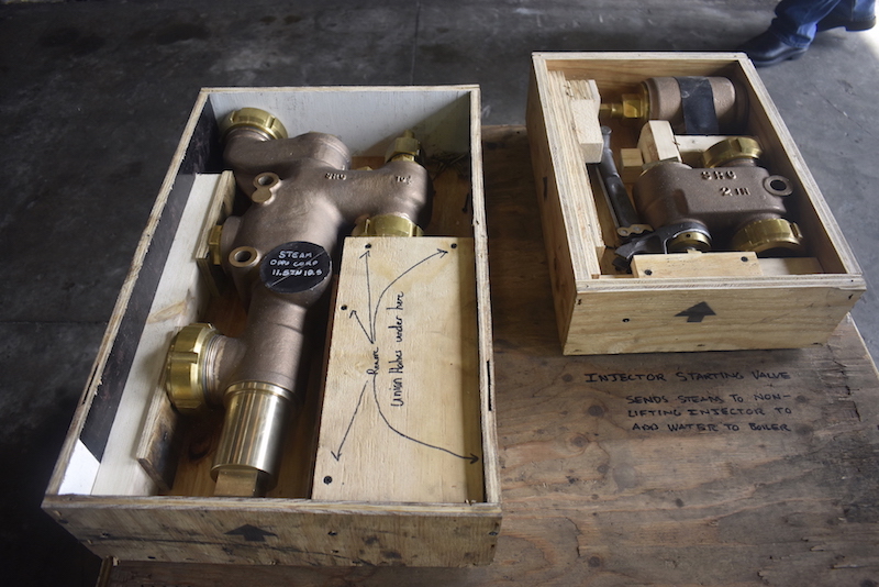

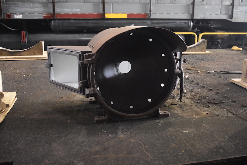

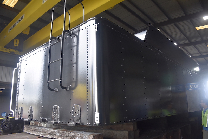

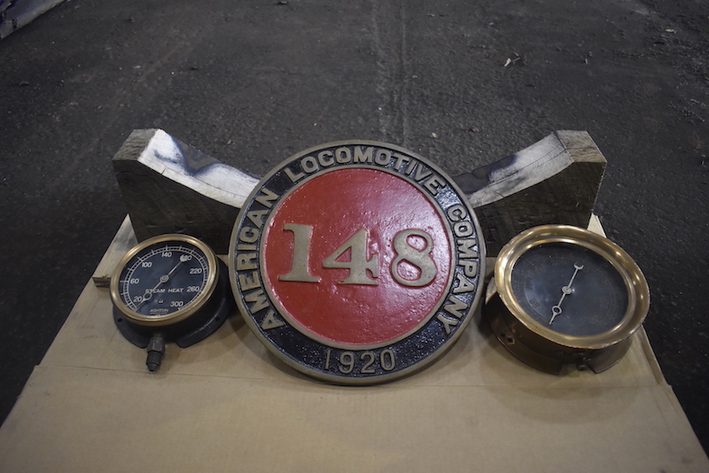

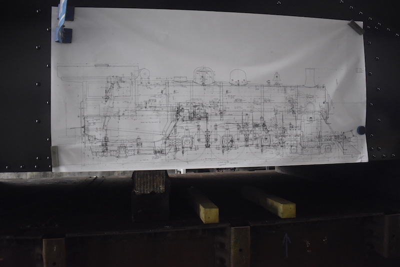

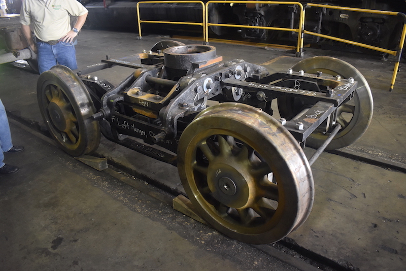

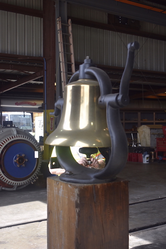

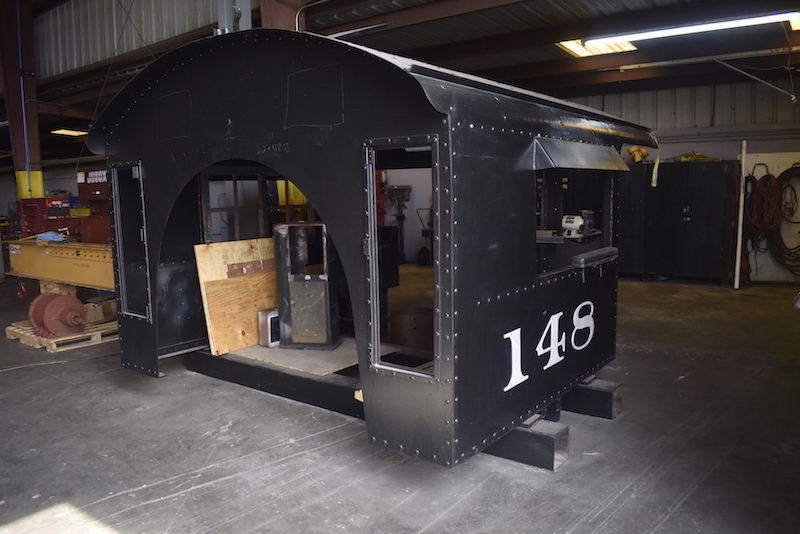

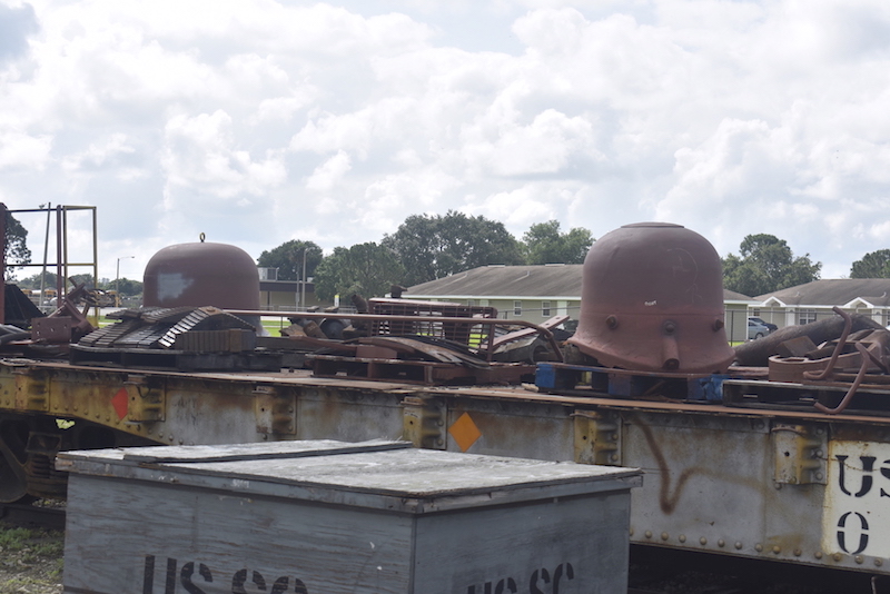

The Florida East Coast Railway Society was given the opportunity to tour U.S. Sugar's shops this past weekend to get an update on the 148's restoration. The tour was part of the society's 2018 convention. Here are a few of the items they had on display for us to view.

Another upgrade ! Changing her injectors from lifting to non-lifting.
