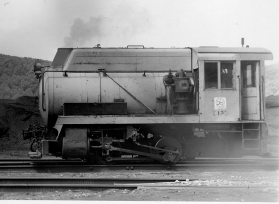

Pennsylvania Power & Light 120, Holtwood, PA, 5-18-69; by Wm. Hoffman, MRHL Coll..jpg
Pennsylvania Power & Light 120, Holtwood, PA, 5-18-69; by Wm. Hoffman, MRHL Coll..jpg [ 100.8 KiB | Viewed 22766 times ]
For the three people still paying attention:
This just came in from the latest set of scans from the volunteer scanners at the Md. Rail Heritage Library:
It's dated 5-18-1969 and labelled "Holtwood," apparently the date of one of the High Iron excursions up and down the Susquehanna with CP Pacifics.
Holtwood is a DIFFERENT hydro dam than Safe Harbor.
This shows the remote control equipment box on the running board. But we still can't figure out the letter or the last digit on the cab. The scanner labelled it "120," but as I recall it was B-129, though it looks like we could argue..... at any rate, it's similar to, but not a perfect match for, the above photo at Safe Harbor.... BUT could the photographer, William Hoffman, have confused the dams/locos?
A few more than three I would think.

I have an almost identical photo of the Porter at Holtwood I took the same day. Looking at an 8x10 print the number looks to be E 123 on the cab. Up on the cowling there is a faint 5.

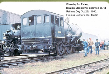

Hi
I found a slide of Public Service Electric & Gas # 6816, at the old Steamtown site, under Steam, Oct 25th, 1980. This was during Steamtown's Railfan Weekend, this was the only time as far as I know this locomotive was under Steam and moved around the museum site. for this event
File comment: Slide by Pat Fahey Oct 1980
 Post subject: Re: Use of Fireless Locomotives in Museum Service
PostPosted: Tue Jun 26, 2018 6:34 pm
Thanks Pat, for the interesting photo and info. Do you know how they steamed her up? From one of the other locomotives?
PostPosted: Tue Jun 26, 2018 7:29 pm
Joined: Mon Feb 21, 2005 9:07 pm
Posts: 152
Location: The beautiful piney woods of East Texas
I believe they filled her from 1278 but that's a lot of years ago.
