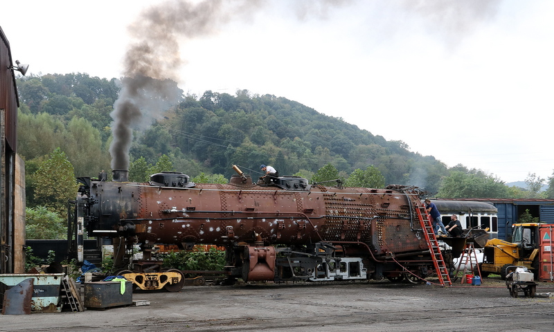

#1309 under steam for a Fund Raising Dinner Train event for the #1309 Restoration - 30 October 2018

Uneducated, speculative question from me.
The photo shows 1309 supported on a shop truck at the smokebox. The boiler is supporting the weight of the rear cylinder block and frame. Normally, this would be the other way around. The rear engine frame would be supporting the boiler, along with some weight distribution to the front engine.
Is this acceptable?

Something has to be supporting the rear frame (hidden by steam). Is the trailing truck in place? Given the weight of a full boiler, I hope both frames are on blocking.

The boiler is plenty strong enough to support its own weight and the weight of the water inside. The trailing truck is in place and supporting the weight of the rear of the locomotive.

The contracting company and the individuals who have been working with this specific project have worked with dozens of steam locomotive restorations, overhauls, and operations on many of the most visible engines working in modern service. Many of the same practices used by the various railroads in the maintenance of these great engines is applied daily in their rebuilds. These machines aren't so delicate that they can't handle shop trucks, overhead cranes, test fires, being driver-less, etc.
The railfan community's support of and commentary on these restorations, overhauls, and operations is appreciated. The world of tourist, scenic, and historic railroading sometimes allows for thorough historic accuracy, but often requires modern mechanics, equipment, and interpretation in order to earn revenue to continue steaming. More important to the long-term future of these locomotives will be the ability of businesses/organizations to continue attracting families to ride and new talent to learn about the past.
