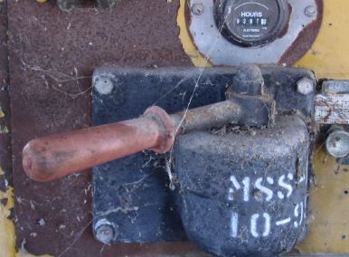

I would like to thank all who referred me to Multi Service Supply to help identify the air valve. According to them, it is either a SA9 or A9 valve. Apparently the are 2 air valves-this one is for the locomotive, and the other , an SA2 is for the train.

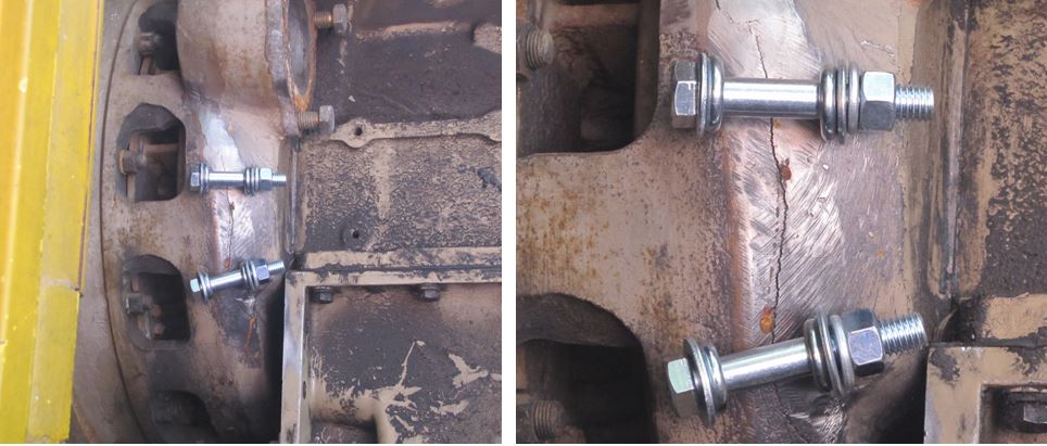

We got the bolts in on the right side of the bell housing. Drilling was harder than we anticipated, but tapping was a lot easier. The taps are brand new and sharp. Next time we are there we will do the left side.

I've been watching this thread out of curiosty since I know nothing of GE critters. However, those cracks concern me. You have to ask yourself why the bell housing cracked. Poor maintenance procedures? Loose bolt(s)? Bad alignment? Inadequate support for the modifications causing undue stress? An unlikely bad casting? Knowing where the cracks are in relation to each other may offer a clue as to the cause. As mentioned previously, alignment and rigidity are crucial. The bell housing is no longer rigid and bolting through the crack, IMHO, isn't rigid enough. Bolts are elastic and should be sized accordingly. Not to mention that drilling and tapping removes material needed for dimensional stability. And you have to calculate if there's enough meat for the hole and bolt or it may break out when you torque the bolt. If things move around, even the tiniest amount, in ways they're not supposed to, then you'll eventually have a much bigger problem....
To be safe, I'd vote for another bell housing. I dunno, maybe I'm being an alarmist?

I appreciate your comments. We believe the cracks were caused by the fact the rear of the engine was not supported, but depended on the bell housing. Over time the strain cracked the bell housing and caused the shaft to bind.
We first jacked up the rear of the engine, and the cracks closed up. We then installed supports on the rear of the engine.
We were also able to manually turn the engine. We had previously removed the injectors to be cleaned and re calibrated, so we had no compression to work against.

Bowmore wrote:
I appreciate your comments. We believe the cracks were caused by the fact the rear of the engine was not supported, but depended on the bell housing. Over time the strain cracked the bell housing and caused the shaft to bind..
If this was true, then you would see this on every GE 25, 30, 44, 45 & 80 (center cab) ton switchers out there, along with most industrial stand by generators. All of them use the generator as the rear mount of the prime mover (along with your car/truck, the transmission is the rear mount of your engine). Either the housing has an inclusion (sand pocket from casting) or was damaged by previous owner. Probably reasons would have been rough handling during maintenance or uneven shimming.
I would highly recommend not even attempting to start the engine with that bolt arrangement, not enough stiffness. Even if it held for a test, you will develop a crack running from bolt to bolt in a very short time, as you have now concentrated all the weight and torque of the engine across those 4 points. Crack must be repaired or larger reinforcement must be welded/brazed onto the housing.
I hope you find a better solution. Please for you safety and the life of your critter, now you have the crack secured, pull the engine and bring the housing to a welder that can fix it properly or find a replacement.
