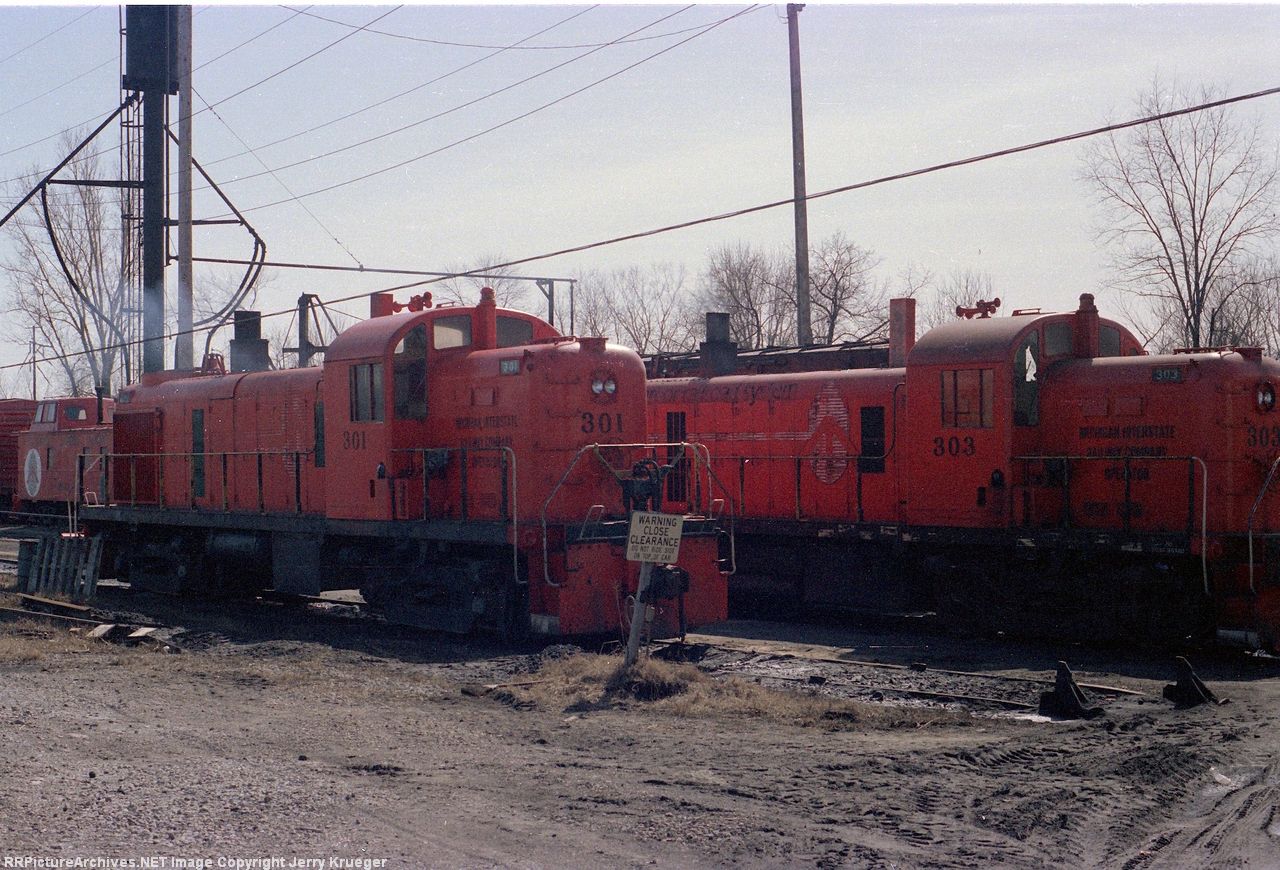

Contrary to some belief, unfortunately none of the Ann Arbor's RS1s were ever fitted or re-built with steam generators. According to Alco, RS-1s in general were limited to two options: one with boiler fitting or simply a plain hooded unit to which the AA selected the latter. However in the 70s the AA did end up purchasing two ex-GB&W RS-2s which to my recollection were as-built with boilers for passenger service. Though the GB&W never got to actually use them (P.S. ended in 49) it's said that AA on rarity did use the units for occasional business car heating. I'm not entirely sure though if any excursions were run with steam heat. As of today both units #301-303 are formerly rostered by the SMRS and kept storage in Minnesota with one scrapped.

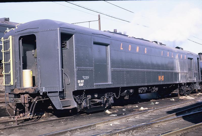

Doing some looking around I recently found out that ex-RDG steam generator car #92100 is still lurking in Holban Yard, Queens. The LIRR purchased it from the Reading in the 50s to heat passenger cars awaiting service in the Morris Park shops. Apparently the railroad is continuing to use it as an office despite steam heat being a relic of the distant past. I'm not sure if it still retains its steam gennies but certainly it is holding up for the better.
