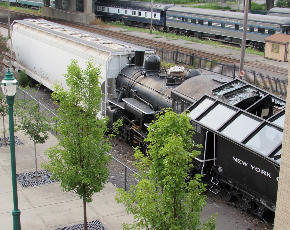

Here are additional pics from tonight:
 Post subject: Re: NYC 0-6-0 damaged in runaway incident
PostPosted: Sat Jul 25, 2015 8:15 pm
Posts: 217
And another:

Closer views of the damage to 6721 & its tender plus a view from the passenger walkway:

So what happened to the bumper? Is it under the hopper somewhere, or did it get pancaked between the hopper and the engine's pilot beam?
