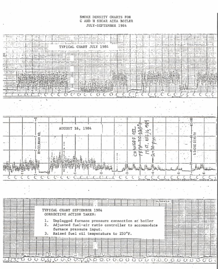

What I have noticed with motor oil burners is that nobody bothers to heat it. A standard loco drooling burner/atomizer is looking for fuel the viscosity of water. Motor oil/french fry oil needs to be the about 120F to be that fluid. Mix in some 90W gear oil and the required temp goes up.
High viscosity oil fed to a loco burner may not necessarily create a smoke situation but full droplets of oil will go through the flame front unburned and out the stack.
Fundamentally, the atomizer can't do its job if the oil is too thick.
The attached chart shows a 15 year smoke problem resolved. The boiler was looking for 180F #6 oil AT THE BURNER. The oil heater was set to 180F about 300 feet away. This was a 300psi/50Klb/hr B&W water tube boiler.
