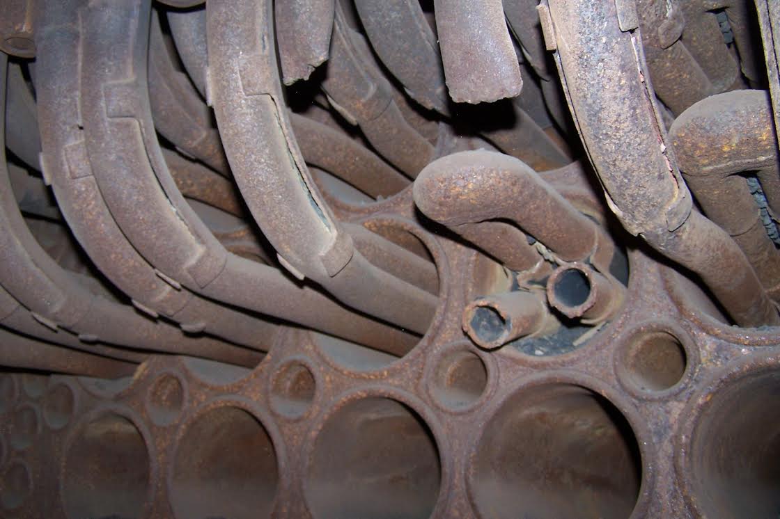

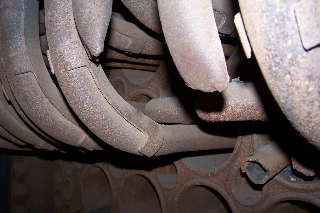

Posts: 1182
Since we're on the subject of boilers and superheaters here, I thought I'd just toss out these two photos. These were taken Saturday on PRR No. 460, the famed Lindbergh Engine at the Railroad Museum of Pennsylvania. I've heard of leaking superheater units being pinched off, but I've never actually seen it before. From what can be seen, the offending unit was torched off and the leads into the header were flattened. This poor engine was rode hard and put up wet, with evidence of quite a bit of leakage around the header -- lots of lime deposits around the bolts. Many of the valves in the cab also display substantial deposits, including the try-cocks. The superheater flues and the boiler tubes have a lot of cinders and dirt in them, too.
