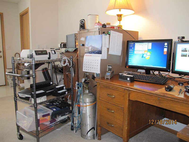

This is me hard at work scanning slides, the scanner has a 50 slide tray in progress and several trays ready to go. Now where is my blanky, it's nap time.
-Hudson

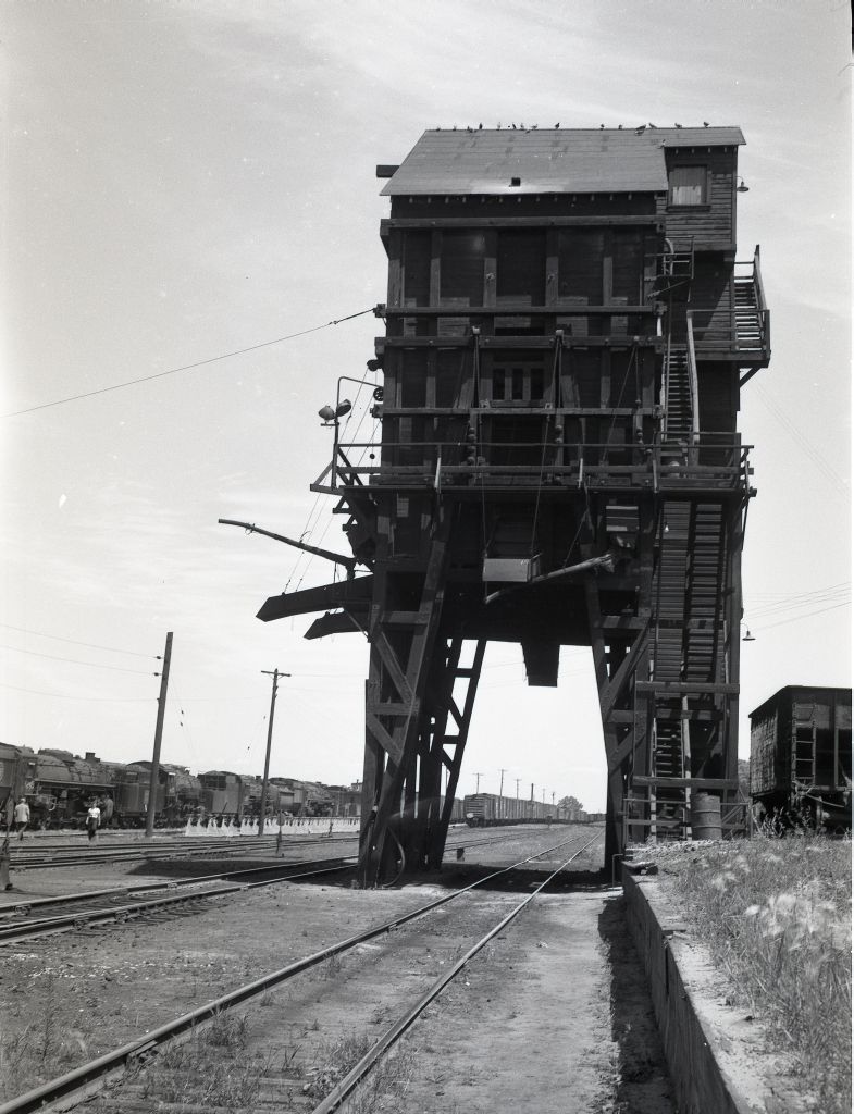

I can't put my finger on one of my Chione scans at the moment, but here are 2 pics done on my Epson V600. The CN Fort Erie coal tower is from a B&W negative, the CP at Niagara Falls is a standard slide. Minimal editing, mostly because Im not that familiar with the whole editing process. I do like the Epson V600, easy to use and can scan a variety of different types of images.
Ken Jones
Niagara Railway Museum Inc.
www.nfrm.ca
File comment: Canadian Nationals Fort Erie coal dock was torn down in the 1960's and replaced by a much smaller conveyor set up.
