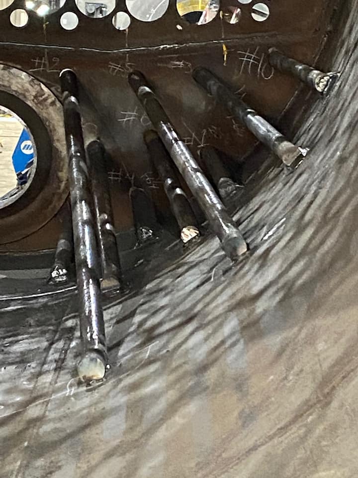

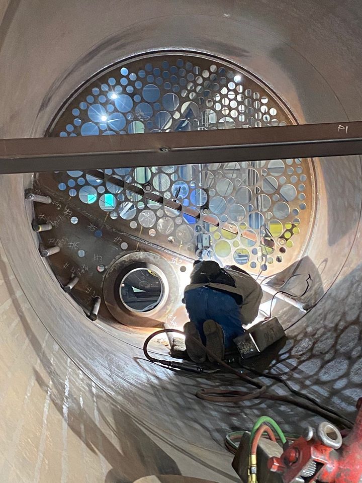

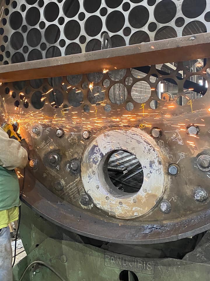

From the T1 facebook page today (I continue to be astonished by the size of this boiler): "Here you can see the latest pictures of the stays holding the front tube sheet in. (Long round bars) They have been welded in. This strengthens the flat area above the tubes when the 300 psi boiler is at full pressure. In the picture, the boiler is upside down right now. This makes welding much easier and faster for the boiler makers. Photos provided by Tom G. at Continental Fabricators."

Note the Pandjiris roller support in the last picture, which facilitates easy 'rolling' of cylindrical vessels for downhand/submerged-arc welding. This company has been in the business since 1946, and remains one of the primary sources for the specialty equipment appropriate for easy fabrication of large welded locomotive boiler shells.
