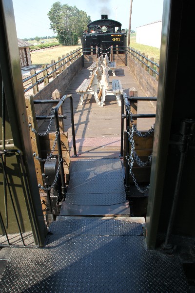

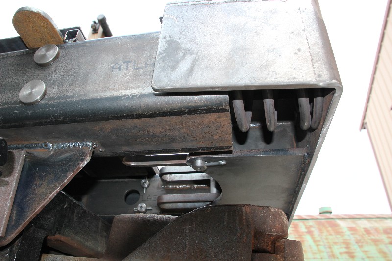

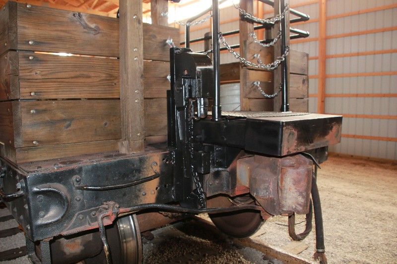

Monticello Railway Museum's version is built on an ex-NKP flat car. We re-decked the car with treated 3 x 12 bridge timber (the kind used on road bridges that have wooden decks). The posts utilize the original stake pockets on the car, and are 4 x 4 treated posts. The sides are 2 x 10 treated lumber, bolted to the posts, and topped with two handrails made up from pipe.
The buffers are indeed based on a Miner buffer arrangement, of which we have one example, on IC Baggage car 518. As Bulby noted, its made up of plasma cut parts and available shapes welded together and bolted to the car. I like what NCRY did with their buffer arrangement. Simpler than ours, and I particularly like the partial tube diaphragms. We're using chains. In our case, the car is usually coupled to our Rock Island commuter car, which was never equipped with diaphragms, but used chains instead.
Our intent wasn't so much to allow folks to go between cars while moving, but to get away from using the kluged up "bridges" to get from car to car. Putting them in place required stopping, manhandling them in place, then back again before you depart. That made for a pretty high hassle factor for our volunteers. Nor was it ever convenient when a summer rain would spring up mid-trip, and folks want to get out of the rain. The car is fairly popular, particularly when steam is pulling the train. Most seem to prefer to stand, but there is a limited amount of bench seating in the car.
File comment: Buffer parts being test-fitted.

File comment: Completed buffer, and upgraded handbrake.

Again, after seeing what Niles Canyon did, their arrangement looks simpler and just as effective.
