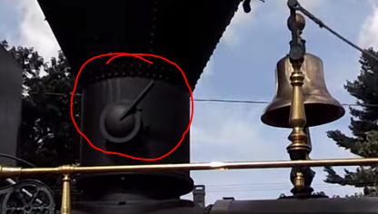

 Post subject: What is this?
PostPosted: Tue Mar 24, 2015 7:51 am
Posts: 231
What function does this perform?
Is it connected to a screen or damper inside the stack? Look in different photos and it's in different positions, as far as the "handle" is concerned...

It is to clean out the cinders caught in the stack. They are thrown centrifugally outward towards the funnel, then drop down allowing the exhaust to pass up and out by a cast whirl in the top of the funnel.
dave
 Post subject: Alright, then...
PostPosted: Tue Mar 24, 2015 9:29 am
Posts: 231
Is there a screen on the top of the stack, or is the screen on the other end of this handle.
When do the cinders exit the locomotive? Do they stay down in the smokebox and need to be cleaned out manually, or what?
