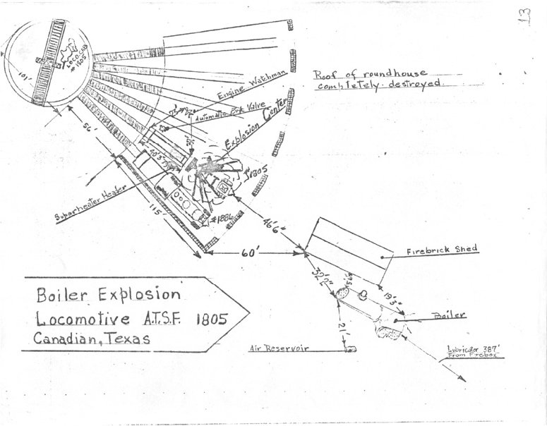

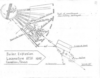

INTERSTATE COMMERCE COMMISSION
REPORT NO. 3396
Accident (boiler explosion) at Canadian, Tex., on April 1, 1951, caused by overheated crown sheet due to low water.(LINK)
"Measurements of the line of demarcation transferred to similar points on a locomotive of the same class indicated that the water had been 6 inches below the highest part of the crown sheet."
"The force of the explosion tore the boiler from the frame and hurled it through the roof of the enginehouse and forward. The boiler in its flight cleared power lines 32 feet above the ground and 95 feet forward and alighted in reversed position on its right side and back head, striking the ground 119 feet forward of the point of the explosion and making a depression 4 feet in depth and 12 feet in diameter."

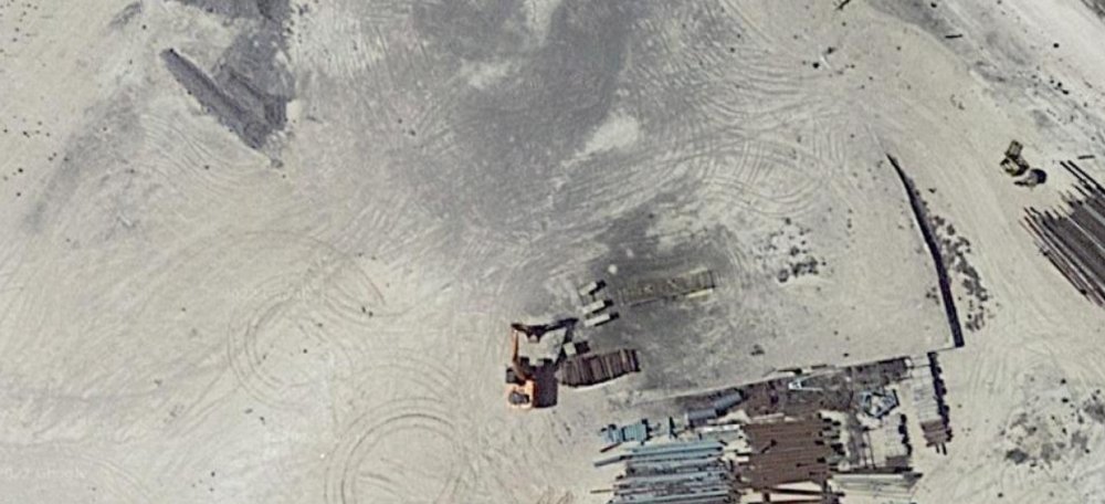

Current Round House location:
