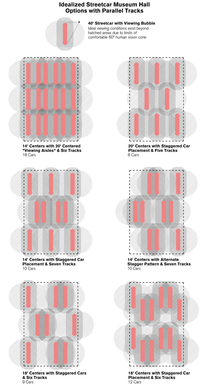

Okay, one more post for the night. Here are some of my thoughts made visual. The following diagrams are a bit underdeveloped, and would only be applicable to the display of streetcars. The principles might be applicable to the display of other rail equipment, but you can see how individual streetcars lend themselves to a staggered distribution on evenly-spaced tracks. Each streetcar is surrounded by two hatches. The inner hatch shows how far away you need to be to see the car from trucks to roof. The wider hatch shows how far away you need to be to see the whole car from end to end.
A museum building's layout should really be designed based upon the historic narrative the institution is committed to telling. History museums are a form of physical story telling. The path though the cars and their sequence should be used to tell a well-constructed series of stories about the cars and the people that rode them, ran them, built them, and maintained them. This approach should really be the driving force behind developing any kinda of museum plan. These diagrams are just an attempt to explore the implications of spreading the equipment out a bit more, but something like this could form the basis of a more highly-evolved streetcar museum. This strategy improves viewing and to creates a variety of spaces amongst the cars for different exhibits and activity spaces.
As I mentioned previously, it would be worth exploring other options with curved and non-parallel tracks. Free span buildings, and a commitment to leaving space open for viewing and exhibits makes this possible. This is not about packing in cars, it is about trying to design a building to pack in people. A facility such as this could also produce revenue as an event location as many museums now do.
File comment: Hypothetical Hall Layouts
In case you are curious, the car I traced for the drawing is a Pacific Electric 500 class wood suburban car.
