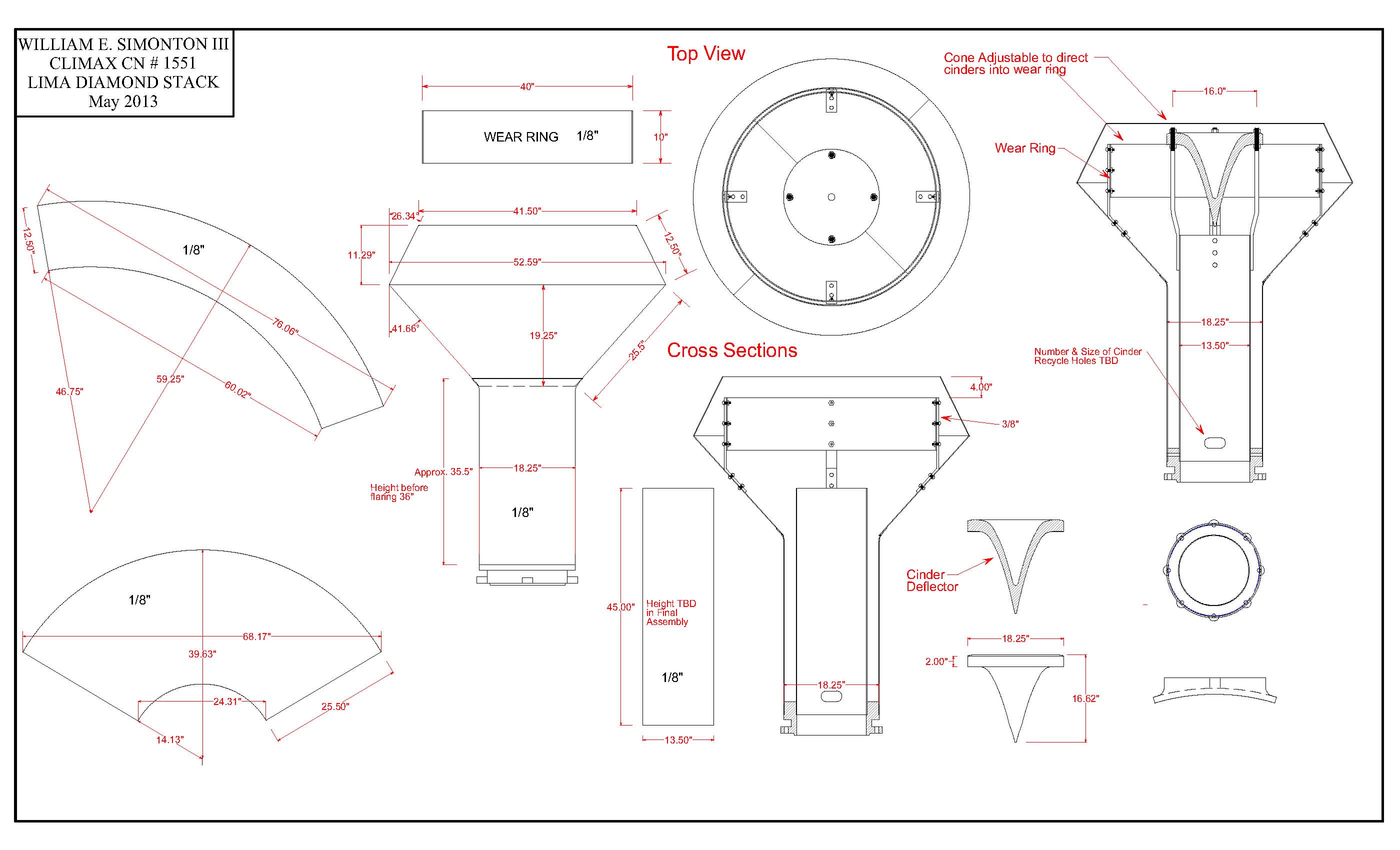

The following drawing of the Diamond Stack to be used on Climax CN 1551. The Cass Scenic Railroad required that a Diamond Stack be used on CN 1551. The Cinder Deflector was pulled from the junk pile at Cass and was originally intended for a Shay.

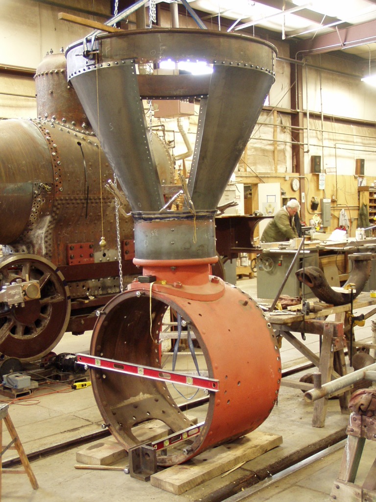

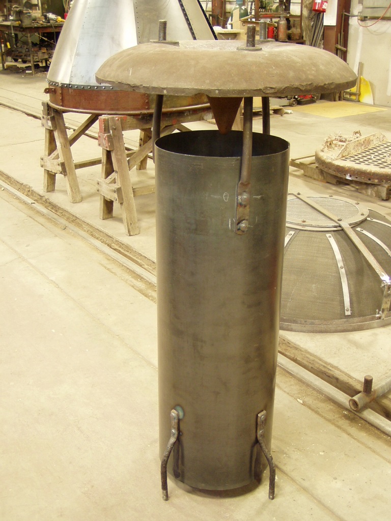

Three photos of an 1875 Baldwin narrow gauge locomotive stack undergoing restoration.
The first image is the funnel (cinder trap and collector) being fit up preparatory to riveting. The top ring with half round was saved from the original stack as was the hardware. It can't be said the ring is positively original to Baldwin but if not it is an early replacement.
The second image is the stack with cast iron deflector (original Baldwin) and threaded supports (believed to be original) and threaded hold down fittings (believed to be original). This is the stack through which the products of combustion are initially conducted. The screen is behind and to the right. Some parts of which are early or original. To the left is the funnel upside down of saw horses.

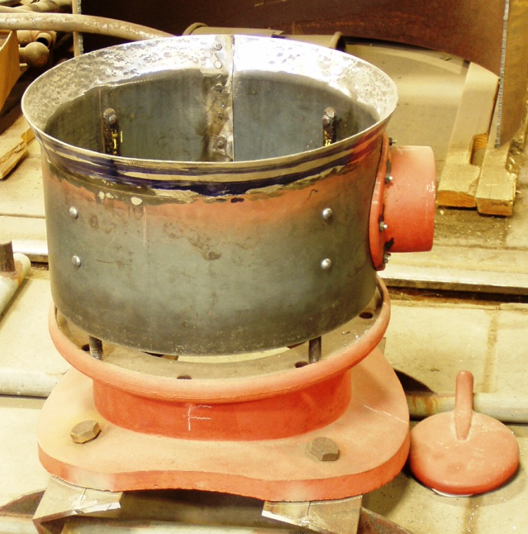

The third image is of the cast iron base with funnel base and clean out. The clean out casting is a reproduction. The cast base is original and hold downs are believed to be so. There are eight holes in the base casting. Four are for the funnel and four are for the stack as seen in the second image.
As Mr. Sullivan pointed out these clean outs aren't worth much and we clean out our wood burning stacks by removing them from the locomotive and power washing the accumulated ash out. The new sheet metal was replaced because of deterioration of the original fabric.
This stack belongs to CTL&F locomotive Glenbrook, a Baldwin 2-6-0 narrow gauge, currently at the Nevada State Railroad Museum.
In reference to the first posting on this subject we decry the misuse of the balloon stack, in part, because a deflector isn't incorporated and so a straight column of smoke issues out the top of the balloon. It looks particularly stupid. They are also indiscriminately applied to locomotives upon which they do not belong.

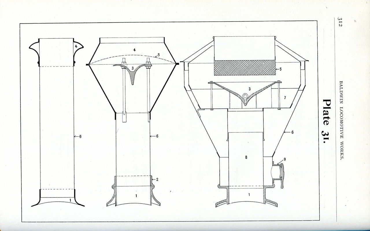

Here is a figure that may be of interest in this discussion, taken from an 1897 Baldwin catalog I recently acquired.
I don't know how many diamond stacks (center) were actually being sold in 1897, but they were apparently still available as a catalog option even at that late date.
