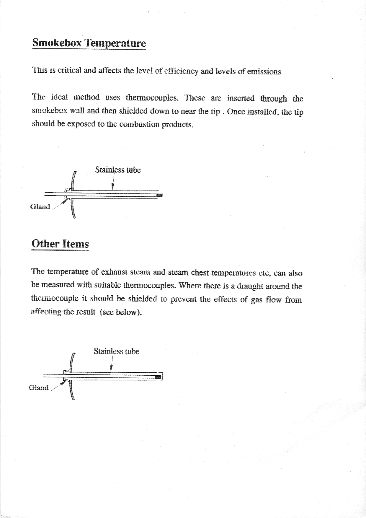

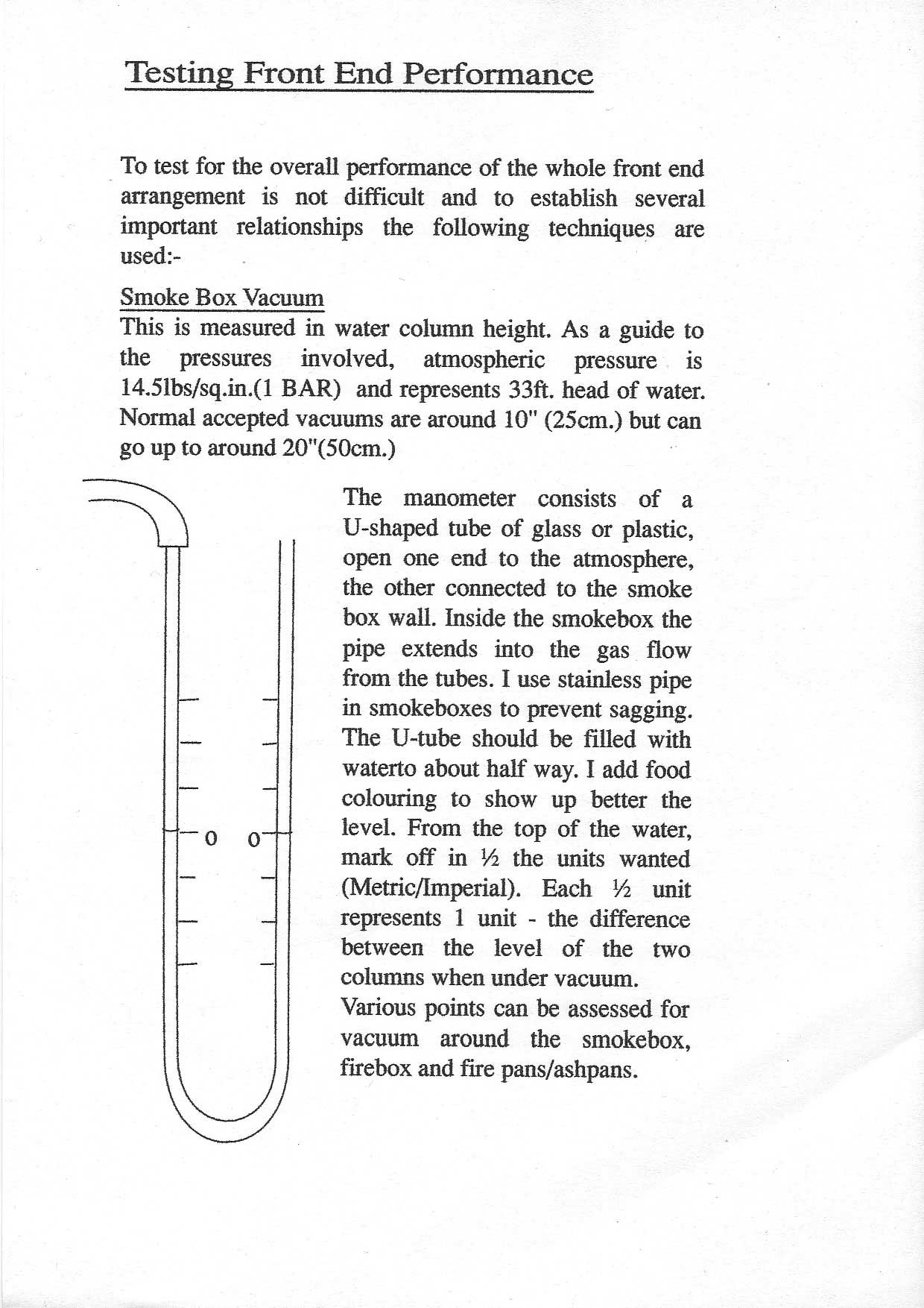

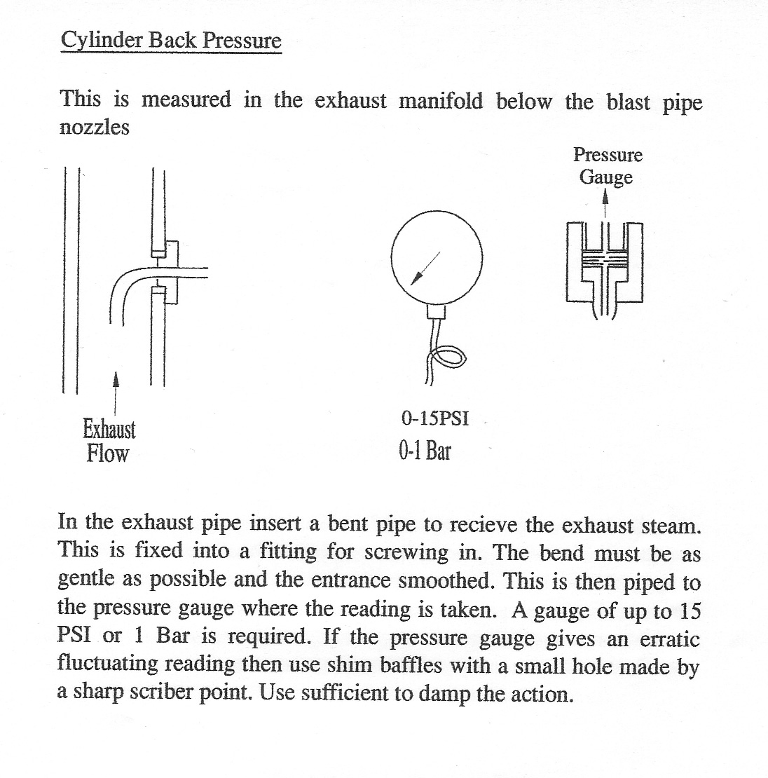

From Nigel
File comment: Cylinder Back Pressure
File comment: Smokebox Temperature
File comment: Testing Front End Performance

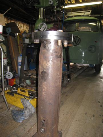

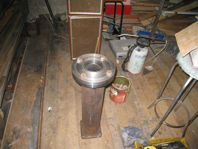

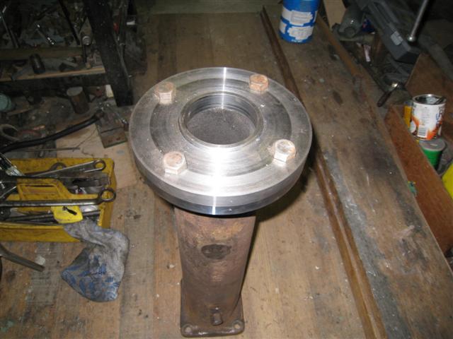

Yesterday work started.
I have been successful in getting our local Technical College to machine the nozzles.Hopefully work will start on them next week.
Yesterday I machined the nozzle flanges that fit on the blast pipe from steel plate at my mates workshop. Hes very good, donates materials, his machinery, will do the welding, I guess he will enjoy a carton of beer.
With luck I will start cutting out the diffuser and mixing chamber.
Attached are images of the flanges test fitted on the blast pipe stand

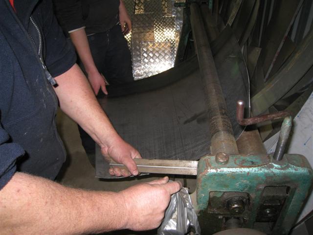

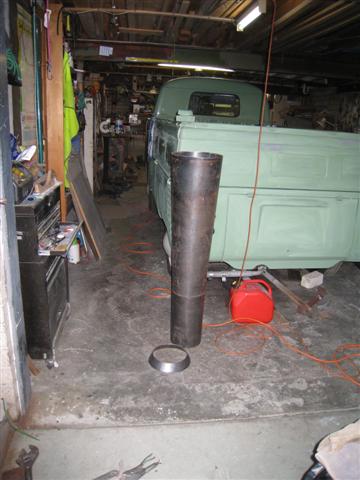

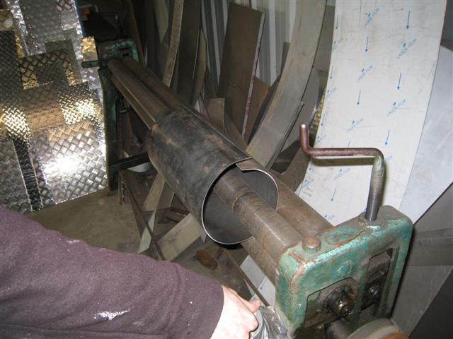

Progress is being made with the chimney components being rolled and welded.
The next step it to take the Diffuser and Mixing chamber back to the rolls to roll them round because the long edges slightly flatten along what will be the welded seam when they came out of rolls.
Hopefully I will get an update this week about the machining of the nozzles.

File comment: Mixing Chamber and Diffuser being tacked together.
File comment: Fowler Diffuser being rolled
File comment: Fowler Mixing Chamber being rolled

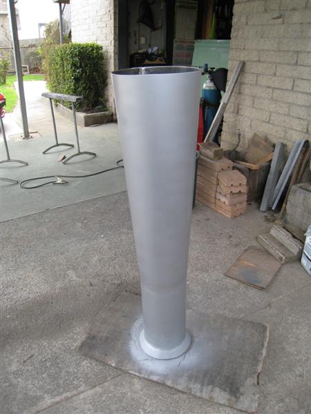

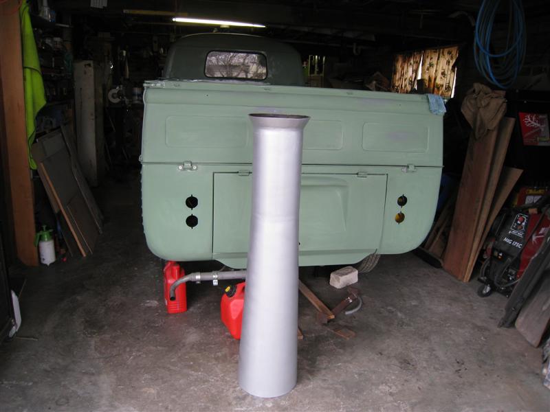

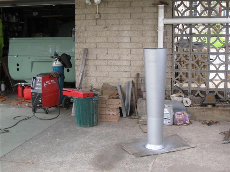

The Chimney Insert complete.
File comment: Chimney insert showing flared end
File comment: The most difficult part of the welding was the fitting of the flare.
File comment: Chimney insert completed and painted
