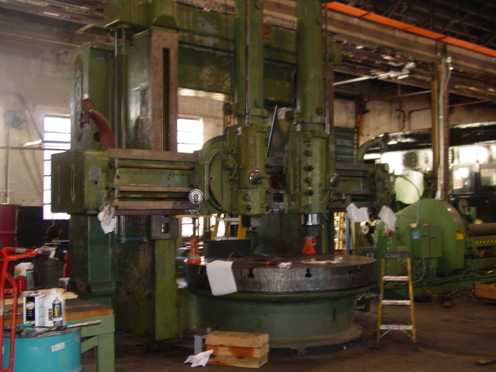

The vertical bore machine is being assembled and should be operational soon.

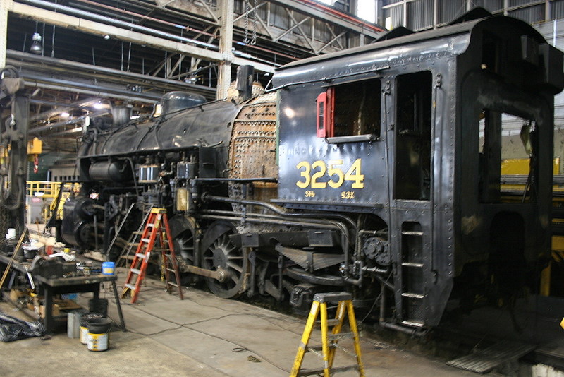

#3254 is having some staybolts removed, and some other stuff, as part of some maintenance they're doing.
File comment: #3254, having some work done.

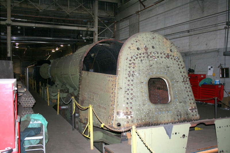

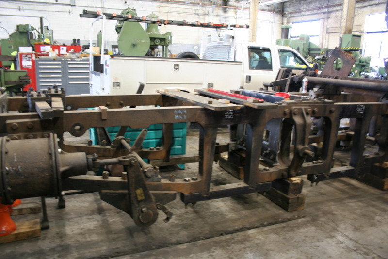

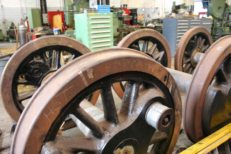

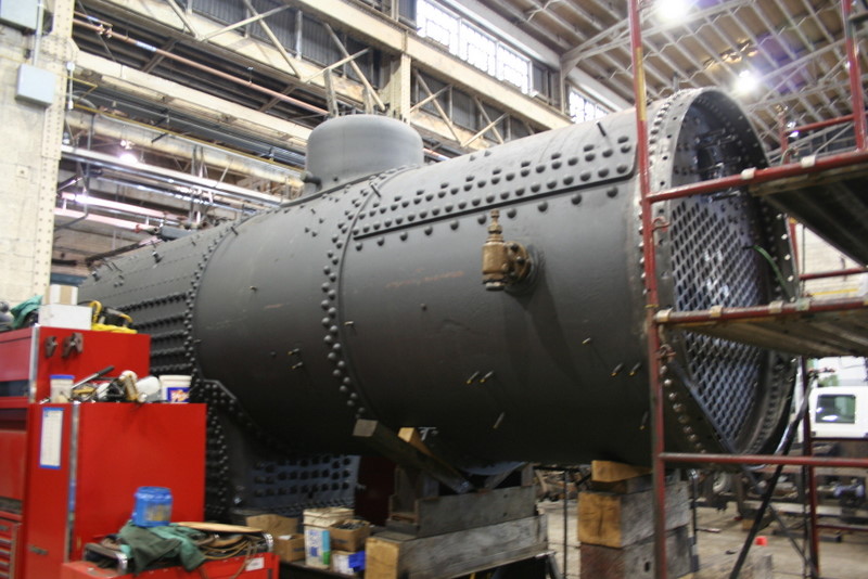

Yes, they're still working on #26. Her boiler and running wheels look very nice. Hopefully (not the official word from Steamtown) she'll be out later this fall (according to the Ranger who gave the tour).
File comment: #26's boiler looks great!

File comment: #26's frame being worked on.
File comment: Drive wheels for #26 - also looking good!
