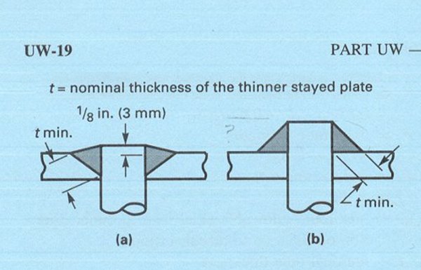

Mr. Janssen;
You have stated correctly that A.S.M.E. Section VIII does allow fillet welded staybolts, however there are a few things overlooked in that statement. In Section VIII UW-19.3b, a fillet welded bolt is shown, however it must have a minimum throat thickness of "t", which is the thickness of the plate being stayed. In Section I PW-19.3, it states that the staybolt shall not project more than 3/8" beyond surfaces exposed to products of combustion, and Section I PG-46.2 states that the minimum plate thickness of a stayed sheet is 5/16". To do this weld per Section VIII, the projection of the staybolt would be at least 0.442", which is not allowed by Section I. As the firebox sheets get thicker, it gets worse, with the projection of the staybolt being 0.707" minimum for a 1/2" thick firebox. The key point to remember is that Section VIII applies to unfired pressure vessels, and Section I applies to power boilers.

It is always interesting to see ones references (or apparent single reference in this case?) to an idea. The English edition of the book La Locomotive a Vapeur discusses both the Czech and the American approaches to the welded boiler and they are different. Not the least of which was the heat treating of entire boiler which was the American practice. But the problem with studying historic technology is the fact technology does change with time. As stated in the book, The Procedure Handbook of Arc Welding published by the James F. Lincoln Arc Welding Foundation “The art of welded steel design has been evolving gradually, with all the errors that normally accompany an evolutionary process.” To that end the first edition was printed in Sept 1933 and they have had several additions since including May of 2000. Given that scope of time I assume they have seen a few changes to both welding theory and practice.
The issues here are not of a simple nature. Consider that the American Welding Society (AWS) has established that the allowable shear value for weld metal in a fillet or partial-penetration bevel grove weld at;
T= 0.30(electrode min Specified Tensile Strength)
And they have proved this equations validity with a series of Fillet weld test with a series of fillet weld test conducted by a special task committee of the American Institute of Steel Construction (AISC) and AWS. For the record the welds described in The Procedure Handbook of Arc Welding are a T intersection similar to the installation SP used on 2-8-0 3420’s front tube sheet and a stress riser situation.
Before I move on I want to define the term Allowable. “Allowable” weld strengths are specified by the AWS and AISC and various other engineering and governmental organizations to make sure that the weld can deliver the mechanical properties of the plate being joined. Allowables are designated for various types of welds under steady and fatigue loads.
Consider the following paragraph from The Procedure Handbook of Arc Welding pg 2.3-2, “The existence of tension forces transverse to the axis of the weld or shear in any direction, Figs 2-122e and 2-122f (T intersection fillet welds and stress riser fillet welded plate) requires the use of weld metal allowables that are the same as those used for filet welds. The selected material may have mechanical properties higher or lower than those of the material being joined. If the weld has a lower strength, however, its allowable must be used for calculating weld size or maximum allowable weld stress. For higher strength weld metal, the weld allowable may not exceed the allowable of the matching weld metal for the metal being joined. The allowable used shall not exceed the shear allowable of the plate.”
The next question in my mind that needs to be answered is what type of loading does a locomotive boiler experience and in what environment. A locomotive boiler undergoes a lot of cyclic loading particularly in this weekend only type of operation that many locomotives see today. A 200 psi boiler can go from ambient temperature to 390F and a 300 psi boiler will reach over 417F according to the Marks and Davis tables. Given that in some engine houses that ambient temperature can be well below freezing it shows just how much a temperature swing boiler has to endure just at start up. Then add fluxuation of both temperature and pressure due to crew inexperience (and/or inadequate/misguided training) and other issues and a boiler can undergo a lot of stress and strain. Water treatment is another area of little understanding that has a great influence on boiler life.
The Procedure Handbook of Arc Welding speaks about allowable Fatigue strengths of welds. “The performance of a weld under cycles of stress is an important consideration in structures and machinery and the specifications relating thereto have been developed after extensive research by the AISC. In the case of a complete-penetration groove weld, the reinforcement and any undercut, lack of penetration or crack will act as a notch, which interns act as a stress raiser and results in a lower fatigue strength. The very nature of a fillet weld, because it is used in lap and tee joints provide an abrupt change in section that lowers fatigue strength.” I specifically included the potential limitations of full penetration welds because we understand how to overcome these deficiencies which by design can not be overcome with a fillet weld. The AISC has fatigue specifications that cover a wide range of welded joints and the fatigue strength of members attached by welds.
Let us consider the issue of cracking. The major cause of cracking in the base metal or weld are high carbon resulting in increased potential for hardenability, high cooling rates, joint restraint, improper weld bead shape, hydrogen pickup and contaminates on the plate or electrode.. Everybody’s favorite Iron-Carbon phase diagram tells this story for the issue of both carbon content and rapid cooling rates.
The bottom line in any tourist RR is cost. Fillet welds are easy to apply and require little or no plate preparation. They can be made using large diameter electrode with high welding currents and as a consequence the deposition rate is high. The cost of the weld increases as the square of the leg size. A double bevel grove weld has about ½ the weld area of a fillet weld. It does require extra preparation but it does use smaller electrodes with lower welding current to place the initial pass without melting through. While this first pass has a high initial cost of time per amount of metal laid as the size of the plate thickness increases the initial weld becomes a less important factor in the total cost and you find that eventually that full penetration welds are actually cheaper than fillets.
Now let me raise a concern of approach, in two of your post you have the following quotes quote “"What I do not understand is necessarily wrong." - Brazilian Office Theory - L.D. Porta.” and “"Know that what is not written down doesn't exist." - Livio Dante Porta”. A lack of knowledge has never been a defense in court. Many engineering mistakes have lead to significant loss of life due to a lack of knowledge that was developed only after a tragedy. Just because things were not known did not prevent tragic events from occurring. I strongly encourage you and anyone else to continually learn new things. To that end, the University of Idaho has a Materials Science Engineering program which may enlighten you.
