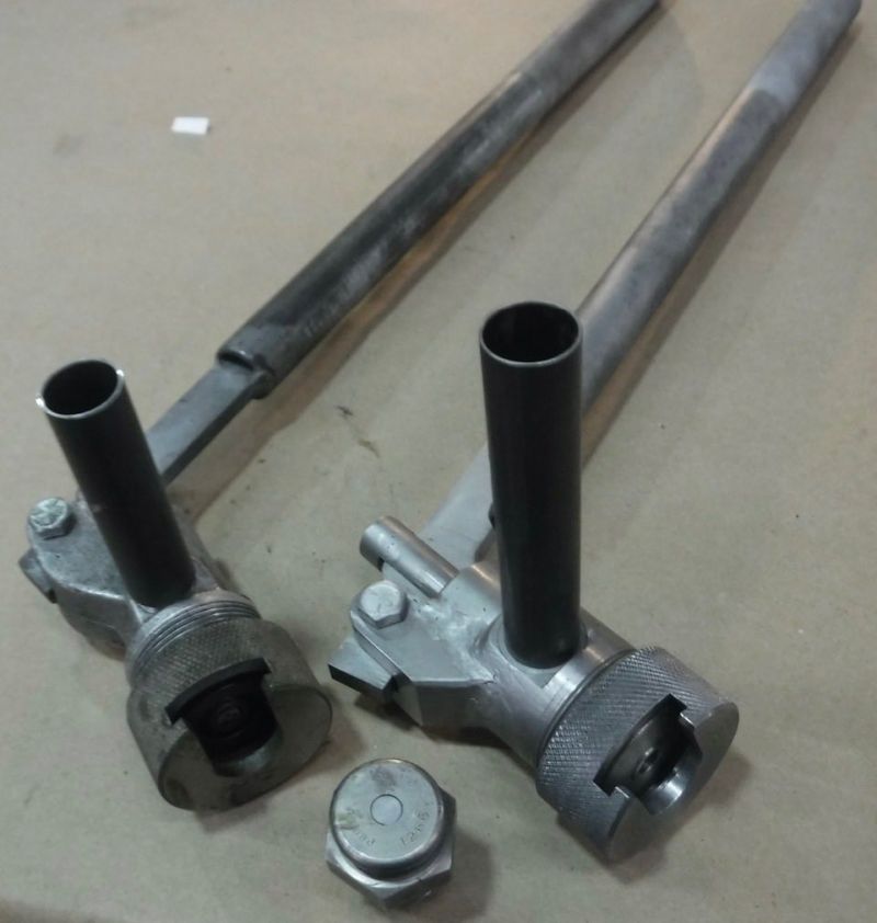

The difficulty in obtaining an Alemite grease gun for using hard grease to lubricate the rods is well-known.
We were able to acquire a manual version and gave it to expert machinist Lavern. The result, twins!

Those are very nice. Would your organization consider making and selling copies?

The builder is one of our volunteers and we are keeping him busy trying to return 557 to operation. To clarify, the one on the left is original, the one on the right is new.

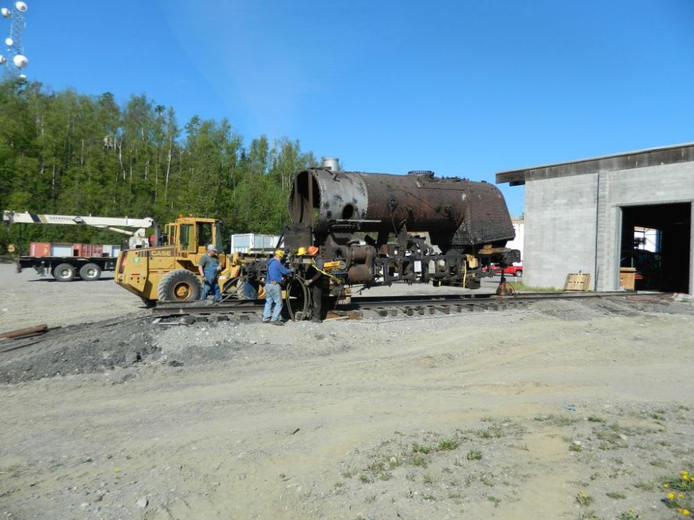

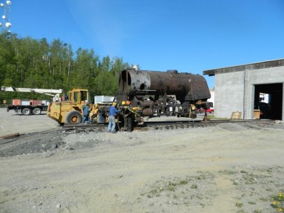

As another year comes to an end, it's time to reflect on where we have been, where we are, and where we are going.
Then and now, summer of 2014 and October, 2022.
The next major milestone is projected for the first quarter of 2023, when the installation of tubes and flues is projected to begin followed by hydro and possibly steam tests by the end of the year.

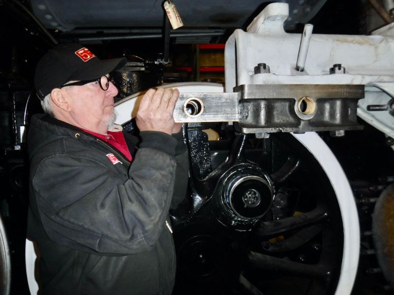

Trial fitting the valve crosshead.

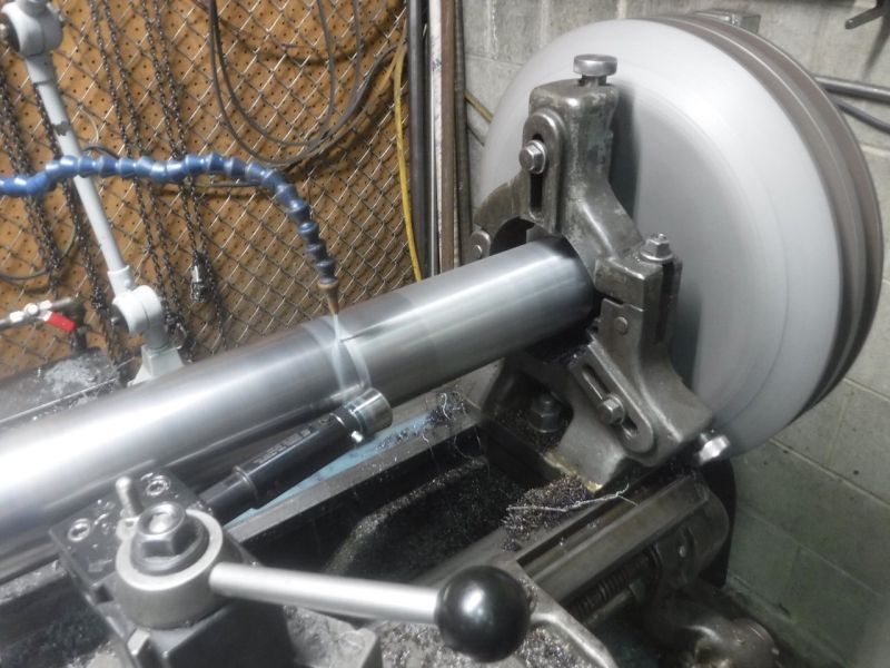

The January, 2023, status report has been posted at https://www.alaskarails.org/pix/former- ... index.html

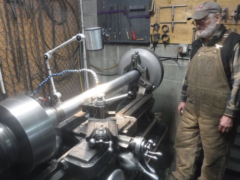

We were unable to find a local machine shop which could grind the badly pitted piston rods with the pistons in place. As shown in the photos, the volunteer shop crew again stretched our equipment and ingenuity to the max and got it done. They set up the rod and 19 inch diameter piston on our 12 inch swing, WWII vintage, Lodge and Shipley lathe where the rods were turned and roller burnished in lieu of grinding.

I had an older version of that Loose and Shaky in the Savannah shop - good lathe and very adaptable. Thanks for the stream of great news.

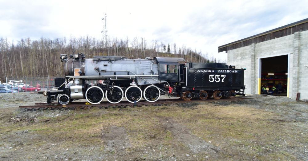

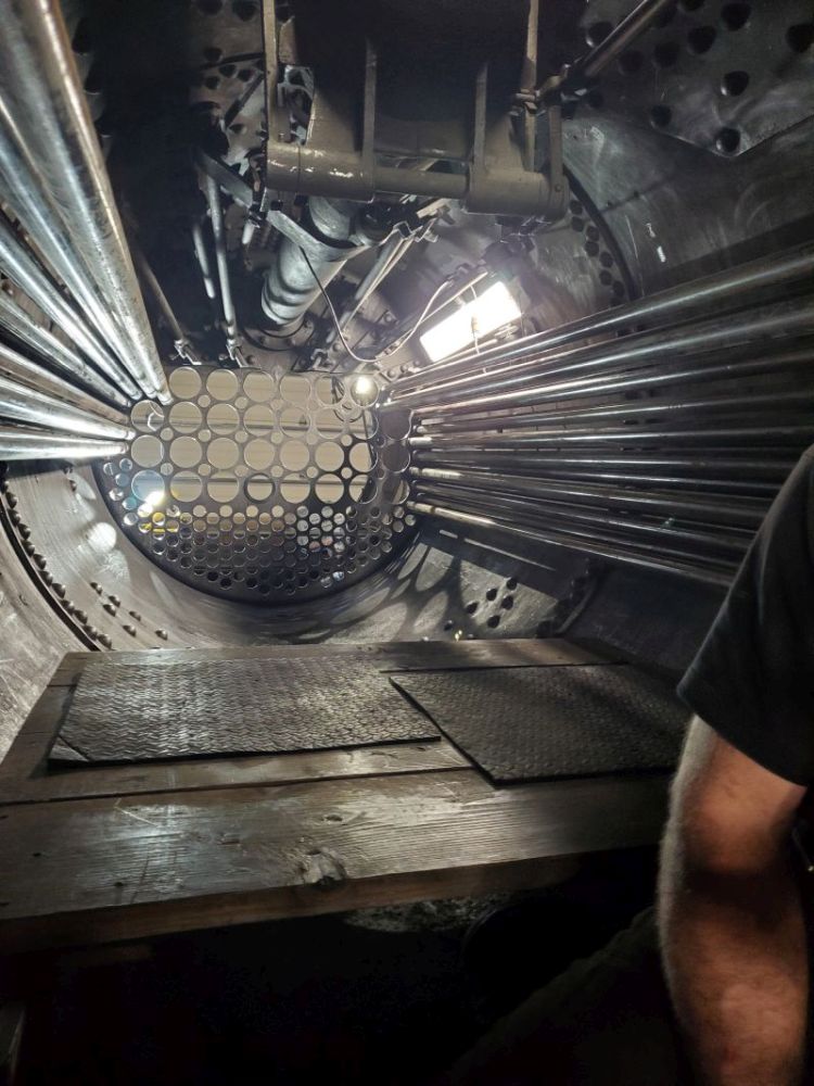

Game on!
 Post subject: Re: Alaska Railroad 2-8-0 #557 to be returned to service!
PostPosted: Wed Mar 22, 2023 11:16 pm
Posts: 706
Location: Anchorage, Alaska
The installation of tubes and flues is a major accomplishment and milestone in returning 557 to operation. Our thanks goes to the John H. Emery Rail Heritage Trust for a $36,000 grant, the Atwood Foundation for a $20,000 grant, Alaska Airlines for air travel for three boiler makers from the Lower 48 and the Valley Hotel in Palmer, AK for lodging for the them while they are in Alaska. It also goes to the team of volunteers who have been laboring for the past ten years and specifically during the last year in doing hundreds of tasks to prepare the boiler to receive its new tubes and flues and to the hundreds or individual and business contributors who have brought us to this point.
