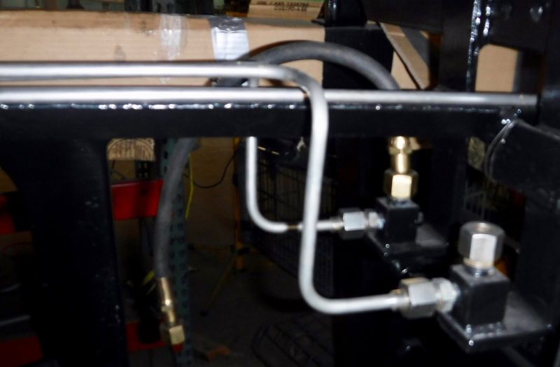

The latest status report is available at http://www.557.alaskarails.org/restore/index.html
New lubrication lines are being installed before the drivers go back under the locomotive and get in the way. 557 has the original two, 8-feed Nathan DV-4 lubricators, with one feeding the eight driver journal bearings and the other feeding the cylinders, valves, and front truck journals.
Today we had a rare cancellation in our four-day-per-week schedule. A snow day. It varied around the area, but I had to clear 13" from my driveway this morning.

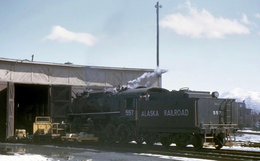

I'm pleased to announce that several nice contributions over the past couple of weeks have taken us to the end of the Engine 557 Restoration Company's $50,000 matching challenge grant, putting a total $100,000 in our coffers since the December. If someone missed a chance to contribute, we can't offer matching funds, but we would still appreciate your support at http://www.557.alaskarails.org/support/donate.html.

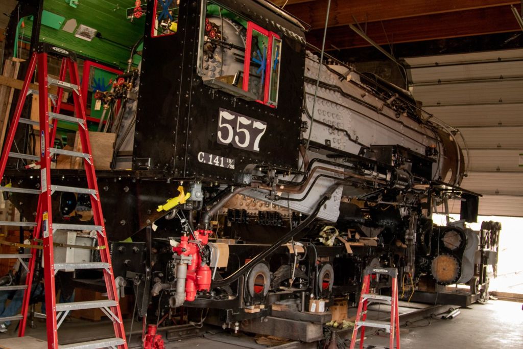

John Gray photo taken in front of the Anchorage round house.

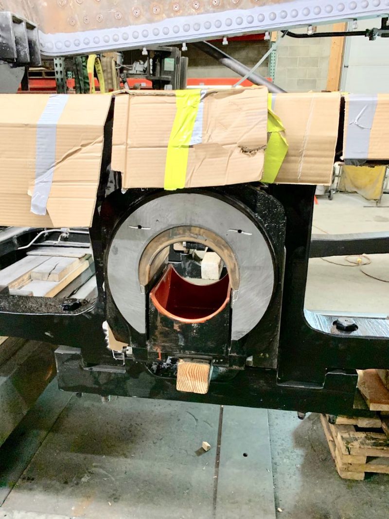

The most recent status report has been posted at http://www.557.alaskarails.org/restore/ ... index.html
With the trial fitting of journal boxes underway, it shouldn't be too much longer until 557 is back on her wheels.

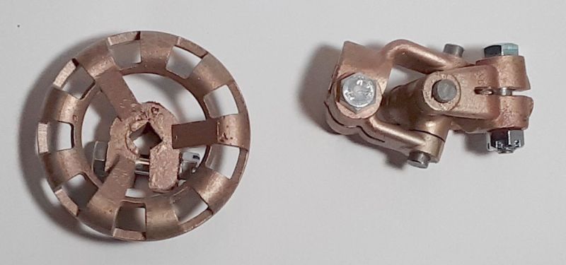

A new status report has been posted at http://www.557.alaskarails.org/restore/ ... index.html
Lacking universal joints needed to add additional valves to the turret, a replica Nathan #1 universal joint and 3" diameter valve handle were cast in silicon bronze in the Lilliputian Engine 557 foundry last week.

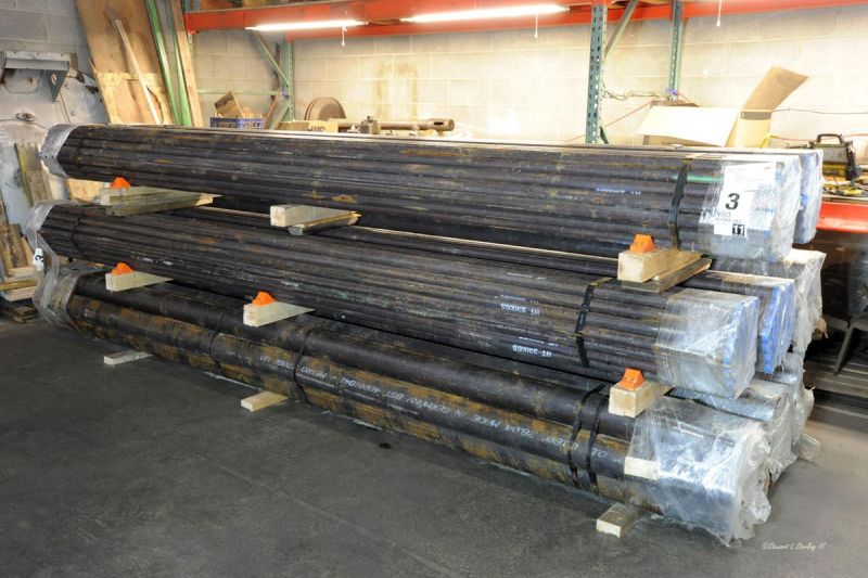

We are pleased to announce that the Atwood Foundation of Anchorage, Alaska is providing a grant of $20,000 to partially fund a contract with boilermakers from the lower 48 to oversee the installation of new tubes and flues. The new tubes and flues have been on hand for several years and we are projecting that the work will be done by the end of the year.

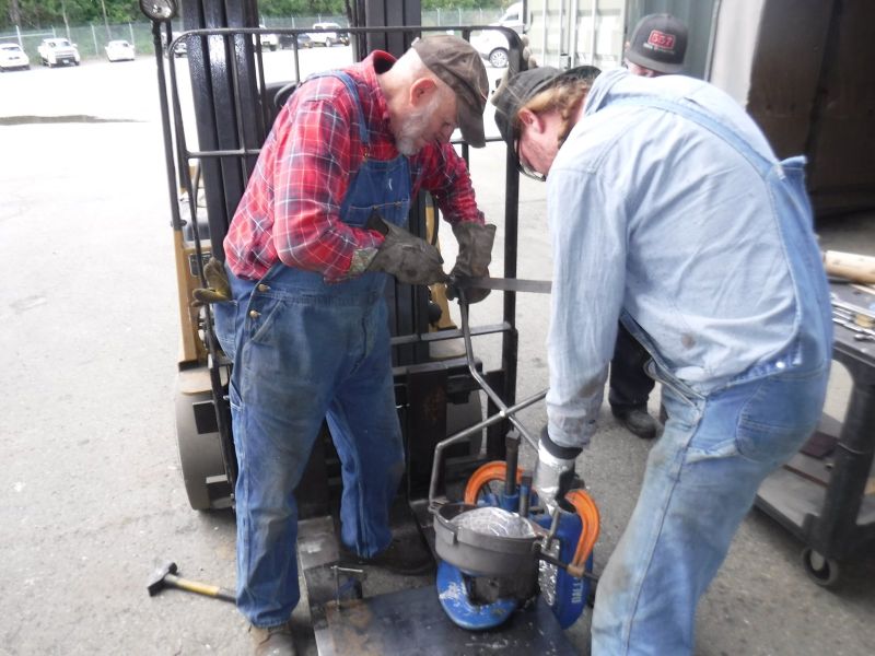

Another busy month is described in the latest status report at http://www.alaskarails.org/pix/former-l ... index.html. Included is a description of pouring a new Babbitt lining in the front truck bearings.
