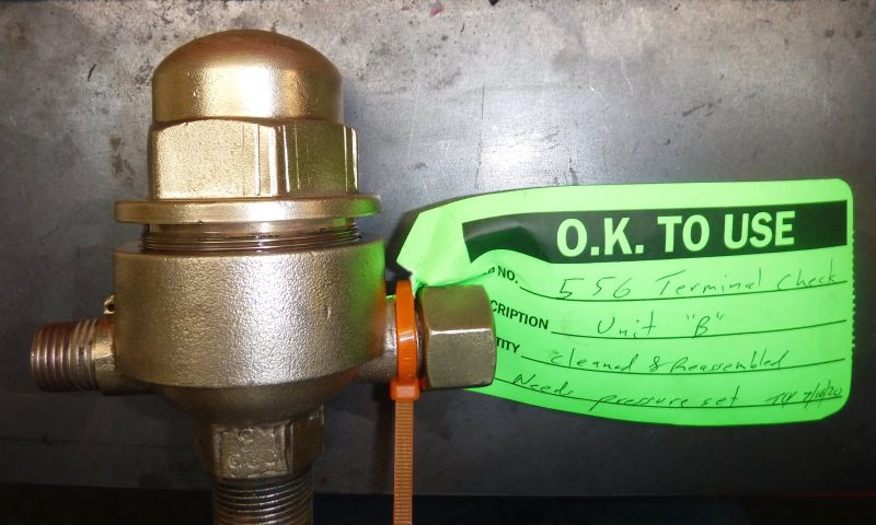

A lubrication system terminal check valve has been cleaned and inspected and is now back on the shelf, ready for the pressure to be set before installation.

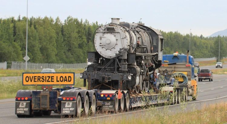

(I don't have a photo of the FRA visit, but here is one from eight years ago this month when the 557 was moved from Anchorage to Wasilla to begin her expected two-year long restoration.)
File comment: Eight years ago this month, 557 made her move to Wasilla where she was optimistically projected to be starting a two-year restoration.

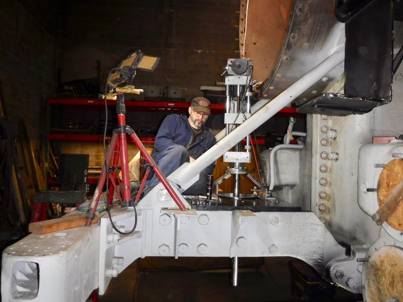

When we started disassembly, a number of suspension issues turned up. All the bushings were badly worn, there were broken spring leaves and a broken coil spring, and an oak block was wedged above the front right front journal box to prevent its movement. The front frame extension was bent upward, a bit higher on one side than the other. One result of the frame damage was that the guide for the front truck was worn lopsided. With the boring and sleeving of the guide, this final suspension issue is now corrected.

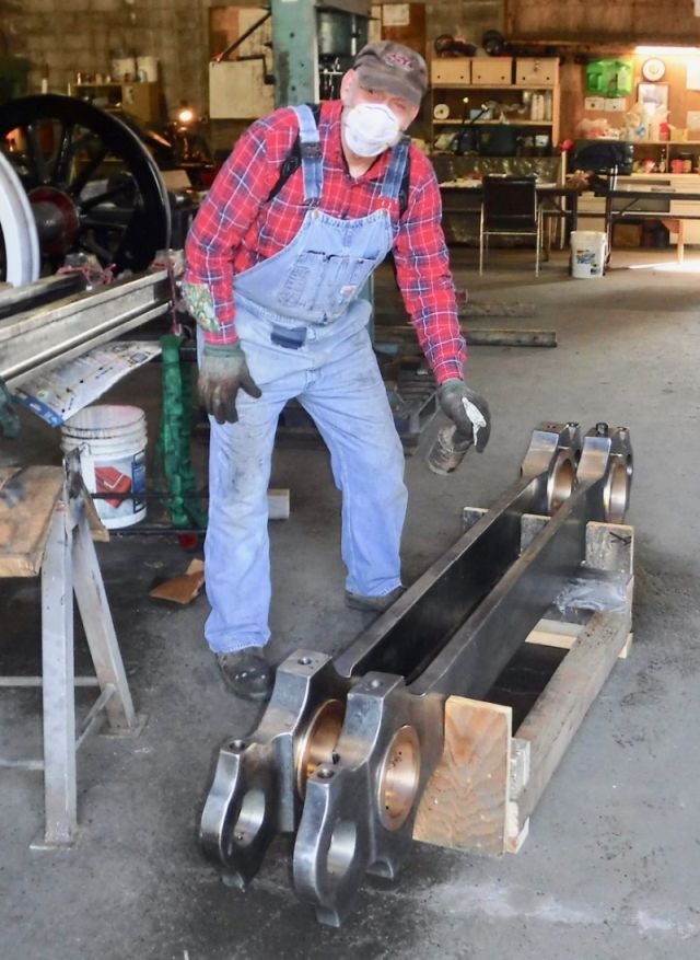

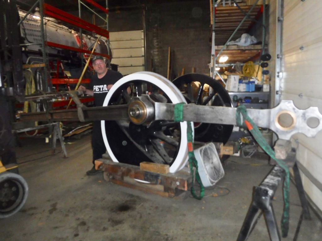

In the photo, a main rod and a side rod are being trial fitted to check the bearing fit. The drivers' treads and all journal surfaces were overhauled at Tennessee Valley Railroad several years ago. Volunteer Jeff DeBroeck machined new rod bushings in-house and and oversaw their fitting in the rods. Overhauled journal boxes are being overhauled by a contractor in the Lower 48 states and we expect their shipment back to Alaska this month. After seven years on blocks 557 will be back on her wheels early next year.

Is that a regular box fan blowing on one of the bushings, does that have something to do with making the bushing fit? The short sleeves look like it is summer there when the photo was taken. LOL, I probably wouldn't trust that sawhorse and wood block.

The photo was taken last month. You don't overhaul a steam locomotive in Alaska if you aren't tough!

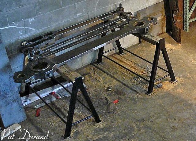

The saw horses were made for us by a local fabricator and are more than up to the task. Here is a better photo taken when we were cleaning and polishing the rods about eight years ago.

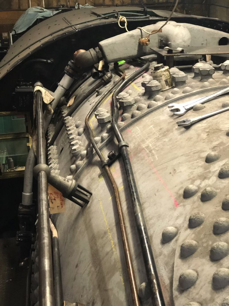

Trial fitting the hand rails and new piping gives the crew a sense of accomplishment!

Great to see another update on this locomotive. You guys are doing a terrific job!
I like the angle of that picture that you posted, as you can really see how everything appears to have been designed for limited vertical clearances. Neat to see.

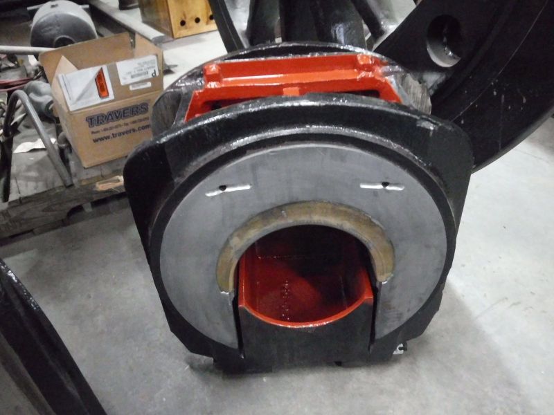

The latest status report is posted at http://www.557.alaskarails.org/restore/ ... index.html.
The driver journal boxes have been returned following their rebuild by Steam Services of America. Final clean up and painting was done in-house. The drivers will be reinstalled this spring. Transportation on the leg between Anchorage and Fife, Washington, and return was courtesy of Lynden Transport, a major supporter of 557.
