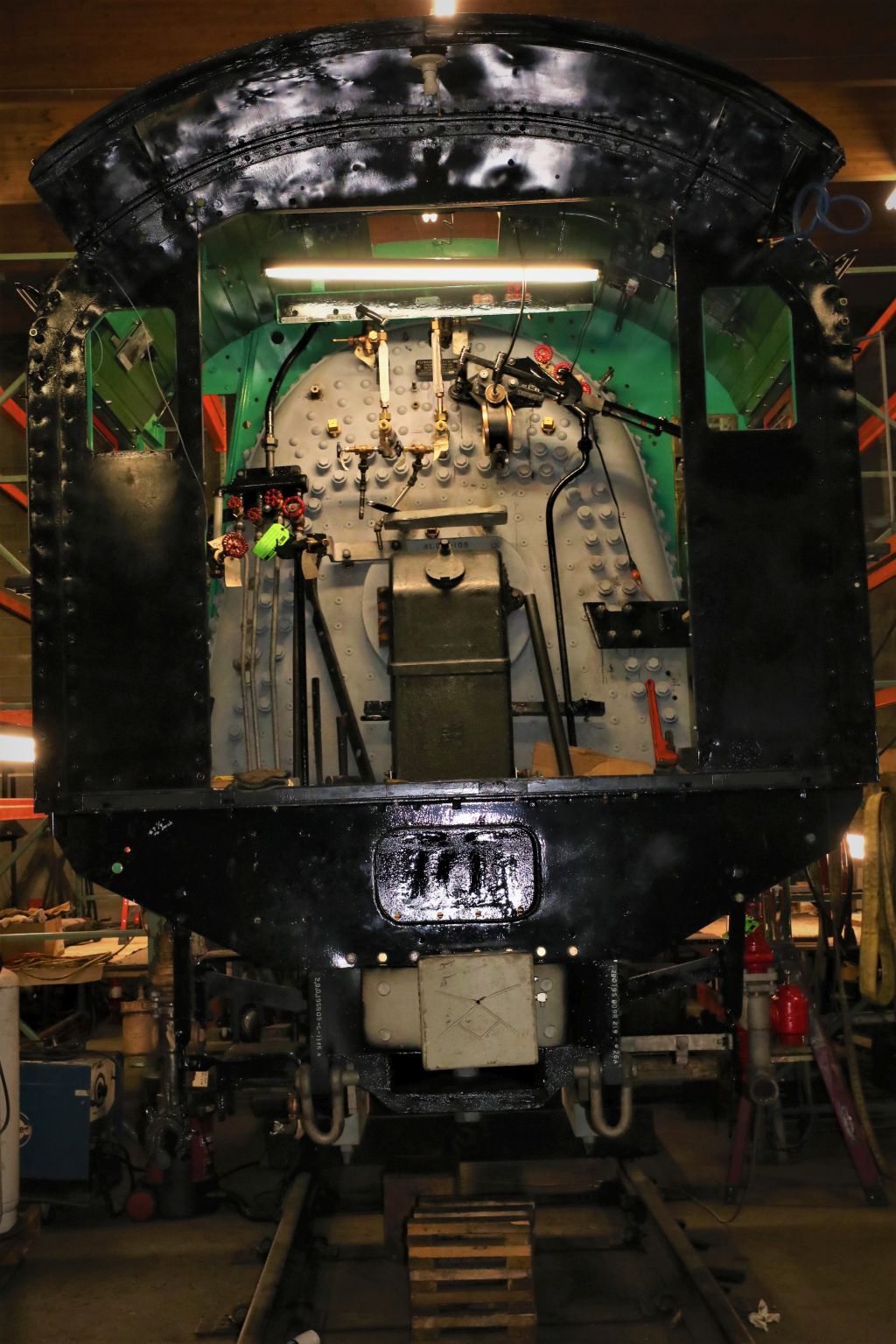

Oh. And we set the cab in place today!

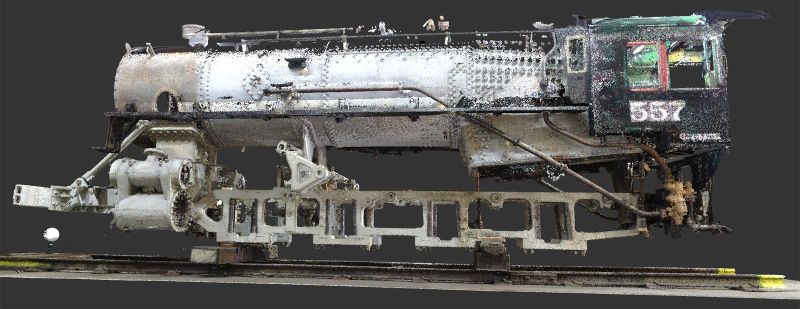

This month saw a visit from an engineering firm who donated their services to do an accurate survey of the locomotive's frame and other components in lieu of the time honored methods of manually tramming the locomotive. All of the points of interest to us will be mapped to within a few thousandths of an inch. More than 40 scans from numerous locations were used to provide an accurate location of numerous points on the locomotive. The image was one produced as part of the survey.

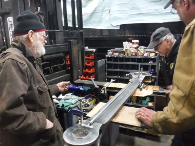

Verifying that rod lengths are to the drawings.

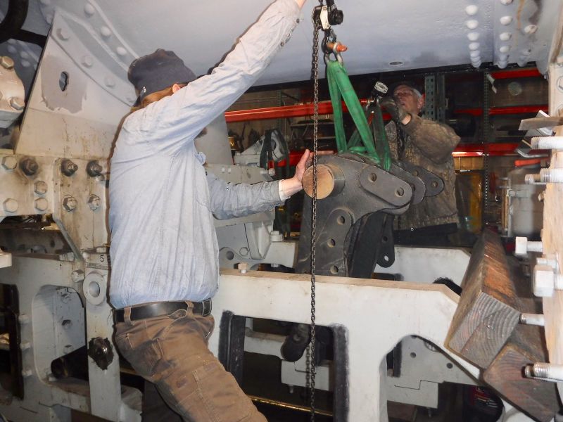

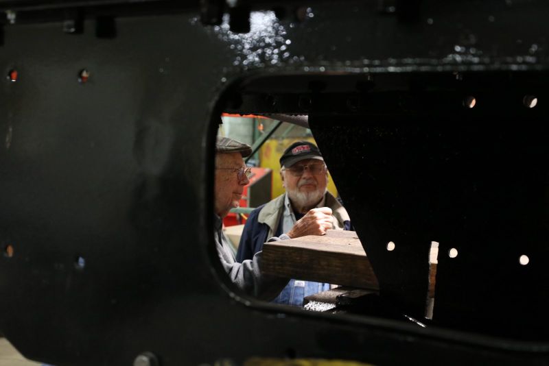

It's a good feeling to see the rebuilt and replacement parts coming off of the shelf and out of the storage containers, such as these bell cranks for the brake rigging, and being mounted back on the locomotive.

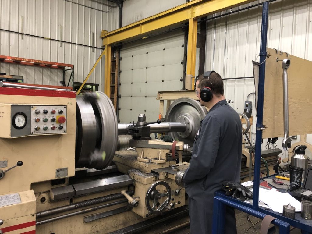

The 33 inch diameter lead truck wheels and axle are being trued up and profiled at Roteq Alaska, in Wasilla about a half mile from the engine house. Their specialty is rebuilding rotating equipment such as large pumps and that makes them well equipped and capable of overhauling our wheel set.

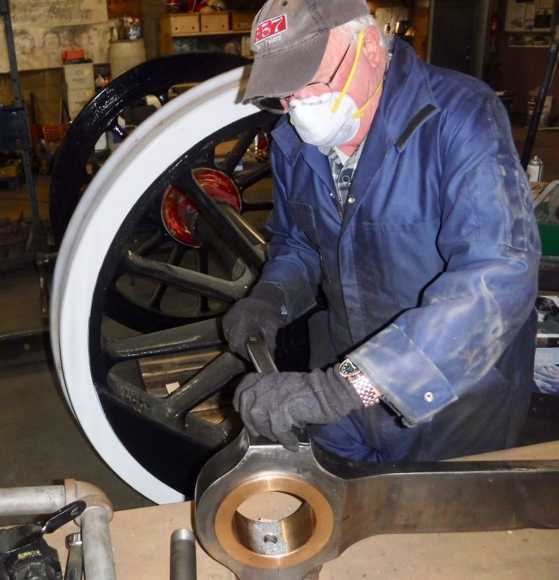

Activities have slowed appreciably, but they haven't stopped. We have been able to continue some single person jobs where we can ensure ample separation. Several of our volunteers have been occupied by independently working on various tasks in fabricating and fitting a full new set of rod bearings and preparing the rods for installation.

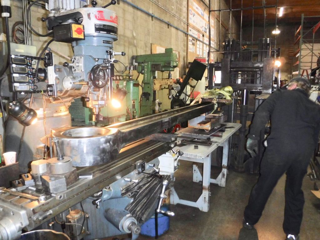

Making do with the machine tools we have. Setting the work piece up on our Bridgeport clone mill to true the bore on the big end of a 127" long main rod.

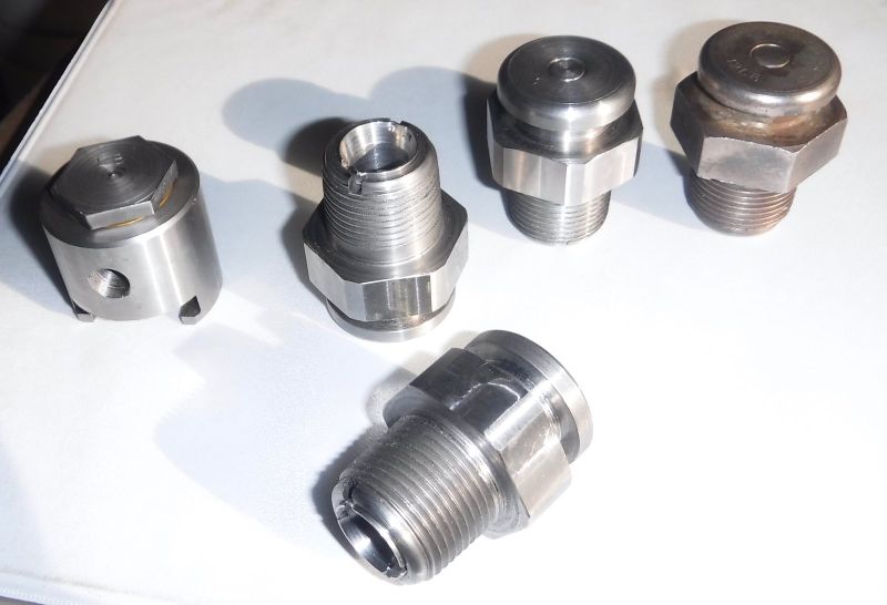

After an unsatisfying search for replacements for three missing Alemite button style grease fittings, volunteer machinist LaVerne B. looked at them and said, "I can make that." So he reverse engineered one from the locomotive and created three new fittings and a matching grease gun adapter, each proudly stamped "LB."
