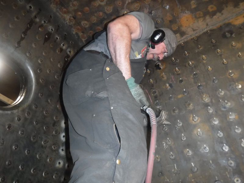

Posts: 136
Should he be wearing some hearing protection?
Edit: Actually I think he's wearing some; those little ear plugs. Sorry about that.

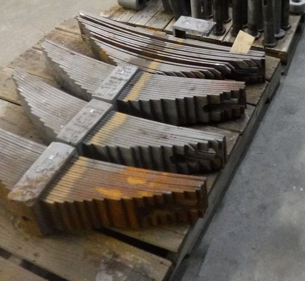

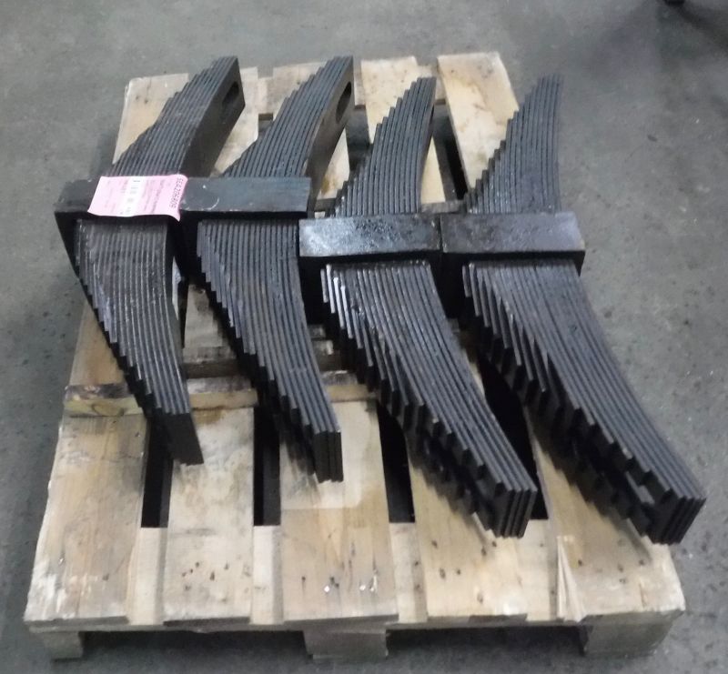

After spending countless hours over the last few years working towards the overhaul of the worn out suspension on 557, we just received four new leaf spring packs, the last of the major parts needed to return the suspension to factory specs.
The locomotive has the suspension divided into two independent sections. The front has four leaf spring packs and two sets of nested coil springs. The front portion of the suspension is equalized with the lead truck, which also has four sets of nested coil springs. As received, one of the coil springs in the front portion of the main suspension was broken and the right front journal was supported solid to the frame with an oak block. We inspected the four front leaf springs and found no broken leaves and the measured capacity of all four was fairly close. New custom coil springs were obtained and many new bushings and pins were manufactured to returned the components of the front portion to match the factory drawings.
The rear portion of the suspension received the same overhaul of the bushings and pins, but the rear leaf springs presented a problem. Only one of the four spring packs was usable. As can be seen in the photo, the others appear to have been cobbled together from parts from other locomotives which were adapted to fit 557. All three had broken or cracked leaves. When comparing the four spring packs, the Sesame Street song "One of these things is not like the others" came to mind.
We contacted a half dozen spring manufactures in the U.S. and Canada (including those suggested by others in previous RYPN posts). All we contacted either weren't interested or couldn't obtain the 7/16" thick material called for in the drawings. We then contacted Peter Best in the U.K. whose USATC #2253 is a sister to ARR 557 and is within weeks of returning to operation after an overhaul. He recommended Owen Springs in the U.K., who had overhauled/manufactured all of the leaf springs for 2253. After a several month wait for their turn in the manufacturing queue and sea voyages from the U.K. to Germany, Seattle, and then to Anchorage, we got a call last week from the shipper telling us the springs were available for pick up.
More on the saga of of our leaf springs, including what it cost us to ship them from the U.K. to Anchorage, is in the "557 Restoration Company" Facebook page.

I bet those were expensive.
 Post subject: Re: Alaska Railroad 2-8-0 #557 to be returned to service!
PostPosted: Sun Jun 16, 2019 4:03 am
Say, the design on the new springs does appear to be different than the old springs. Can you comment on that?
PostPosted: Sun Jun 16, 2019 6:35 am
Posts: 706
Location: Anchorage, Alaska
There are several possible reasons.
1. It appears that at least a couple of the old springs were built up from spring leaves recycled from other locomotives.
2. Over 2000 of these locomotives were built over about four years. There were many changes made during the course of their construction, including to the springs.
3. For at least some of their production, Baldwin used their own spring design. It was interchangeable with the "standard" ALCO design, but had blunt leaf ends instead of clipped ends.
The new ones were manufactured to an ALCO drawing that we provided.
See our FB post for an approximate cost.

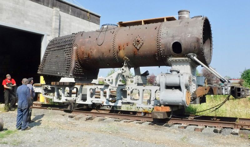

The latest status report can be reached at http://www.557.alaskarails.org/restore/index.html. Among the accomplishments in June, the original tender trucks, now overhauled with new wheels, axles, springs, brake shoes, and refitted with roller bearings, have been put back under the tender, leaving only a few minor details before the tender is fully ready for service.
File comment: On a hot (for Wasilla, Alaska) 84 degree June 29, 557 poked her nose out the door for the first time in quite a while so the boiler shell could be sand blasted and painted.

Another very well done and informative progress report. Really enjoyed the video from Owen Springs. Cobbling spring sets back together using springs from used sets is common repair. Hopefully the new springs correct all the wear and tear. Keep up the great work. Regards, John.

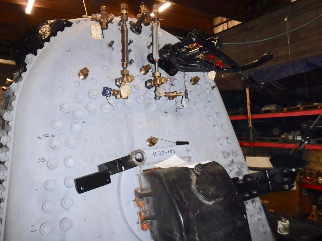

August was a very busy and productive month for the Engine 557 restoration. Test fitting the accessories on the backhead is just one of the accomplishments chronicled in the the most recent status report. It, and previous reports can be reached at http://www.557.alaskarails.org/restore/index.html.
