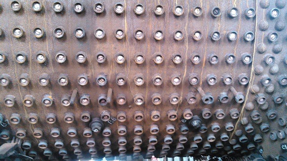

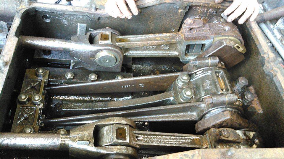

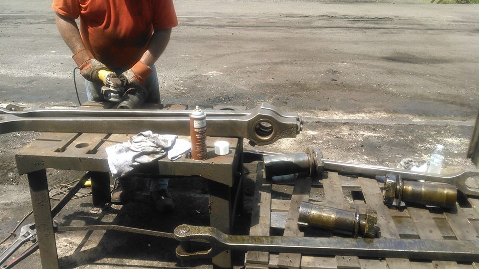

Here are some photos of the work being done by our WMSR Foundation volunteers this month. We also have a full time mechanical crew working in our shops and we hope to have 1309 completed in 2016.
Many photos are also placed on the WMSRF website under galleries and all WMSRF members receive a quarterly newsletter on all project updates. The 2014 newsletters are posted on the bottom of the webpage as well.
