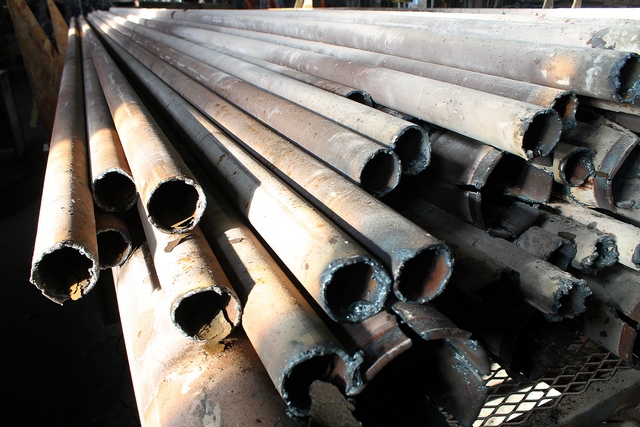

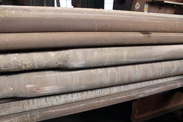

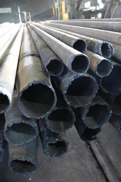

Yes, there has been discussions about using Flue Sections as a Fund Raiser but nothing has been decided that I'm aware of.
There has been discussion as to whether the flues are original to the boiler... as none appear to have been safe-ended.....
Tim W.

Seems quite plausible but did tubes & flues normally run out their maximum legal time or did they sometimes get replaced sooner from hard usage?
Hard use can definitely take its toll on tubes. Under the old rules, tubes were due to be replaced after forty eight months service within a sixty month window (barring extensions being granted). Our #90's tubes would regularly begin to fail through cracking etc. on their rear ends prior to her reaching forty eight months when installed by traditional rolling and beading, and she never made it to the time limit before they had to be replaced. That problem was reduced considerably after we replaced beading with "heat sink" welds between the tubes and tube sheet, allowing better heat transfer between those parts (i.e. keeping the tube ends a little cooler).
As I have mentioned before, when an old PRR boiler maker was asked once about firebox life, his reply was, "We'd get two years out of them, sometimes." Under extreme use, tubes would be getting replaced more often than that.
It's possible that they can be second hand from an engine with longer tubes, no safe ending required.
Good Point Mr. Anderson, I never gave that a thought.
Thank You!
Tim W.

The tubes don't look too used up in the photos on my monitor - a bit of scaling which can be removed, and light surface rust. This opens the question of safe ending and reuse - is it permissible to assume that because we know the tubes were installed by the C&O that they are compliant with their standards even though we have no pedigree for them specifically and recycle them with safe ends or do they need to be scrapped or resold to be cut down for use in an insular situation? Seems a shame for them to go to waste.
dave

765 had its flues from the original restoration removed, cut ended, sent for safe ended (went to a truck exhaust tube site) had new ends welded put on, other flues replaced as needed.
So 765 ran with its most recent original flues in its 1st restoration fixed up.
765 was recently overhauled when retired so it was in good shape. Just the 13 years of sitting some rustyizing took place.
if 1309 has a similar situation you may be in luck for flues, it depends if the newer FRA rules say anything about this but if you can prove the flues are in good shape they may be re-useable to the end of its work life. 765's fixed flues were pressure tested before installation (water)
Just passing some ideas on to use to help.
I agree, those flues in the pics are looking pretty good.

Jeff Lisowski wrote:
If they are, whether relatively recently changed out before the engine was retired or if they are the original set by Baldwin (which, judging from some of the comments above, may be unlikely), then much credit may also be applied to C&O's water treatment program, which was apparently pretty extensive and thorough. Needless to say, it would be good practice to study what was done and the results, all of which would give us today the same advantages it railroads with steam in regular service--more reliability, better operation, and less maintenance expense.
If anything, these factors are even more critical now than in the days of regular operation.
