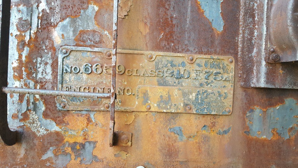

jasonjohnson- Thank you for providing the details of your organization's ingenious adaptive reuse of this tender. Adaptive reuse has become a fundamental and widely accepted concept in the historic preservation of structures and will serve this project and the historic preservation of this tender very well. Unlike the adaptive reuse of buildings, the tender will continue to be used for its original purpose, and so not only its outer form, but also its function will be preserved with only the minor, accepted, and commonplace modification of the interior consistent with adaptive reuse to allow the containment of oil instead of coal. The minor modifications to the outer appearance are easily reversible and consistent with an era-correct representation of the reuse. Finally, the environmental and economic goals of adaptive reuse will be well served. Great work.
 Post subject: Re: Hagerstown M-1b tender?
PostPosted: Thu Oct 20, 2022 9:24 am
Posts: 2565
Kurt Bell cannot locate any PRR records for the tender using a combination or the tender number on the classification plate or the roster number painted on the tender in the photo above.
Wesley
Wesley
What does this mean as far as the heritage of this tender? Is it possible that that the plate is a reproduction and so the number is a non-rostered number? Are there any similar plates preserved that could be compared to this plate to determine authenticity?
I attached the photo of the plate from the T1 website that you had posted the link for earlier. If the plate data is inaccurate, is it possible that this tender came from another road or is it definitely a PRR tender? Are there any other locations on the tender or trucks that would have identifying indicia? If so, could the trucks have been swapped with another tender during the life of the tender? Very interesting. Thanks.

Scranton Yard wrote:
Wesley
Another "Occam's Razor" possibility/probability: The desired "records" simply don't exist any longer, or Mr. Bell does not happen to have access to them.
I don't see any claim that the records in question are considered absolutely complete and definitive and/or was the "Holy Gospel" of such data maintained directly by the PRR's locomotive departments. And I've learned long ago not to even take a railroad's official documentation as irrefutable.
I remember that PRR tender plate being attached to the tender when it showed up at Marshallton on the Wilmington & Western in the 1980s. So there's little chance the plate is a "fake." (That was part of a manic phase when the W&W/HRCV effectively wanted to be the next "Steamtown"--and, in the process, saved CNJ 113, Buffalo Creek & Gauley 14, GM&N 425, NYC 6894, and other steamer for future preservation/operation.). PRR fanatics will save literally anything with "PRR"or their holy keystone emblem on it, from locomotives to handrail stanchions to pencils, so there are plenty of other PRR tender plates to examine out there--just not likely to be that many 210P75 plates. Note that these plates have a blank area for the locomotive number to be stenciled onto as the tender was reassigned.
It remains an absolute fluke that this tender survived AT ALL. The only reason it survived until the mid-1980s in Hagerstown is pure inertia, the failure of the PRR/PC/CR to install a proper fuel tank until late. The W&W grabbed it and moved it to Delaware when there were (and remain) only about two or three locos in existence of any class that ever had such a big tender--and that counts the Hamburg, NY I1, the anomaly of two PRR K4s's getting big tenders late in their careers, and of course 6755 at the RR Museum of Pa. Then, further, the I1 group saved it from the W&W for 4483.

From a member of the PRR Technical & Historical Society, via Kurt Bell.
Once a tender was reassigned to MOW service, it and the record card were transferred from account 51, locomotives and tenders, to the MOW account and in most cases received a new road number. To my knowledge we have no MOW records at Lewistown.
Joe
Additional research help is welcome.
Wesley
