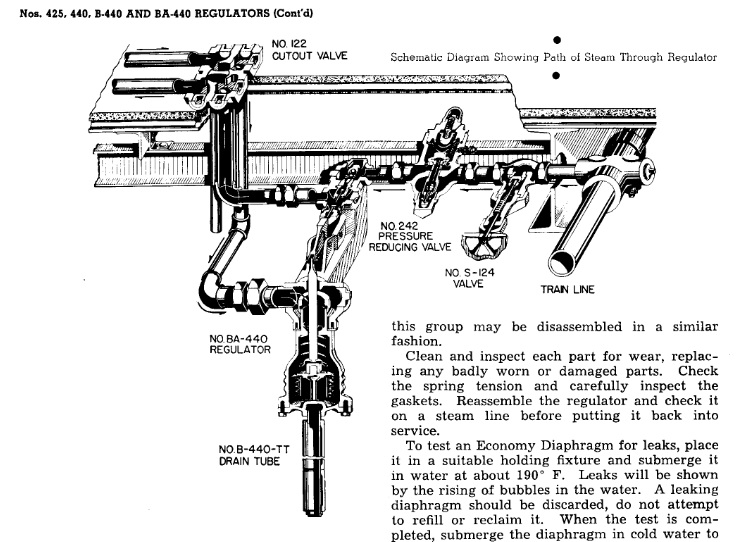

 Post subject: Re: Steam generator or boiler
PostPosted: Mon Dec 16, 2024 9:54 pm
Joined: Thu Aug 29, 2024 10:31 pm
Posts: 14
Hopefully this diagram helps answers some questions.
PostPosted: Tue Dec 17, 2024 5:10 pm
Posts: 412
Thank You for sharing that, Andy! I have an ICS book somewhere in my collection but have been unable as yet to dig it out.
Happy Holidays to All!!!..........mld
