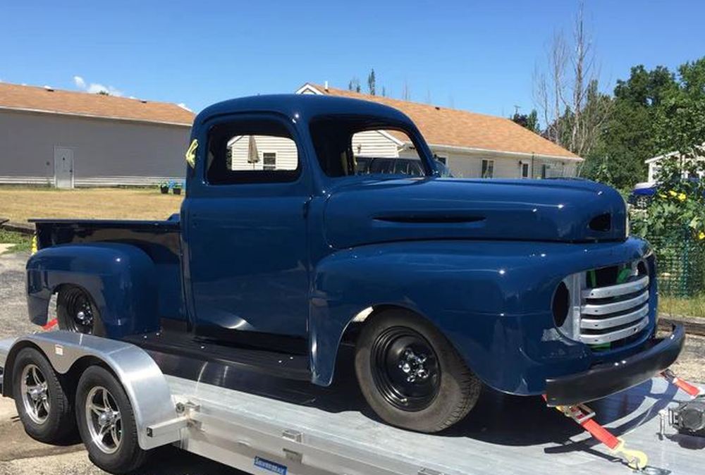

We saw #1 with the Freedom Train on July 4th, 1976 at the New Cumberland Army Depot outside of Harrisburg. I'm thinking that was Ford Sheridan Blue... LOL

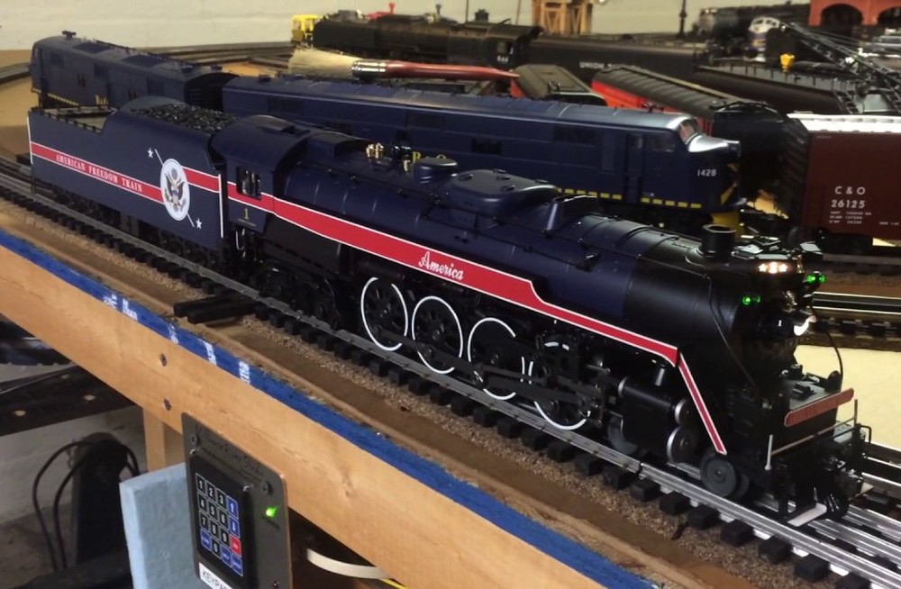

Sheridan Blue is like Bando Blue only darker. The Lionel model appears to be finished in Enchantment Blue which is generally about as dark as Sheridan Blue but a little more reddish or purplish...
