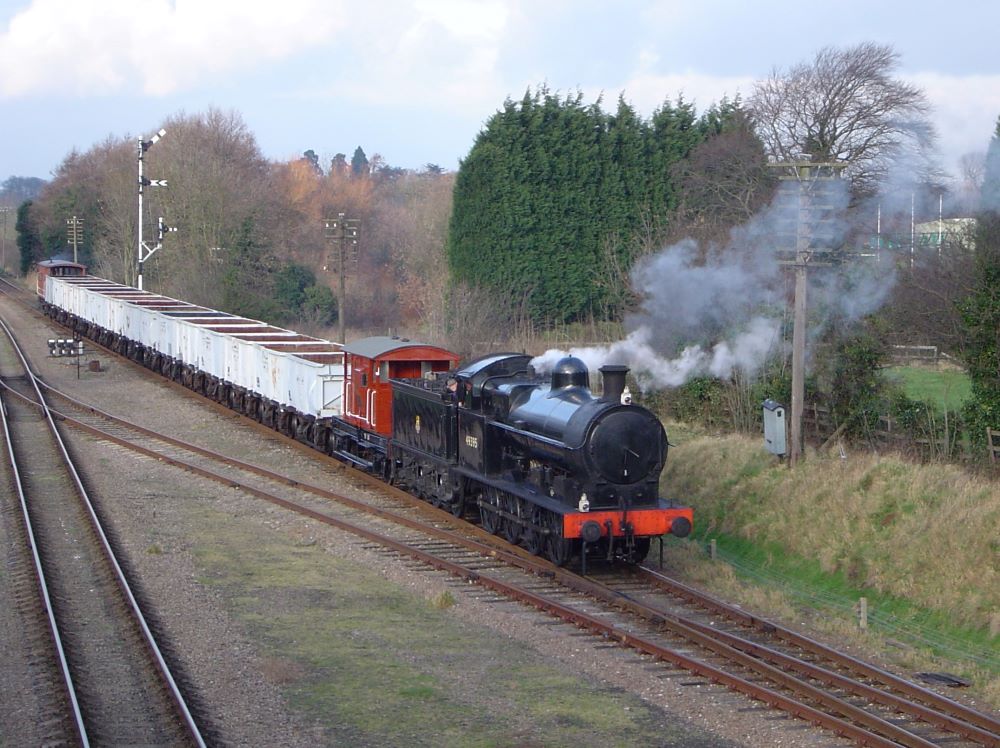

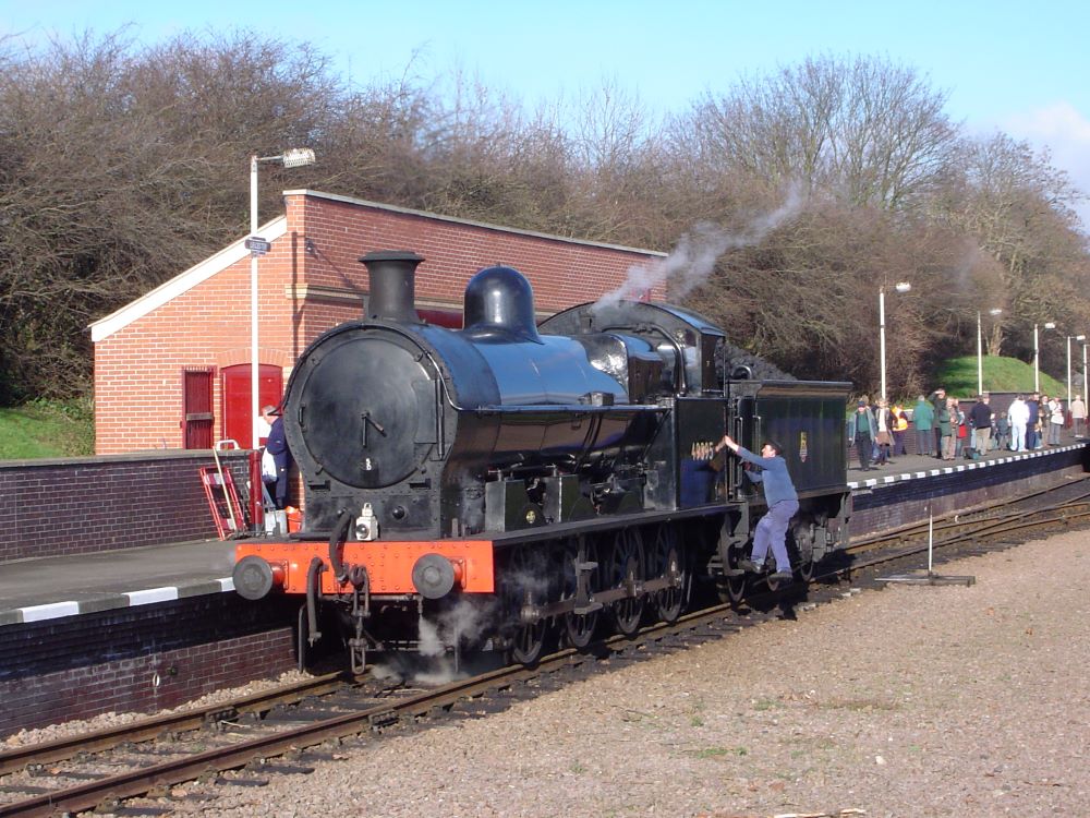

The London & North Western Railway here in the UK had quite a large fleet of 0-8-0 tender locos - which I believe numbered over 500 examples.
One of them is preserved, though not currently steamable, and is seen here on the Great Central Railway back in 2007....
