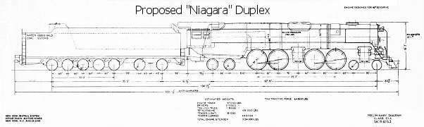

There was that 4-4-6-4 duplex proposal from the Lehigh Valley in 1945 that was pretty much dead on arrival.
Wasn't New York Central also considering a 4-4-4-4 duplex that was more or less a Niagara reconfigured with the eight drivers being driven as two sets of two?
That would be this proposal for the C-1.

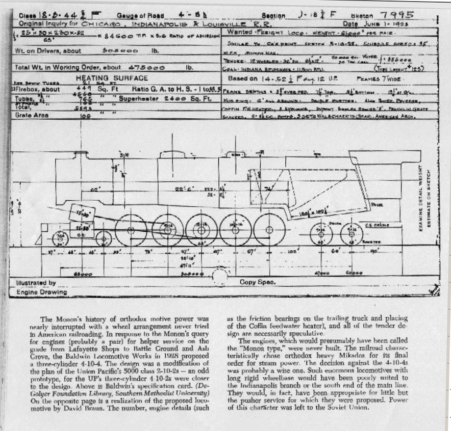

Does any specifications or other information exist on the Monon 4-10-4s? I know that UP's proposed 4-10-4 Lincoln was a 3-cylinder, 73" drivered machine that is believed to have been the next step up from the 7000-series Mountains. But it seems unlikely that the little Monon had use for something as extravagant
Les Beckman sent this to me in 2005. He located it in a book (but didn't give the book details). I "built" the 4-10-4 as best I could; my attempt is here: https://www.railarchive.net/fantasysteam/index.html
