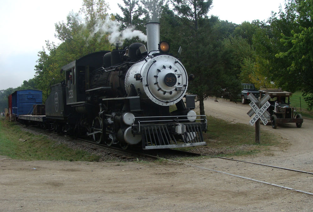

Here is Port Stanley Terminal Rail's approach in Ontario, Canada:
https://www.pstr.on.ca/passenger_cars.htm
Also, here is the Western Minnesota Steam Threshers Reunion in Rollag, Minnesota, from an old thread. It is a closed loop operation.
http://rypn.org/forums/viewtopic.php?f=1&t=38558

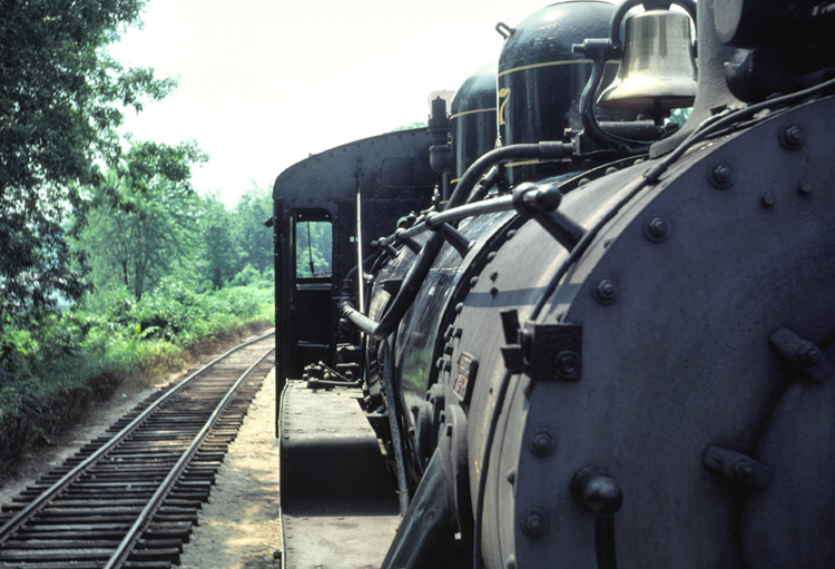

J.David wrote:
Greetings:
Valley Railroad had former L&NE gondola No.728 as it's open car when I first started there in 1986. . . . It was not popular with the general public on the trip back to Essex as it was coupled right behind the locomotive (steam of course!) and after a few chuffs a goodly percentage of the passengers would move to the coaches to escape the cinders.
It was certainly popular with my 15-year old self. You couldn't dislodge me from that gon on the to return Essex. But yes, I would agree now the DL&W trailer is a vast improvement in every respect over a freight car.

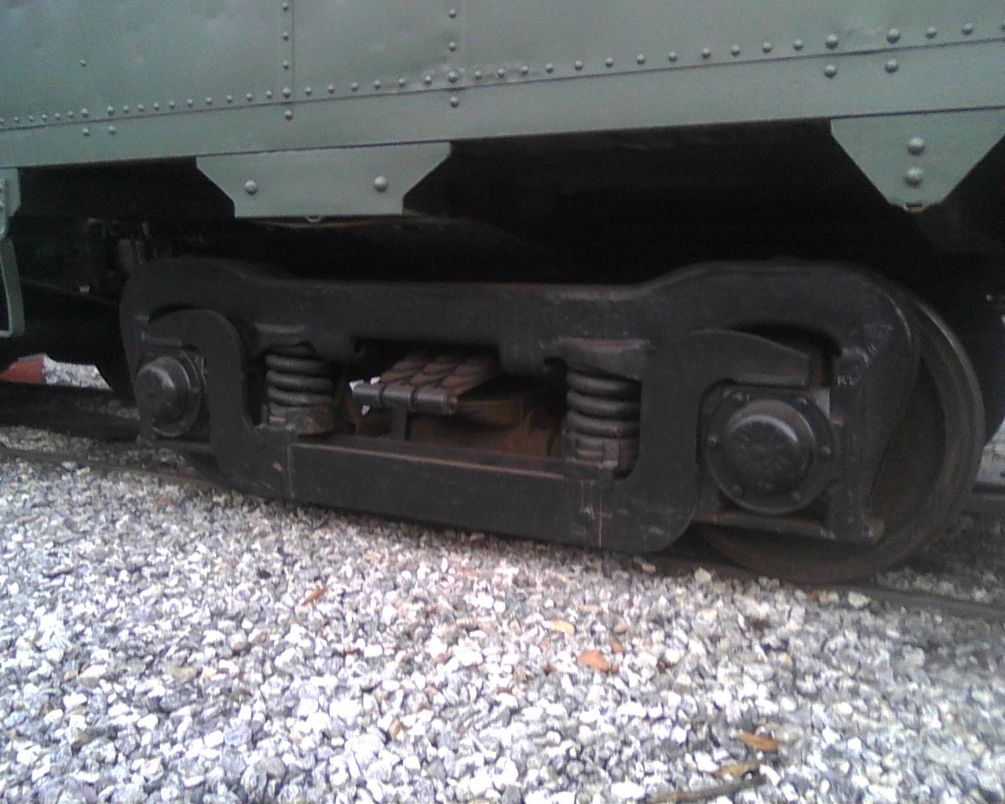

Here is an image of one of the GSC BX trucks under NH 3040, now at RMNE. Looks right, and rides nice!
 Post subject: Re: Boxcar conversion to excursion car?
PostPosted: Mon Nov 02, 2020 10:44 am
"Here is an image of one of the GSC BX trucks under NH 3040, now at RMNE. Looks right, and rides nice!"
Always a good answer to 'what can I put under something to make it ride right'!
Now -- who has pictures of the three-piece trucks New Haven reportedly put on some of the conversions? Those are the ones that might be 'poster children' for what to modify on a modern boxcar converted for 'passengers'...
