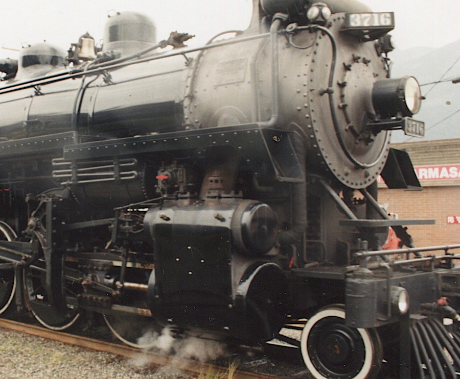

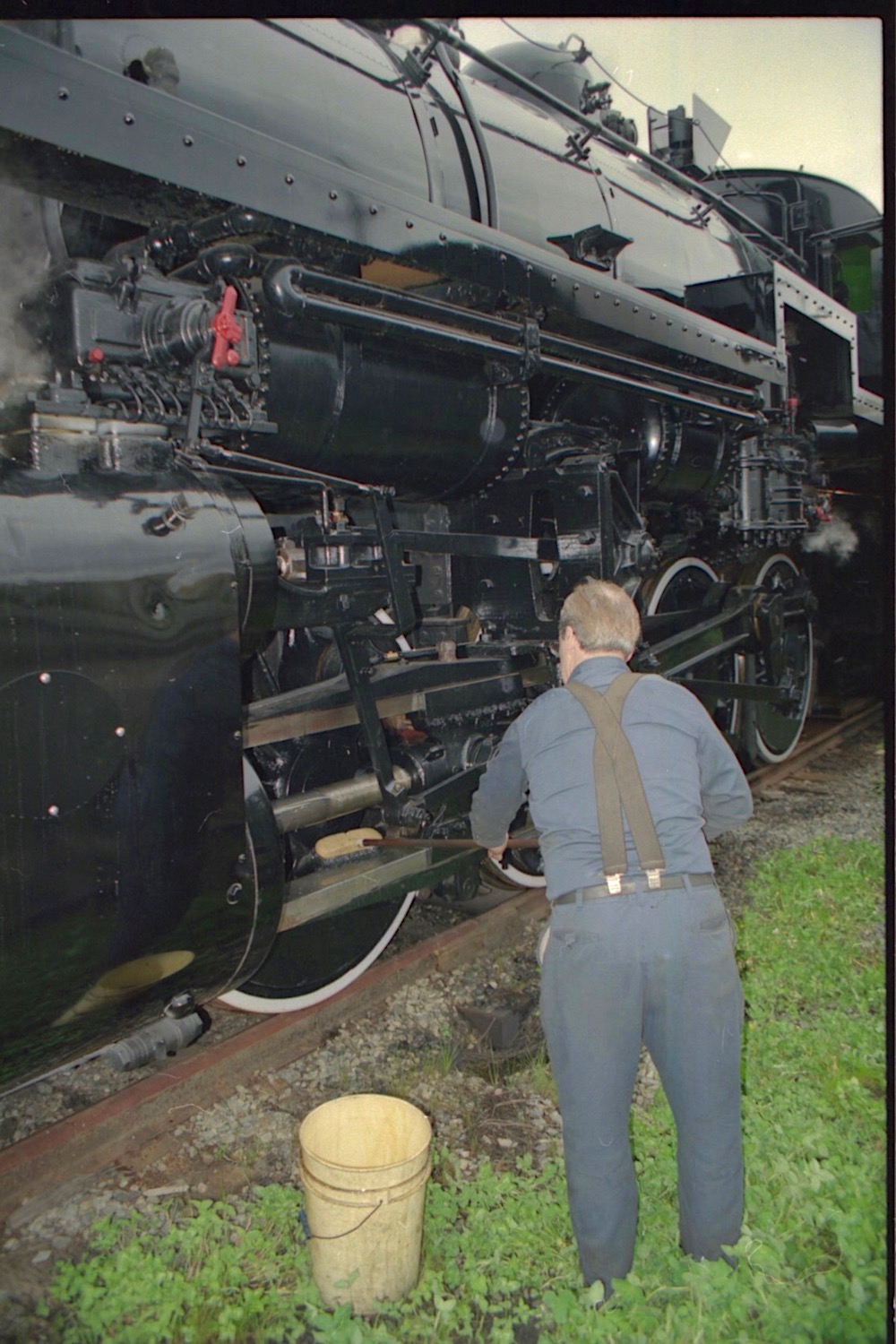

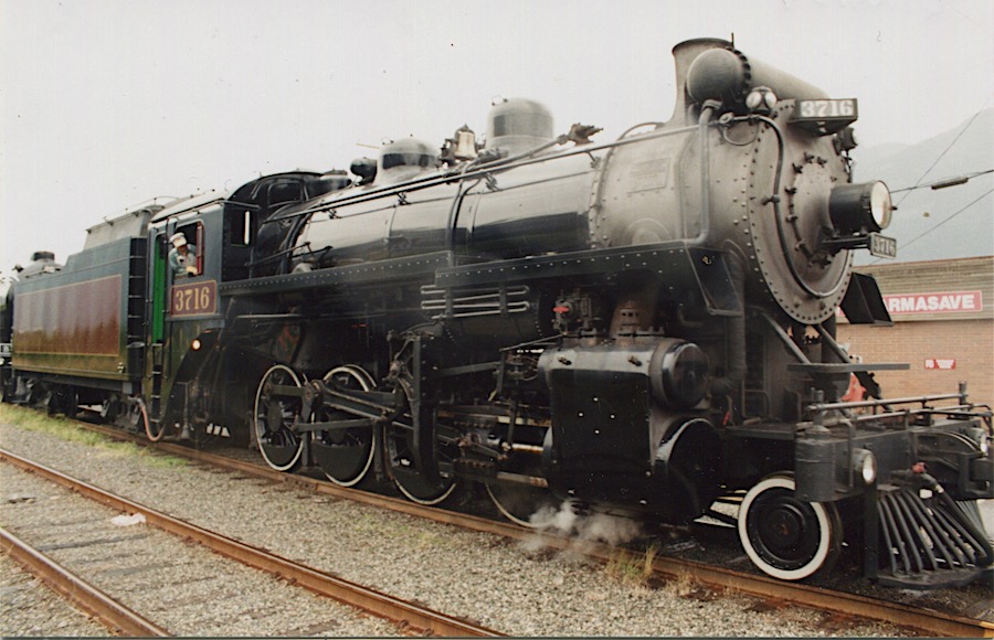

Here's some shots of BCR 3716, showing how it used a rod-drive to the lubricator.
This time, driven off the cross-head.
BC Rail also had problems with the rod system.
In fact the gentleman in the photo once had a breezy ride home, riding on the running boards, after the rod broke during a major fan-trip. He got to reach down, grab the broken rod end, and operate the lubricator by hand, as they headed slowly home.
Either that, or leave hundreds of passengers, stranded in the middle of nowhere.
Never mind blocking the main..
