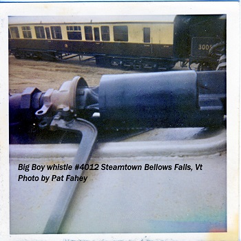

Hi All
I am happy to read and see that the UP finally got the Big Boy under steam. But in reading the above posts, the UP steam crew have not even started assembling the valve gear on the locomotive.
So basically all the locomotive is, is a stationary boiler with a whistle, hmm, I understand it all takes time to reassemble a locomotive. Now the steam crew has to deal with the retiming of the locomotive. Hopefully, they get it right the first time around.
The whistle more than likely has some scale in the bowl of the whistle, and that is why we are not hearing the correct tone.
I hope the break-in runs that they don't run into any problems, remember what happened to N&W 1218 on leaving Birmingham, Alabama for Roanoke when a bushing or bearing ran hot.
The problem was a bushing was running hot on the right crosshead, of the main rod on the forward engine.
The bushing was replaced by the steam crew once it ( the bushing) was brought back to Birmingham shop and a new bushing was made.
Well, time will tell, and hopefully, all runs well for her, good luck, to the Union Pacific and the Steam crew with the locomotive.
Meanwhile here is a photo, of the whistle, on Big Boy # 4012 at the old Steamtown in Vermont.
File comment: Photo by Pat Fahey, UP # 4012 whistle. at the old Steamtown site, in Vermont.
